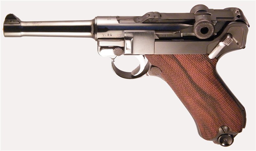

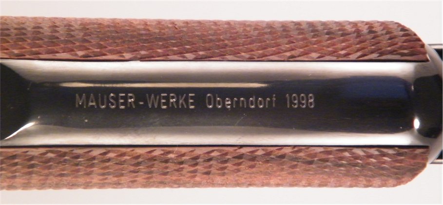

Mauser did sell refurbished pistols in 1997 and 1998, and some limited edition refurbished Gew.98 and K.98 rifles as well. But they were all Mauser products, they didn't refurbish pistols from other suppliers (at least, not openly). But this auction doesn't show Mauser refurbished guns.
The refurbished Mausers came with post-war Mauser Parabellum manuals.
