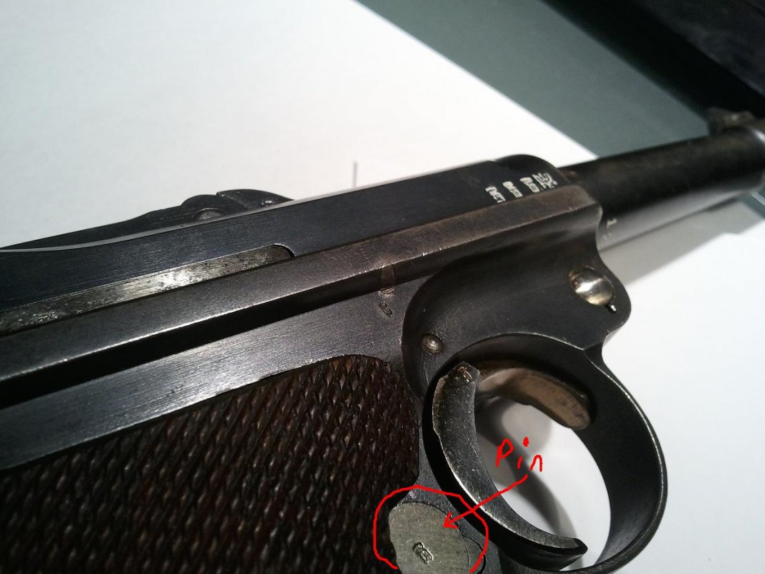

Hi all,
I have looked all over the internet to try to find out the name of a particular part of a Luger...all to naught.
The part in question:
On left-hand-side of the of the pistol is the magazine release.
The magazine release covers a pin that extends through the frame and terminates on the right-hand-side of the pistol.
On Erfurts, on the right-hand-side, this pin has a proof marking and is "strawed".
I have uploaded a pic to help understand what part I am asking about.
Does this pin have a name?
thanks,
Richard

?? do you mean take down lever, not mag release and is the "pin" in question the take down lever spring????

Sorry, policeluger, I did not explain my question well...I have uploaded a pic to help with the explanation.
I probably should not have called this thing a pin, it is really too large for that but hopefully, this thing has a name.
Unread 05-13-2012, 02:16 PM   #4
So (from the parts diagram on our site) you're referring to part number "021"?
It is the other end of the "Magazine Catch". See the photo under description number 29 on this page...
As seen in step 28, it's held in place by the "Magazine Catch Spring".
Unread 05-13-2012, 02:19 PM   #5
policeluger
Location: Ca.
Posts: 2,141
Thanks: 8
Thanked 89 Times in 54 Posts
yep....just other side of mag button....

Thanks guys...now I will sound reasonably knowledgeable when I speak of the "backside of magazine spring catch".
Oh well, it is what it is...
Thanks...I have had no end of trouble trying to explain what I am speaking of in posts and over the phone.
I can now refer them to this post and hopefully, they will understand.

Thanks mrerick, for the link...I will study it and learn from it.
Thanks John, I will follow your steps to learn more...
Now I have one more question...
I have seen ads that advertise their Erfurts as all matching; but, I have noted that the proof stamp supposed to be on this pin is missing.
Does that mean the pin, ( "backside of the magazine catch" ...see pic above ) is a replacement?
Does the claim "all matching" include the stamp that is supposed to be on this pin?
thanks,
Richard

Hi Richard, Erfurt was a state owned armory, and was crawling with inspectors who insisted on enforcing the marking regulations to the letter. All parts on Erfurts, except springs, should have a Crown/Gothic inspection mark, including even grip screws up to 1916. The right side of the magazine release should be marked, if it's not, it isn't an Erfurt part. Regards, Norm
Unread 05-13-2012, 05:55 PM   #12
I'm confused...Is the photo you provided with the red circle around this "pin" your pistol? If so, there is an Erfurt proof right smack in the middle of it. Later Magazine catches were not numbered, but Erfurt pins were proofed.
Unread 05-14-2012, 01:23 PM   #13
siegersallee
siegersallee's Avatar
Join Date: Apr 2012
Location: Atlanta, GA
Posts: 293
Thanks: 112
Thanked 58 Times in 35 Posts
Hi alanint and Norm,
Yes, this photo is of my pistol which I know is a real (all parts and grips marked) Erfurt...except for the mag which is period correct.
My question was about another luger that I have been eyeing.
The seller says that his pistol is an all matching Erfurt; however, I saw that on his pistol this pin did not have the Erfurt stamp.
So now that I know for sure that this pin should be marked, I do not think his pistol is worth what he is asking.
I just wanted to be sure, that's why I was asking this rather involved question.
