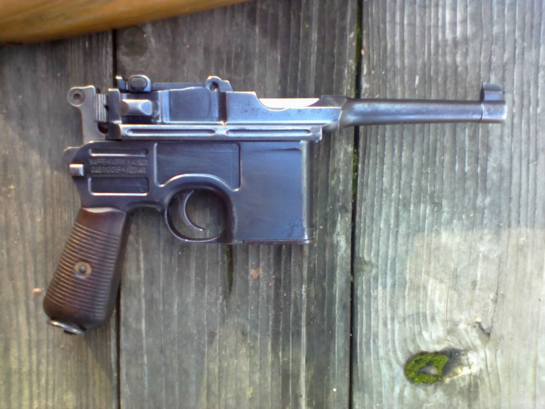

I bought Mauser C96 Broomhandle to keep my Luger company. Today I got to shoot a few rounds of new Fiocchi 88gr. 7.63 ammo through it and I love it!
I do have a question about how the trigger functions and since there has been some C96 discussions here lately was hoping someone familiar with these could help.
The hammer doesn't always drop when the triggger is pulled. You can feel a very distinct "click" but nothing will happen. The next pull everything will work fine. I'm studying the mechanism trying to better understand how it works, and don't see any obviously worn or ill fitting parts. The same "click" can be felt in the trigger even if the hammer isn't cocked and seems to be made between the lock frame and the disconnector as it lifts the sear.
Is such a "click" normal, or do I have parts that aren't fitting well?
The gun is a MM, but all the numbered parts on the lock match the body. The barrel/extension and locking block match each other, but not the rest of the gun.
Any common problems that might keep the hammer from dropping I should look for?
Thanks for any input.

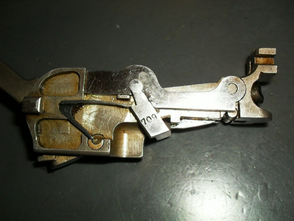

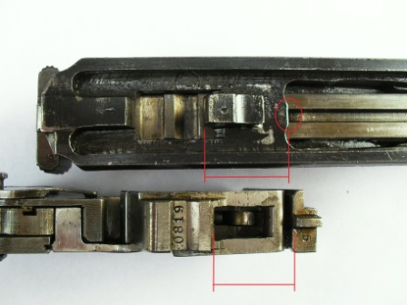

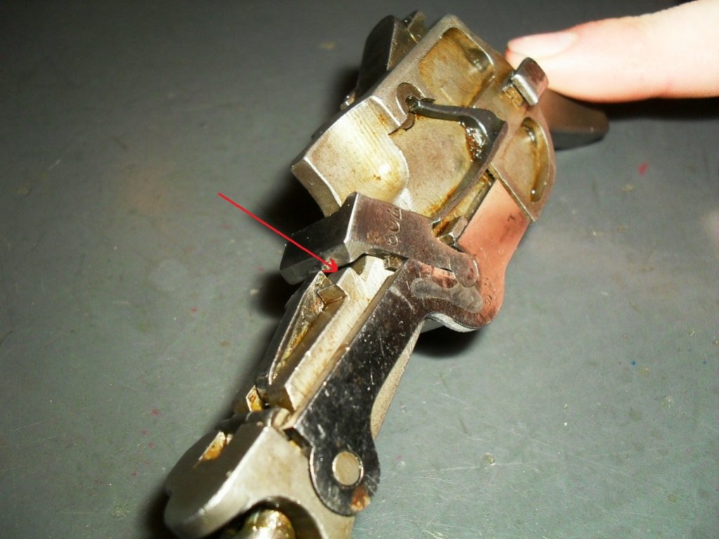

Thanks for the response. Maybe these pictures might help. Just holding the locking block in my hand I can feel a "click" as I lift the disconnector. it rubs where I marked the picture with a red arrow. The number 709 matches the rest of the lock assembly.

The lock frame looks healthy from the picture. But hammer down, pull the trigger, the trigger is not supposed to disconnect on this variation. You may want to save this matching sear arm and install another sear arm on it to see the problem goes away or not, to isolate the problem.

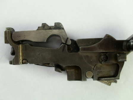

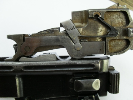

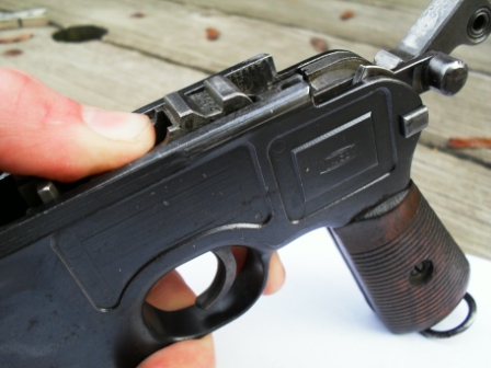

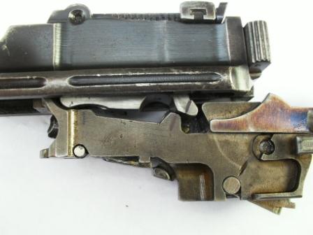

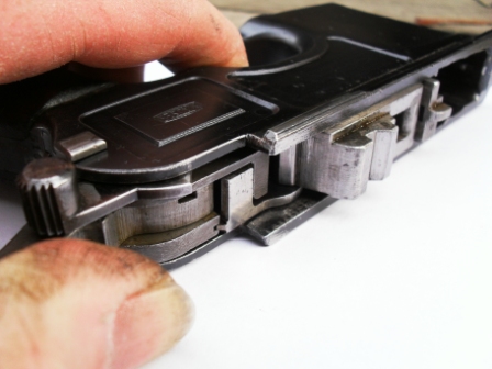

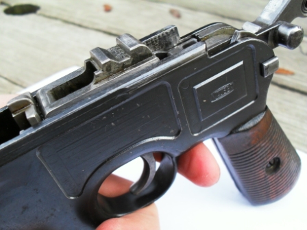

Here are some pictures I hope can illustrate my problem. Any help is greatly appreciated.
If I assemble the Lock Frame and Locking Block into the Body, the Trigger functions like I think it should. As can be seen in the last three pictures, the Trigger will hold the Sear Bar away from the Hammer with the Locking Block in the "ready to fire" position. Moving the Locking Block to the "discharge" position disengages the Disconnector from the Trigger as is should.
When the Lock Frame and Locking Block are assembled onto the Barrel and Extension, the Locking Block pushed the plunger far enough back to move the Disconnector rearward until the trigger barely touches it and just flicks it enough to sometimes release the Hammer. This is the "clicking" noise I hear and feel. I tried to show in the pictures how much the Locking Block moves on the Locking Frame when assembled on the Barrel Extension by drawing a line on the two parts with a felt pen in the second and third picture. Is this excessive?
In the first picture you can see how the Plunger has slightly moved the Disconnector back in the Sear Bar and exposed the little tab that holds it in place.
I've been told a lot of hand fitting went into these pistols, and I'm thinking that my parts just need to be fitted better.
Thanks for any opinions,

Unread 02-22-2012, 07:08 AM   #15
In your original description "The hammer doesn't always drop when the triggger is pulled. You can feel a very distinct 'click' but nothing will happen." -- so firing did not happen, barrel, bolt lock, rocker plunger did NOT move. Nothing pushed sear arm away from the trigger and the trigger disconnected from the sear arm simply by pulling it (I guess that's where the 'click' came from). Trigger and sear arm fitting is needed on this gun, so the trigger won't disconnect by itself before the sear is raised high enough to release the hammer.

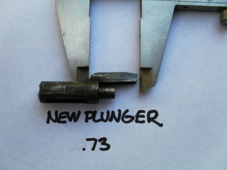

Default Problem Solved

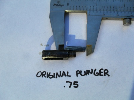

I decided to try a different plunger on my broomhandle, still thinking that it shouldn't be pushing the disconnector back when assembling the pistol to the barrell and extension. I orded one from KB International and got it today. Again I have to give this company an A+. I was very pleased to see that the new plunger was actually shorter than my original as shown in the pictures. Now when I assemble the pistol the trigger makes solid contact with the disconnector and lifts the sear bar without disconnecting unless the barrell and extension is pushed back into a discharge position.

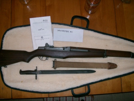

20 years ago I purchased my very first gun. A beautiful Winchester M1 Garand through the CMP. I had absolutely no interest in guns whatsover but my new father-in-law insisted I buy one with him. I paid about $180 dollars. I didn't have the gun very long when I traded it and some cash for a rusty old Ford. When my new wife found out she was VERY mad and I had to go beg the guy to sell it back to me. Her dad taught her to NEVER sell guns. I had told they guy it was probably worth about $500 bucks, so he sold it back to me for $700. (that part I didn't tell my wife). Fortunately for me today my wife was smarter than I was.
