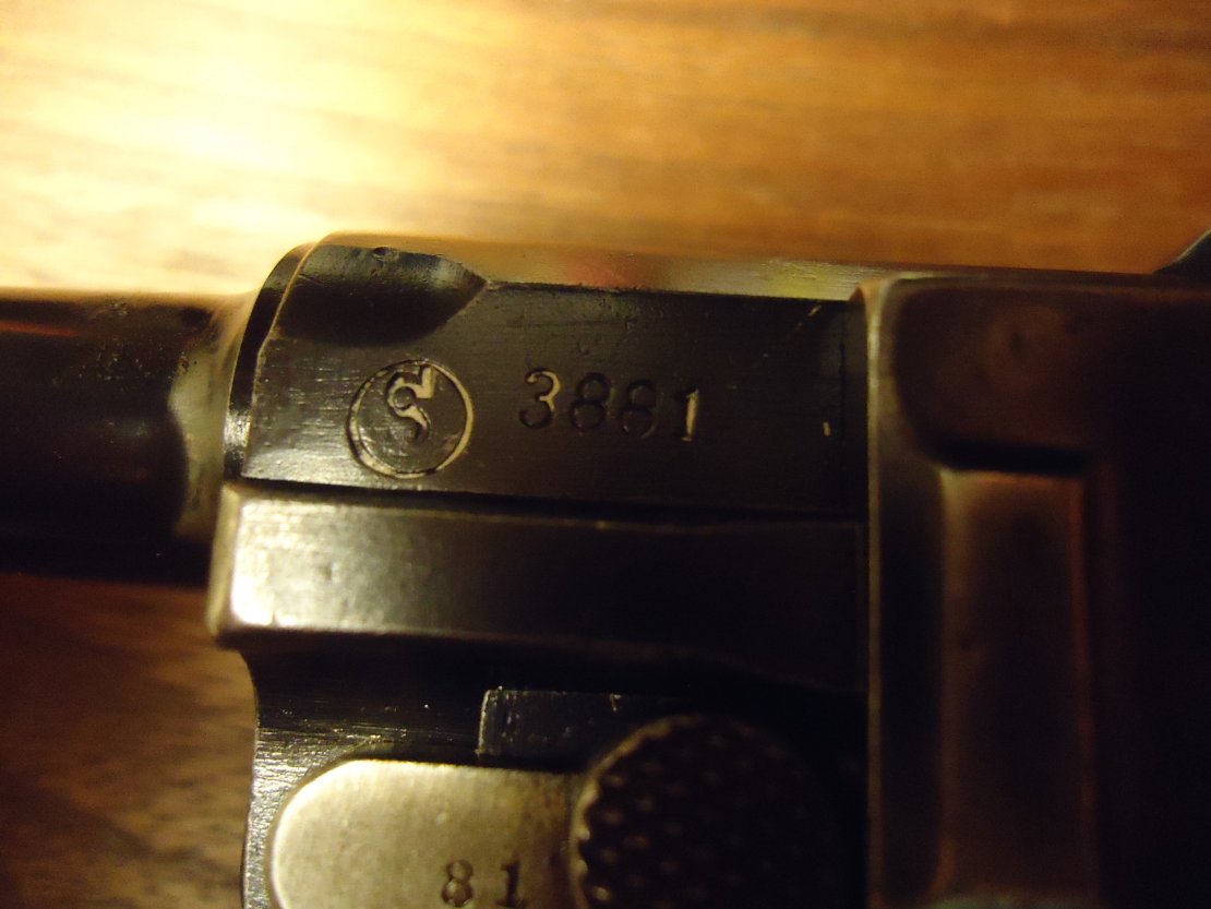

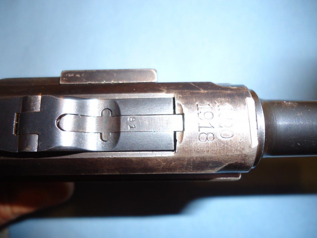

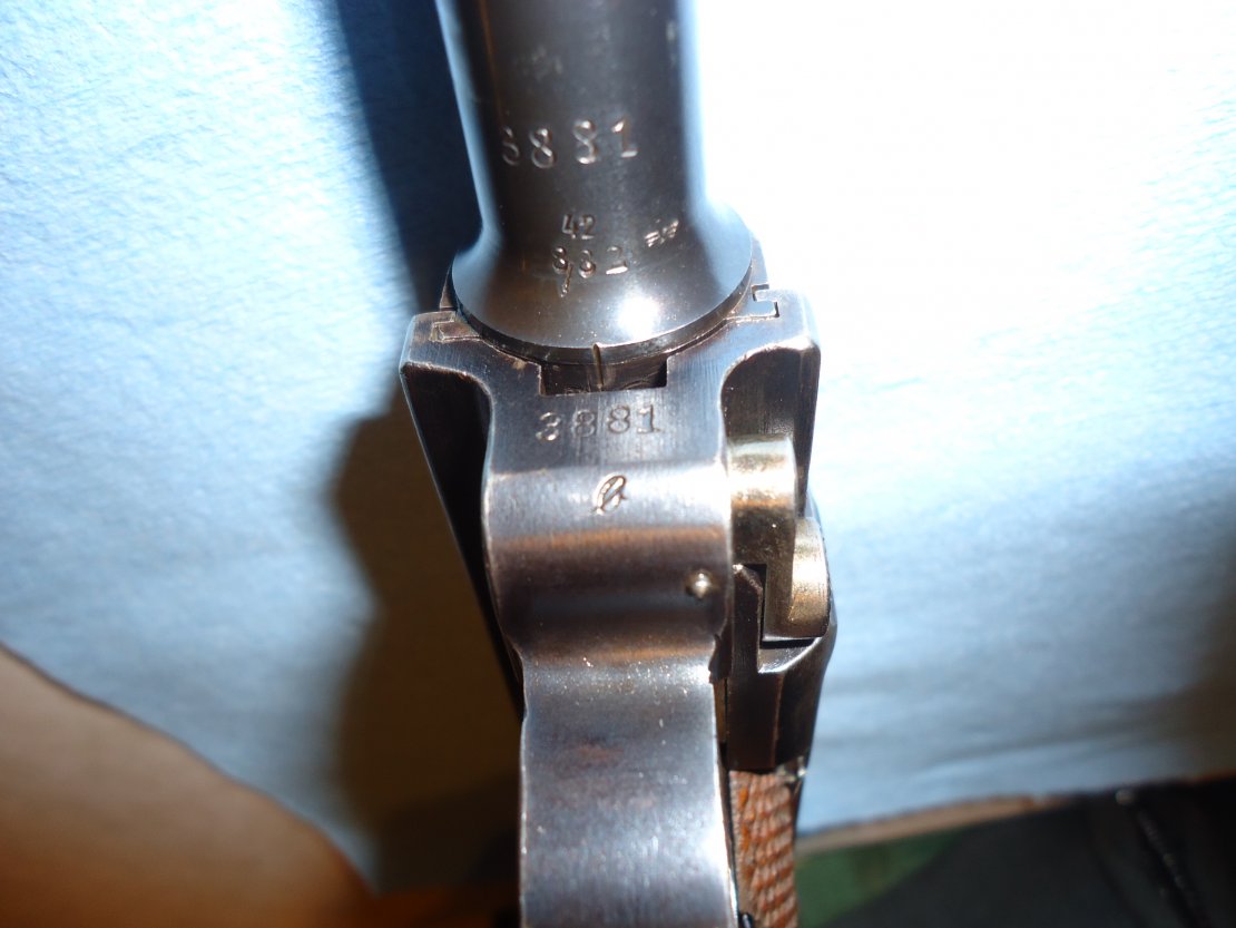

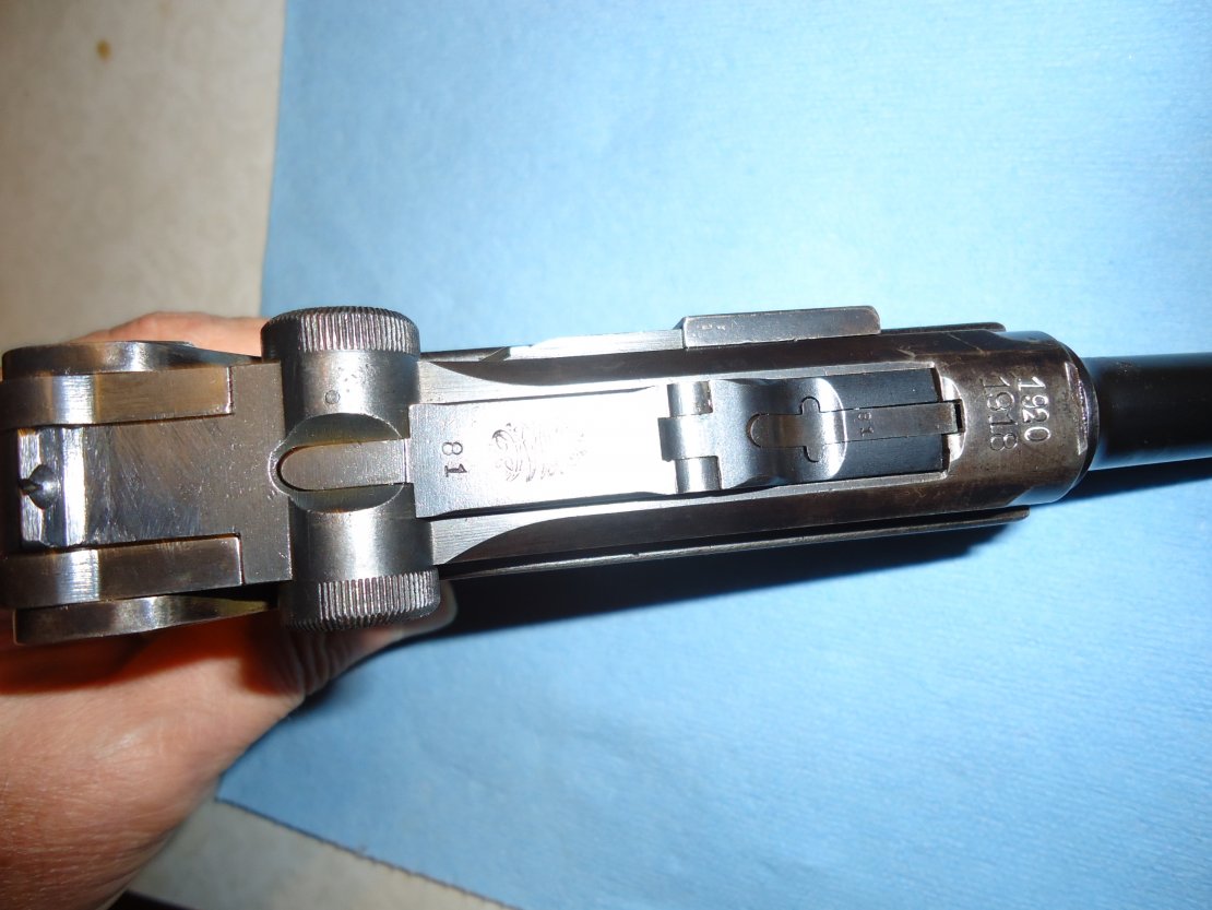

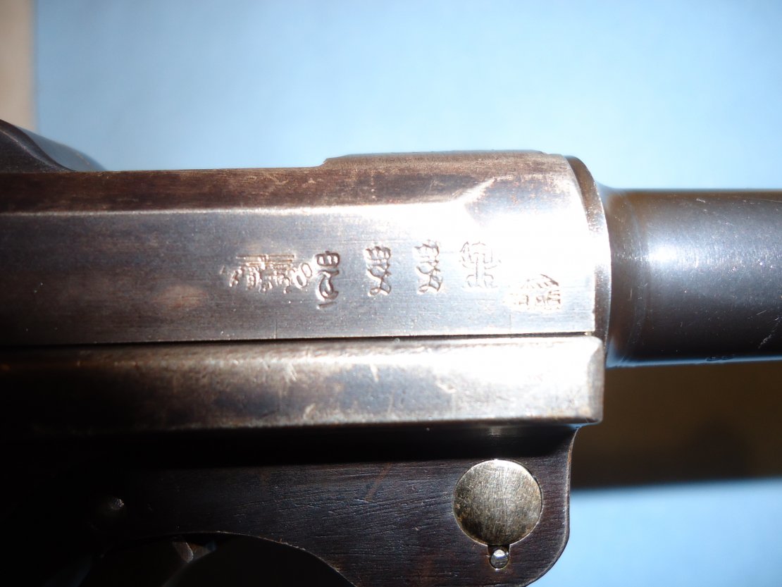

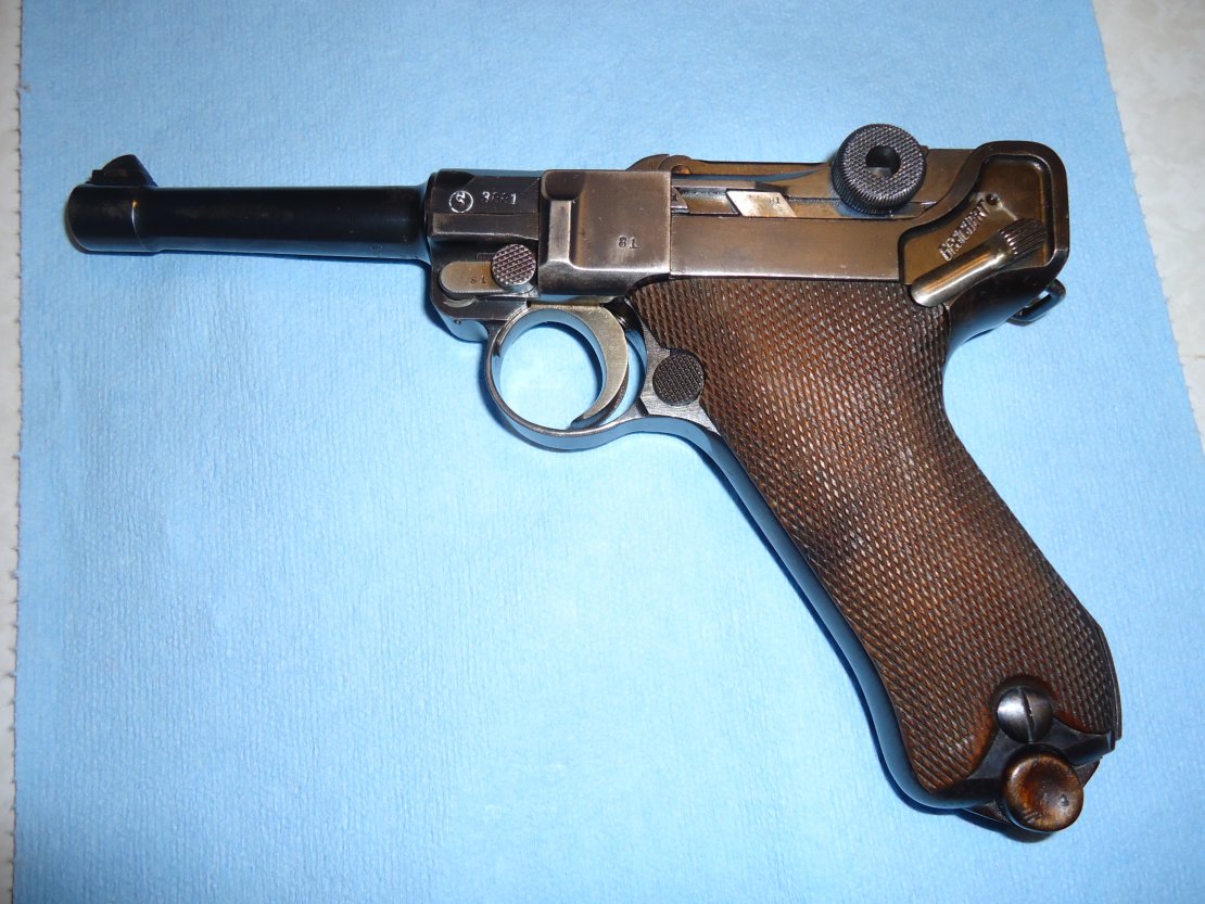

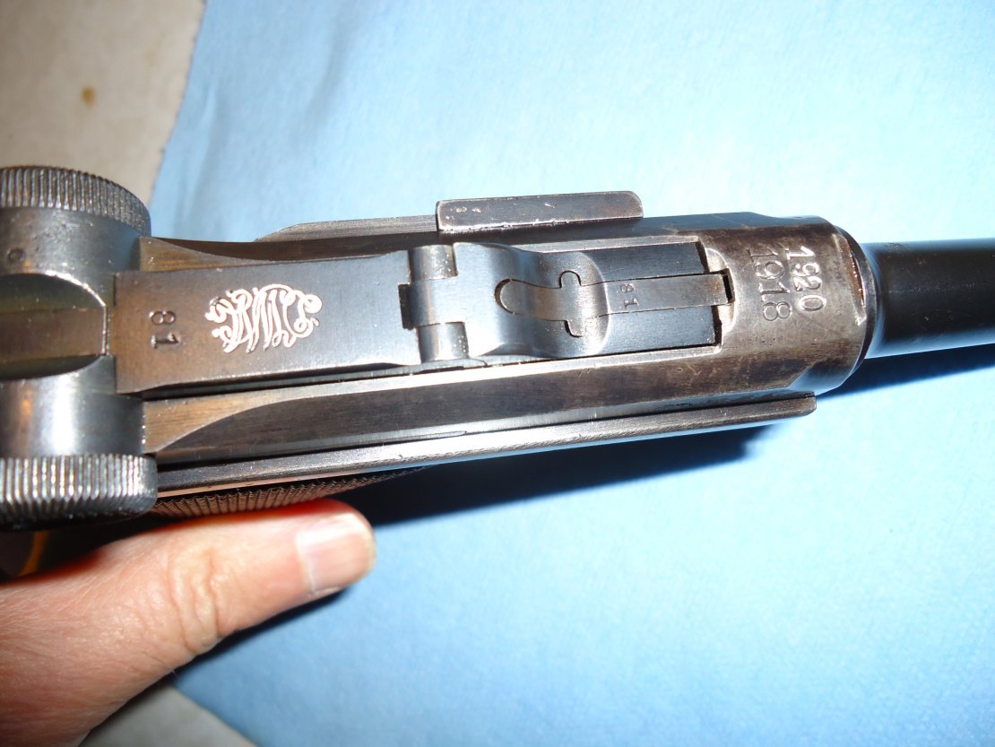

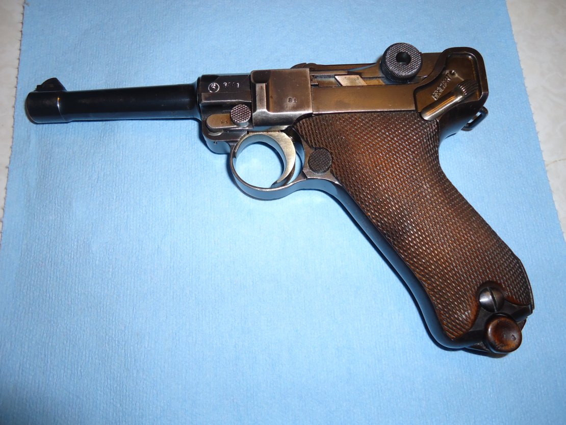

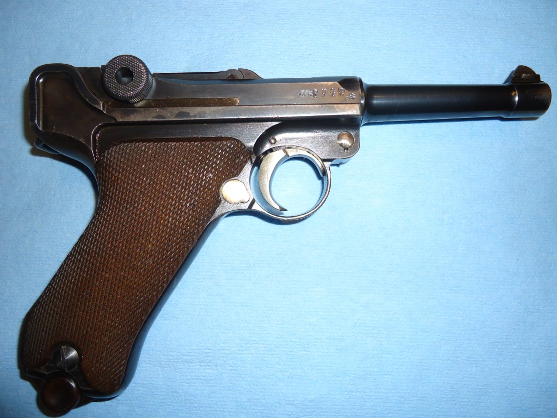

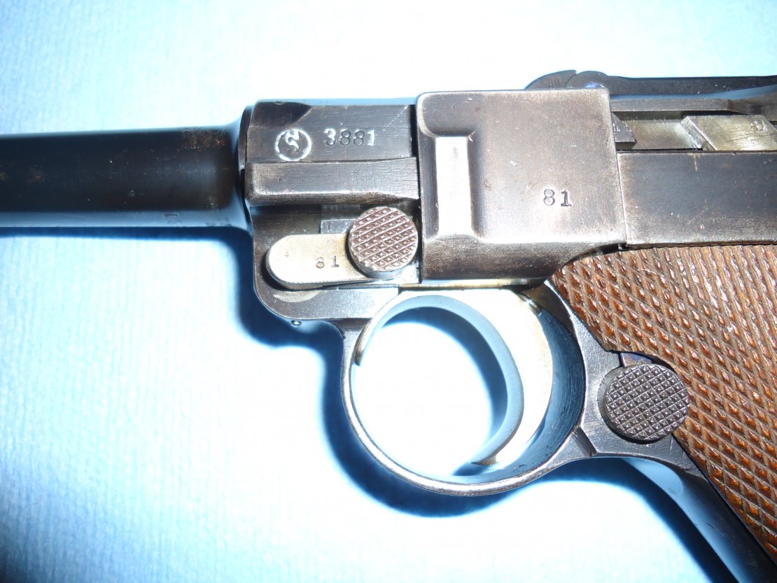

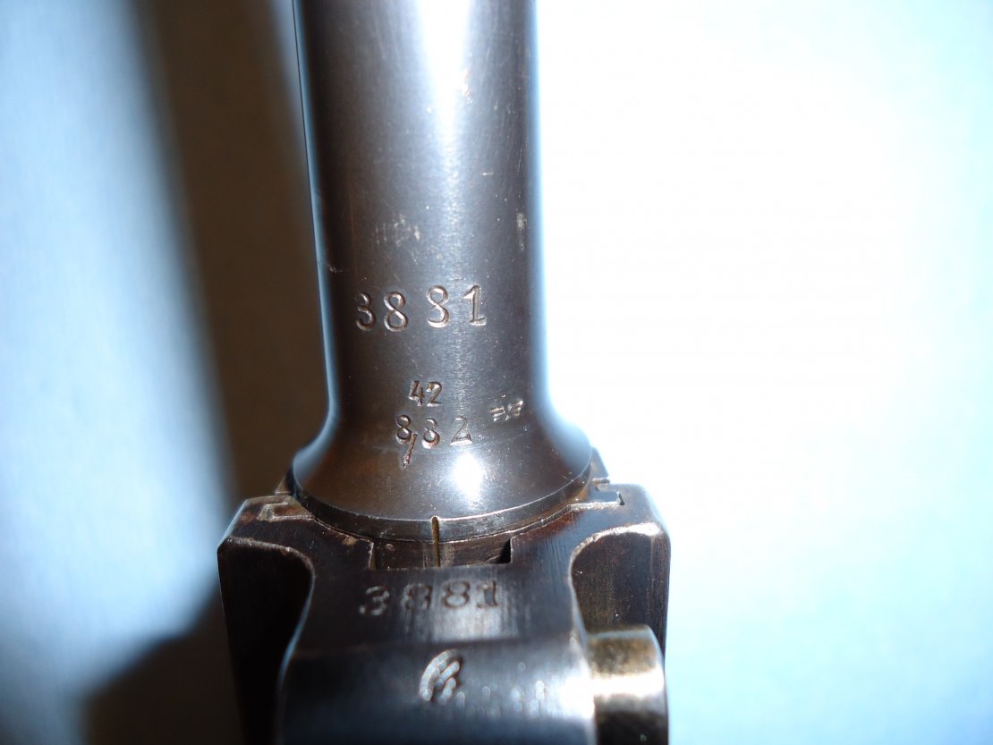

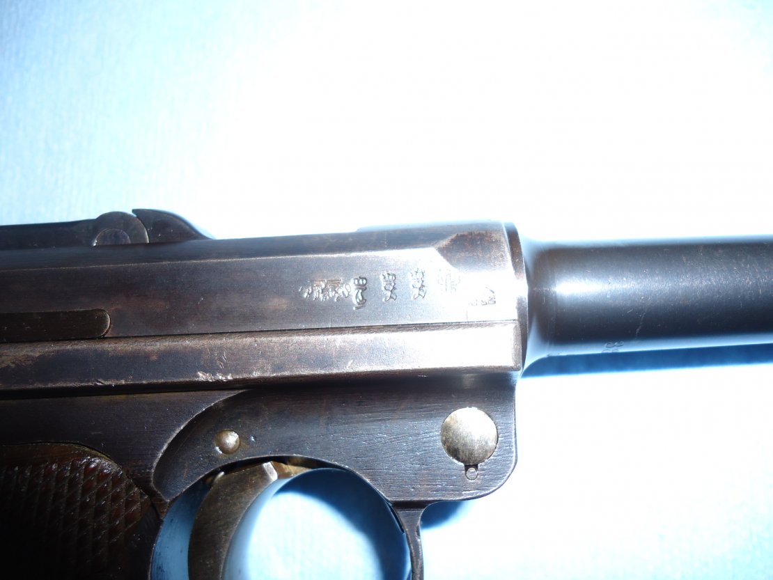

i hope i have this in the right thread, if not let me know , trying to identify another luger i acquied, it is a double dated 1918 1920 chamber stamp,DWM,9mm, pistol is in very good condition and shoots well, very nice bore and everything matchs, serial number 3881 not sure of the alpha letter, maybe you can make it out in the picture, left side infront of the serial number circle S,right side six proof marks, barrel has serial number with 42 over 882, i am sure it has been replaced, any help identfying it would be helpfull

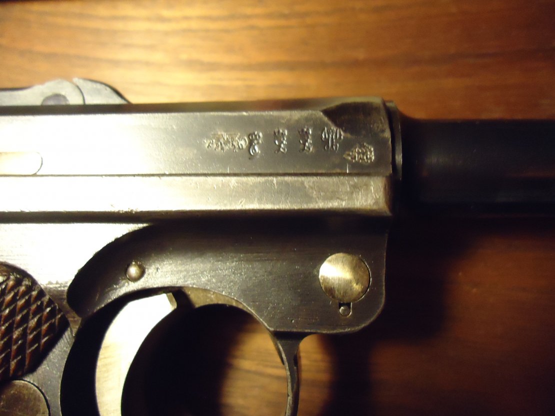

Hi Dan,
You've got an interesting Luger. It was made during WW-I, was "1920" property marked by the Weimar government and then was reworked sometime after 1938, probably at Mauser.
There is speculation, but no proof, that the circle S stamp was added during rework for police use at Simson and Company, Suhl during the Weimar period.
When you use flash, it causes the metal to reflect the light and washes out the photo details. I can't read the proof marks. If you could re-photograph the pistol in indirect (shaded outdoor) light, they will be more helpful.
The "42" on the barrel is a concealment code that was issued to Mauser replacing S/42 in 1938.
The Crown over letter proofs are from the pistol's original manufacture, ending with the Imperial eagle. The Waffenamt inspection mark to their left was applied during the arsenal rework. I can't make out what is to the right of the eagle.
8,82 is the barrel gauge, measured in millimeters between the lands (and representing a 9mm barrel).
I believe that your serial number is 3881b.
As an arsenal reworked Luger representing the first three of the major German eras in the 20th century, it's a rather interesting pistol from a history standpoint. It looks to be in very good condition, and would be collectable in my opinion.

thanks marc, i hope these pictures turn out better, it shoots well and fuctions just as good. upon field stripping all parts are matching and numberd correctly, any idea on pricing for it, again thanks

Just to clear up Marc's typo, the gun was made in WW1, not 2.
The notch at the front of the receiver above the dates is a good indication that your gun was once an artillery model.

Dan,
Very interesting Luger. The circle-S was stamped by and for reasons unknown, on pistols sometime between 1918-1922. There is no known Simson connection. The straight-wing eagle to the left of the proof marks may be the mark of a Heers Zeugamt where the pistol was repaired or rebuilt. It is uncharacterisic that there is no police sear safety on this Luger.
Is there a number stamped on the rear of the frame, or on the front grip strap?
I would appreciae it if you would email me about this pistol dwightg@clear.net

what does concealment code mean, as in the barrel has 42 stamped on it? thanks
Unread 02-08-2012, 03:20 PM   #12
As the Germans were prohibited from producing more than a certain number of firearms for the military after their defeat in WW1, they turned to codes to identify local manufacturers in an attempt to conceal where the guns were being made, a practice which would not have fooled anybody who really cared for long.
Some of the typical codes seen;
BYF, S/42, 42 = Mauser
AC = Walther
CYQ = Spreewerk
AYF = Steyer
FXO = Haenel
There are perhaps over 100 more and tables exist to identify most of them.
