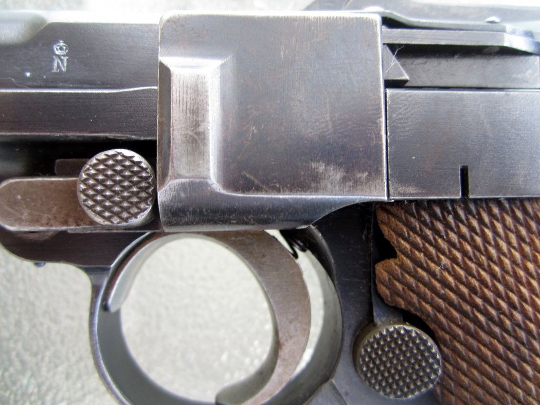

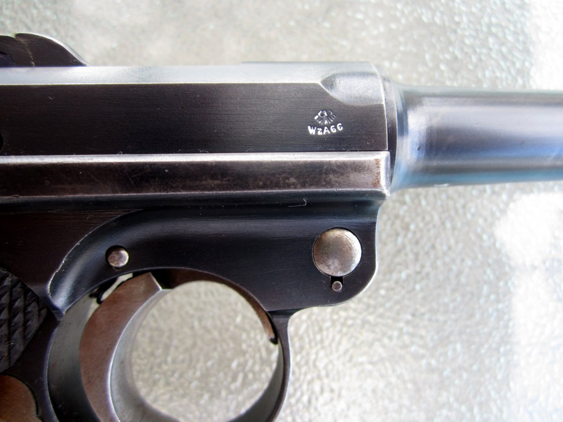

Default Help identifying luger p08 commercial

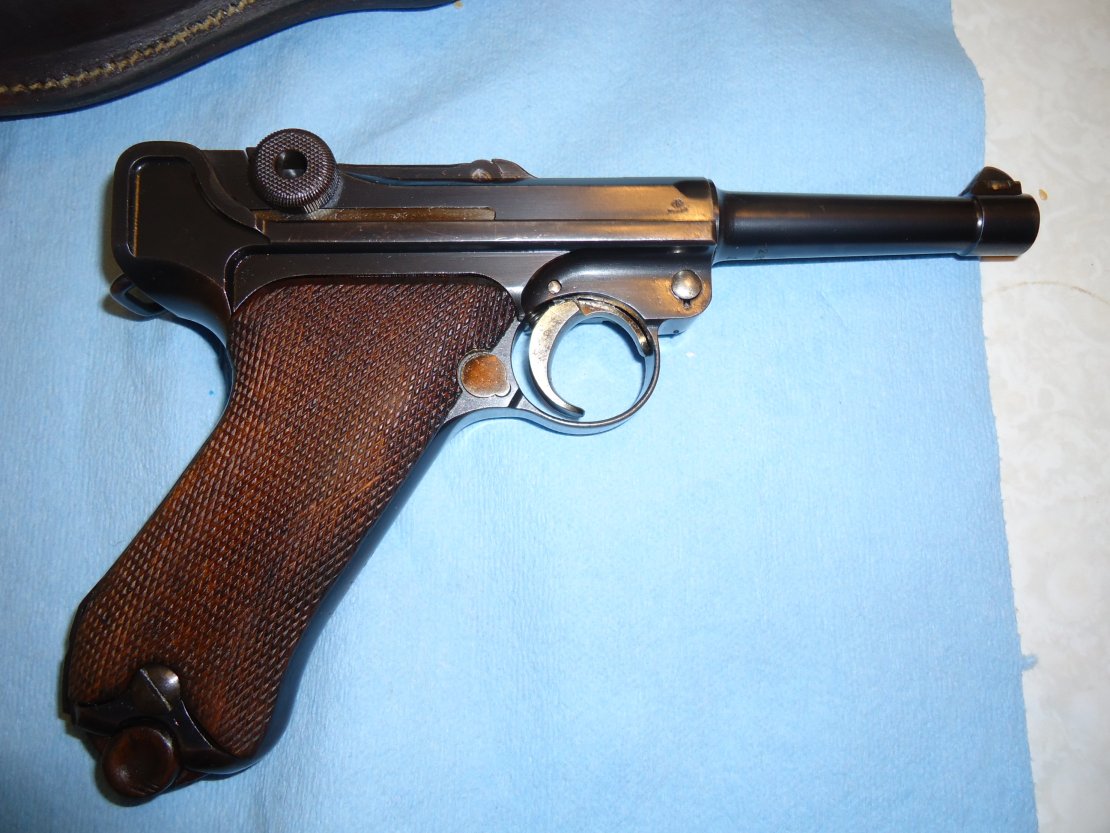

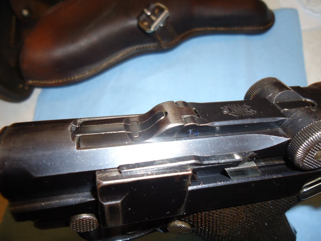

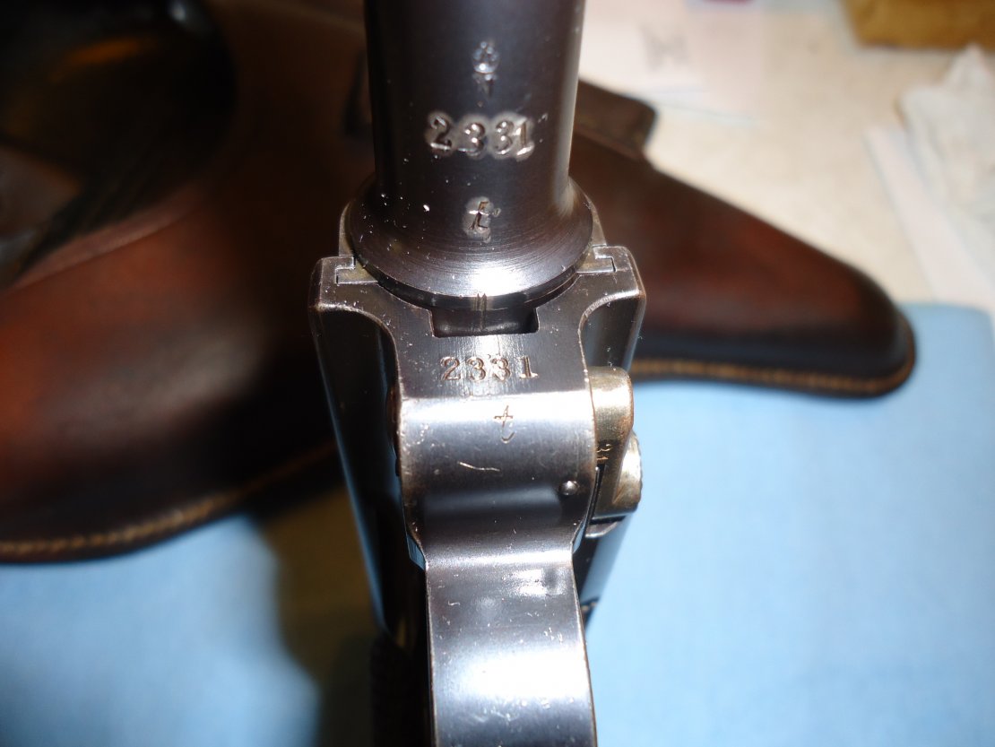

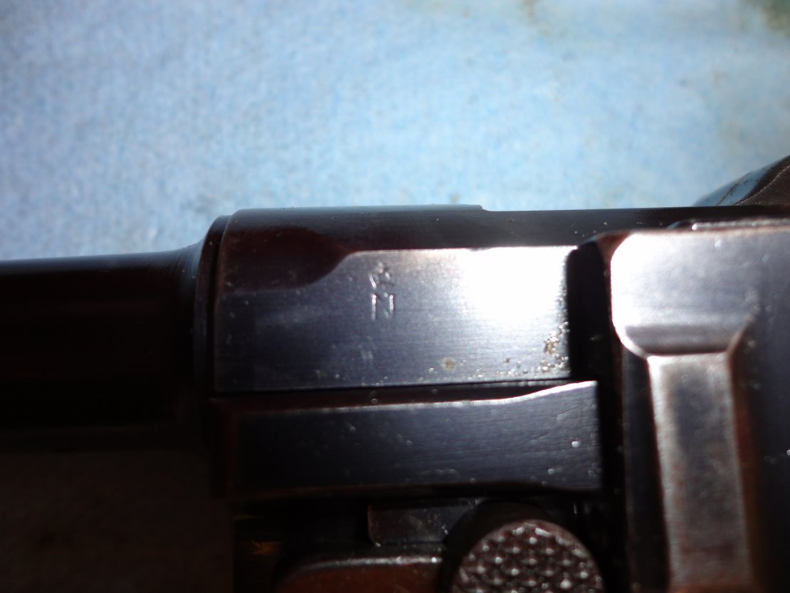

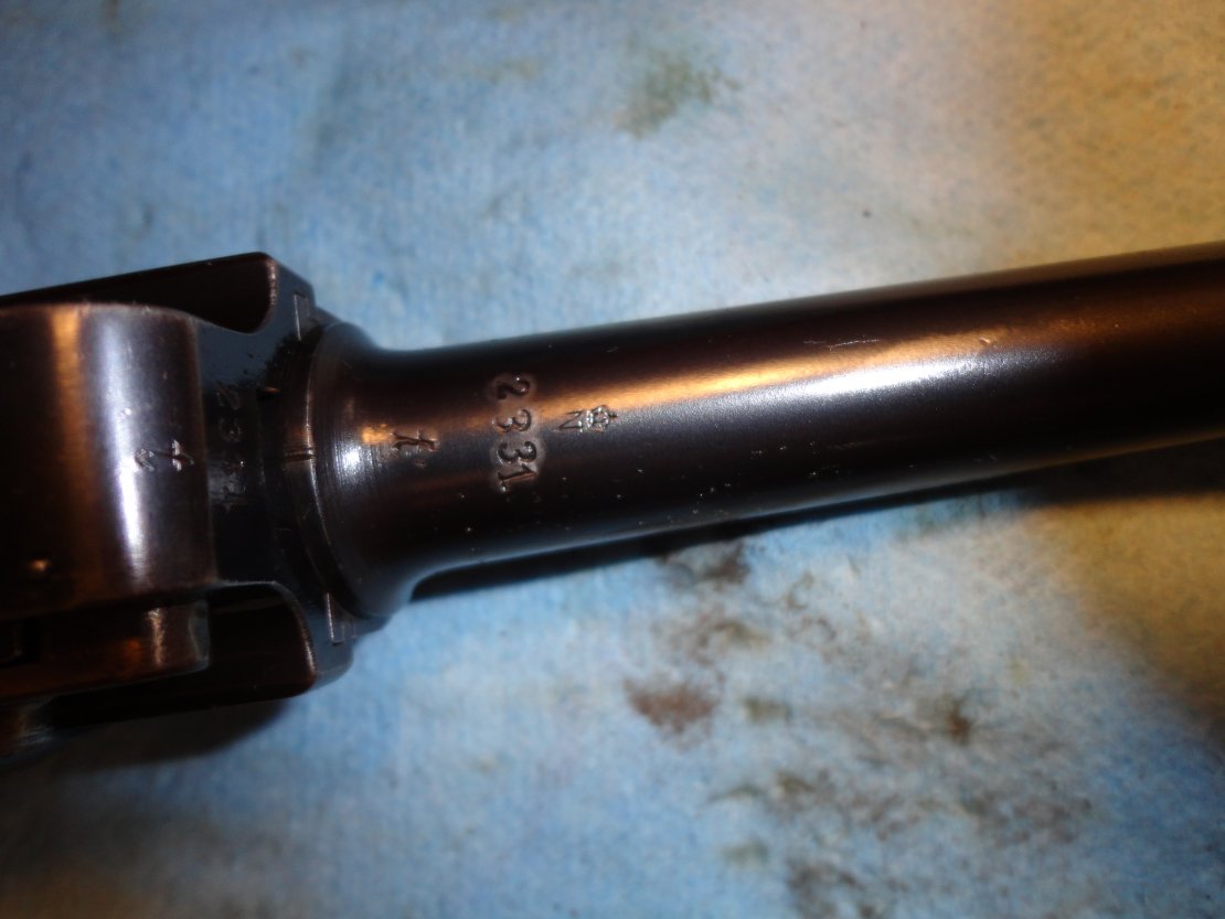

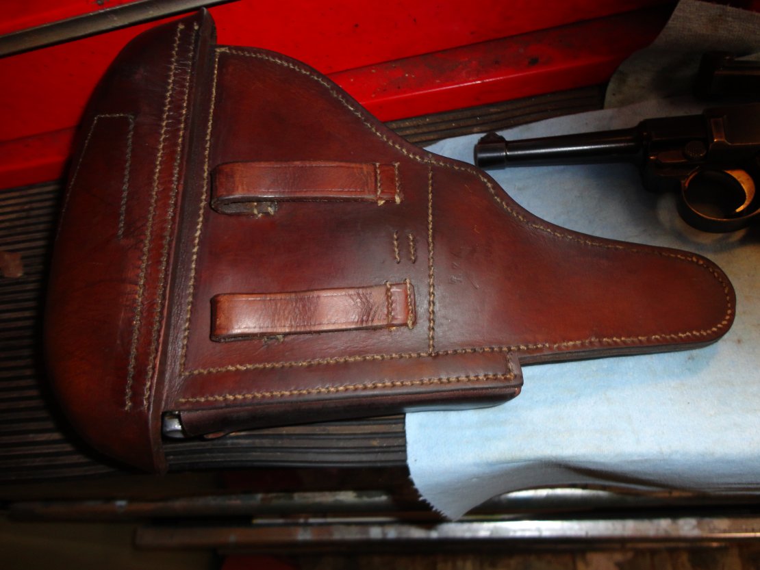

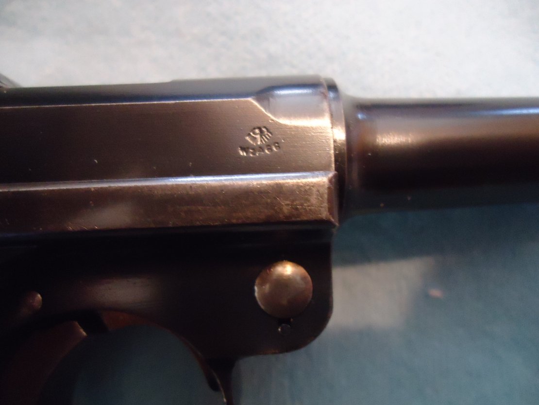

what i think i have is an early commercial p08 dwm,9mm ,4", all numbers matching, but the mags, mags are or seem correct for period, serial number 2331 alpha t , not sure of that, left side proof crown N, right side wza66 ,crown n under barrel with serial number, there is a pinned hold down strap over the side plate, gun is 98 percent, excellant bore, shoots and fuctions well, over all great condition, holster, comercial ,brown looks like marked lza and a egale, unit marked L.Hi.65 front strap,mags unmarked wooden bottoms,stock lug,exc grips, has hold open. over all i give this gun a solid 98 per,best one i have owned. un dated over chamber, i have never seen the hold down strap over the side plate, any help would be greatly appreaciated, i hope the pics will load, i took alot, danodesertrain@yahoo.com thanks again for your help Padre Dan

Unread 02-06-2012, 09:10 PM   #4
Dan..i have never seen the hold down strap over the side plate, any help would be greatly appreaciated,
This is a Police sear safety
Your pistol started it's life as a Commercial and was pressed into service with the Weimar Police.
Is it 9MM? I see it is..

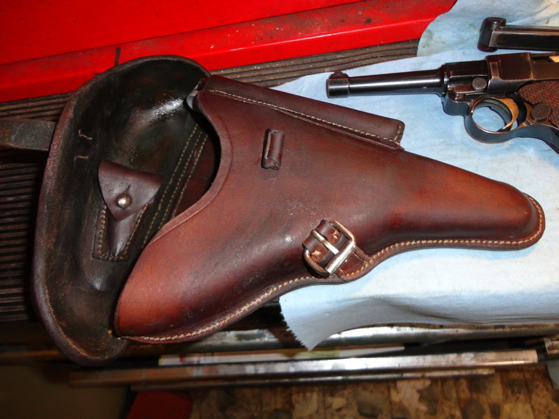

I can't see the holster well enough to comment on it.
Unread 02-06-2012, 09:48 PM   #5
In any event, both the Commercial-Police and holster seem to be in stunning condition!!!

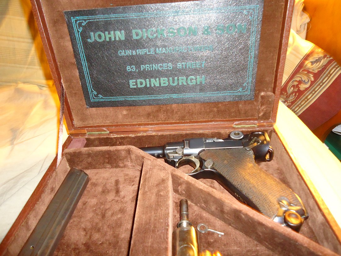

thanks does any one know the year of production? it is perhaps the nicest luger i have ever owned, the part over the side plate is a police safety? besides the holster it was in a case marked john dickson an son edinburgh. does any one have an idea on this case?
Unread 02-06-2012, 10:54 PM   #7
Dan, The case is an unremarkeable common relatively modern gun case. It has nothing to do with the historical aspect of your Luger. I suspect your Luger is mid 1920's. Some members here can pin it down with the serial # and suffix.

Unread 02-07-2012, 12:27 AM   #9
Dan, Holster is a reproduction.

Hi Dan,
Thanks for posting your extremely nice Luger.
Your Luger, S#2331t, is classified as a 29DWM in Jan Still's 'Weimar Lugers'. It was made in 1929. As Jerry stated before, this Luger started out as a commercial. It originally had a 30 cal. barrel. and no sear safety. The 9mm barrel and sear safety were added at an arsenal. Most 29DWM's were procured by the Army or Police. Only a few were sold commercially.
Mike C.

Your gun never had a chamber date. Those recommending a recoil spring check are concerned that the spring was not replaced when switched from .30 to 9mm. This is hardly likely.
I would recommend a local gunsmith do this at this point, unless there is a knowledgeable site member near you who can help. Look up spring/caliber combinations in the search mode here on the site to learn more.
Youtube has several decent videos on field stripping your gun.
I agree with Jerry that your holster is a reproduction.

thanks, i could not see how the chamber date could have been removed and it still look this good, i have fired it about 50 times with factory remington loads with out any problems, i fully field strip it and cleaned it when i first recieved it and to check it for any problems before firing it, i had no idea it had been a .30 being changed to 9mm. nor did i know anything about the recoil spring swap. the gun to me is very nice and i just would like to know as much about it as i can. the unit markings L. Hi.65 i am being told means weimar era,L aassigned to landiger (rural constabulary),Hi Hildesheim distric, .65 meaning item 65, what can anyone tell me about the proof marks anda appromate value for it, allso are the mag bottoms wood or resin, sorry for so many questions, but this is the first luger i have really considered as a keeper, again thanks every one for your help, regards Dan

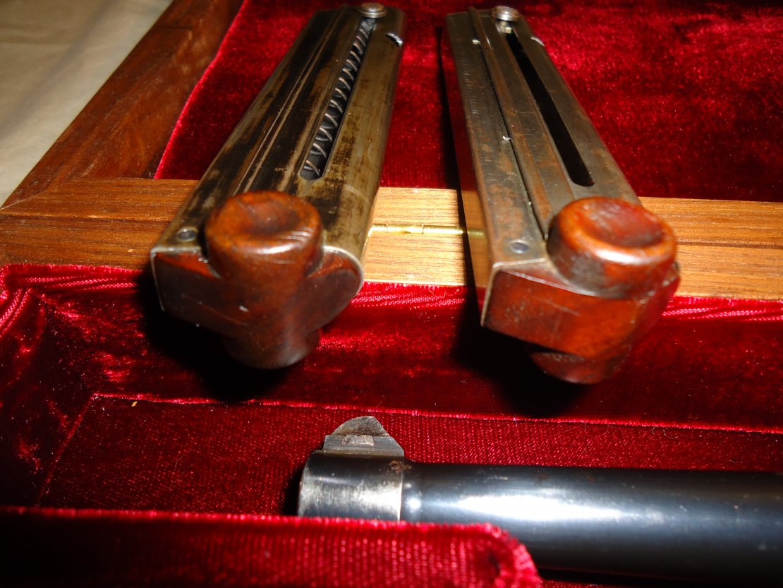

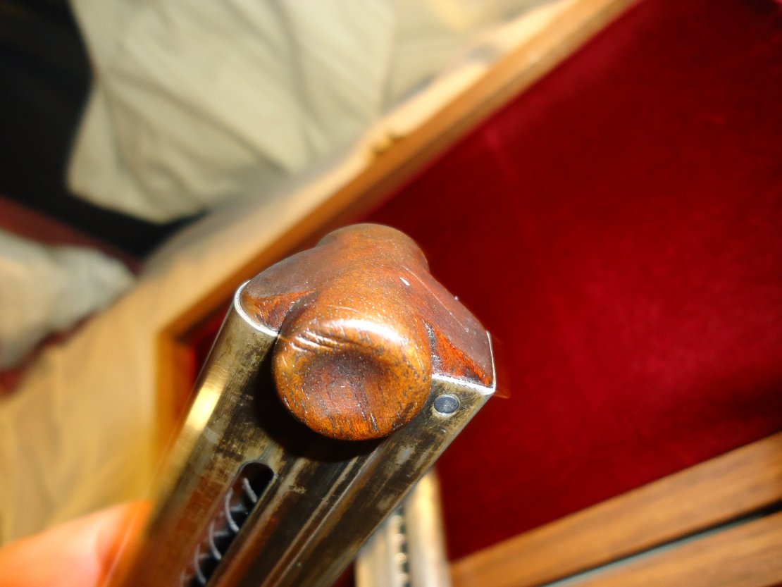

Unread 02-07-2012, 11:34 AM   #15
padredan
padredan's Avatar
Join Date: Feb 2012
Posts: 937
Thanks: 429
the mag bottoms look to me to be wood, they are undated, but appear to be correct. i allso have a another mag that is alum bottom and numberd and maybe world war two, it works just fine but does stick out the butt of the gun further, i know it is not correct for this gun, but should it be a tad bit longer than the others? thanks

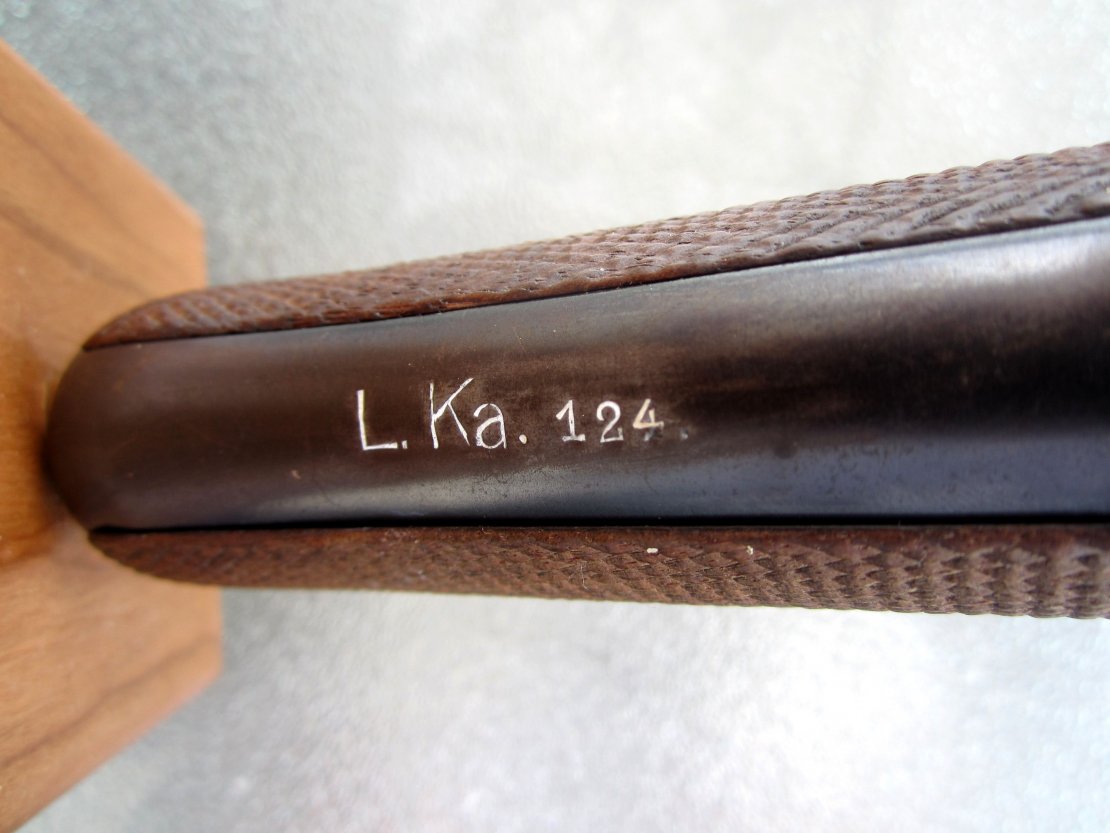

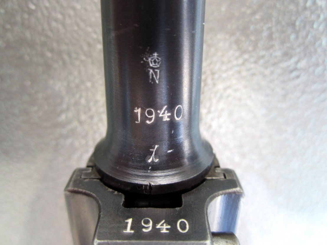

Unread 02-07-2012, 12:39 PM   #16

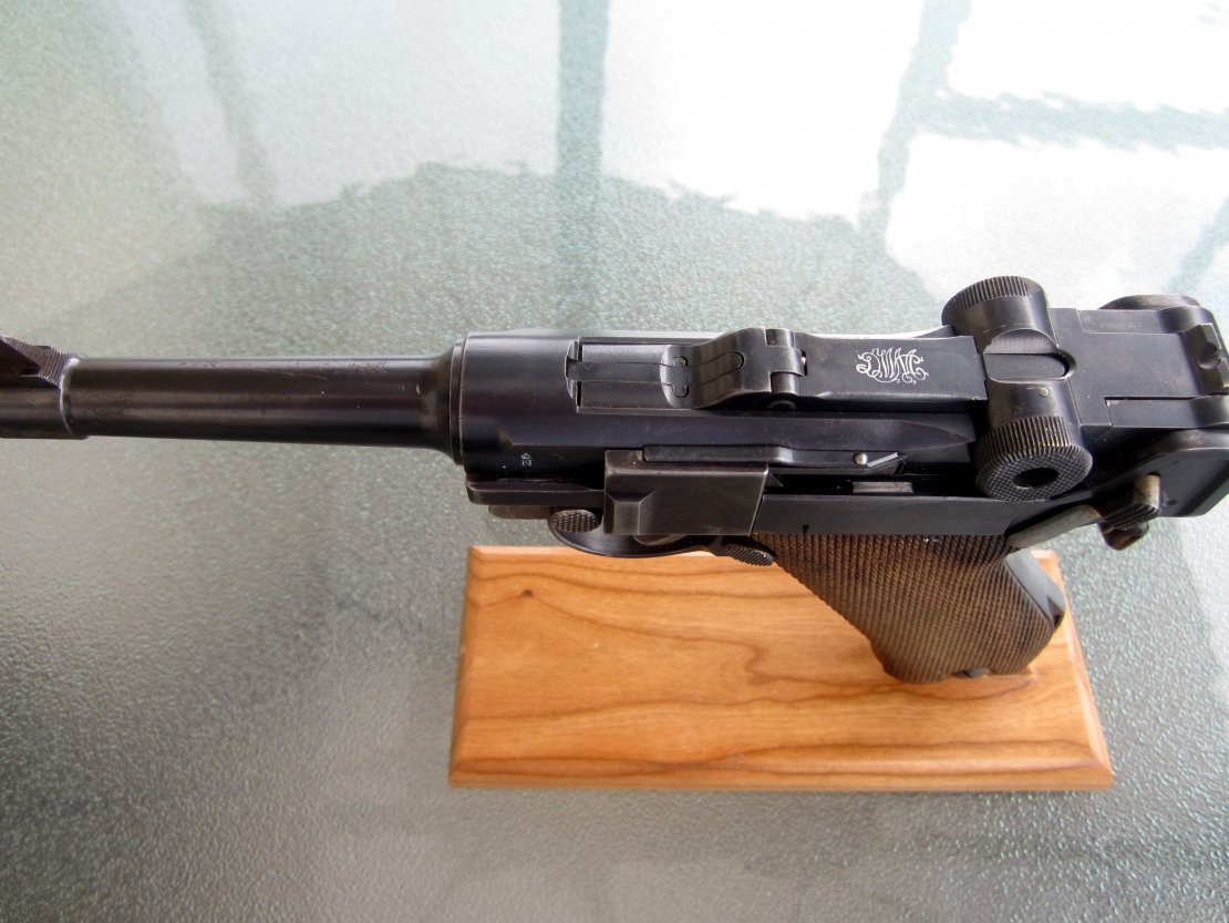

Mine looks related. Any comments or observations

Unread 02-07-2012, 07:15 PM   #18
both of our are vey close! L.Hi.65 and mpne is L.Ka.124!! Good Stuff!

The two blank wood bottom mags are commercial and correct for this model. Police replacement mags will have the serial# and the number '1' for the primary, and '2' for the extra mag. The tube of the aluminum bottom mag you mentioned is cut square making the front edge stick out at the bottom. Earlier mags were cut at an angle to match the bottom of the frame. They should be the same overall length.
Mike C.
