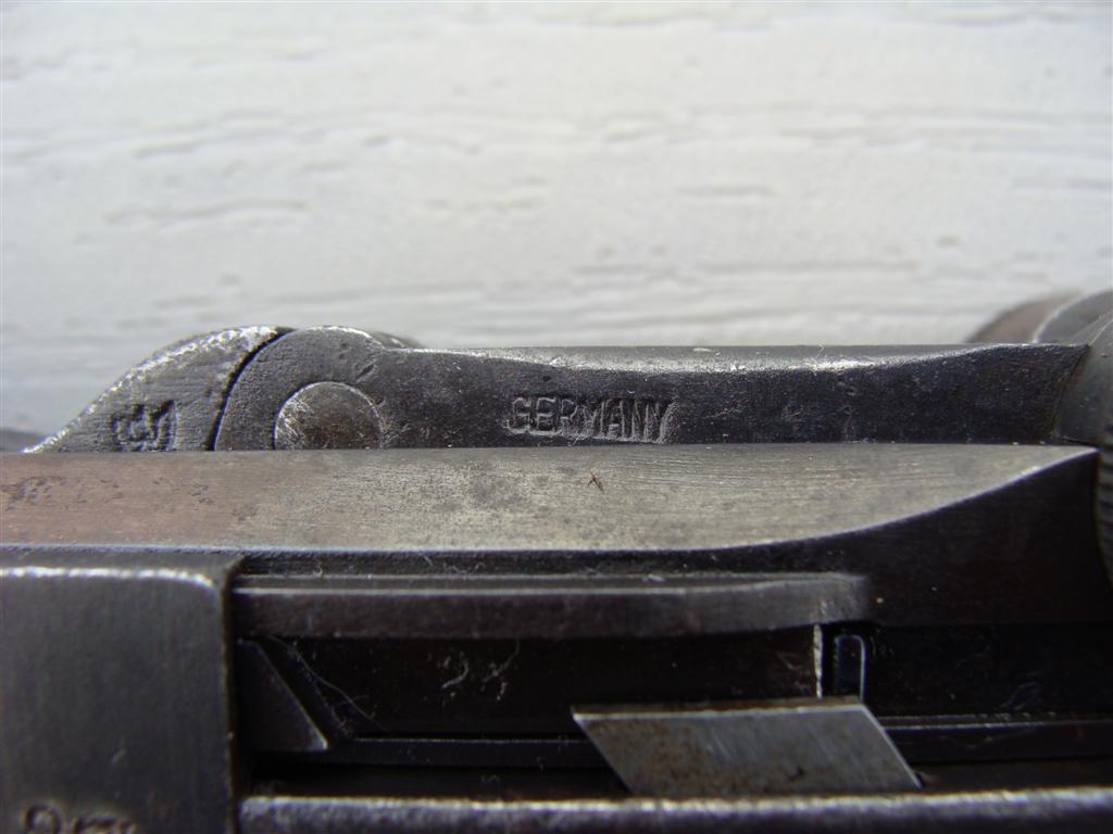

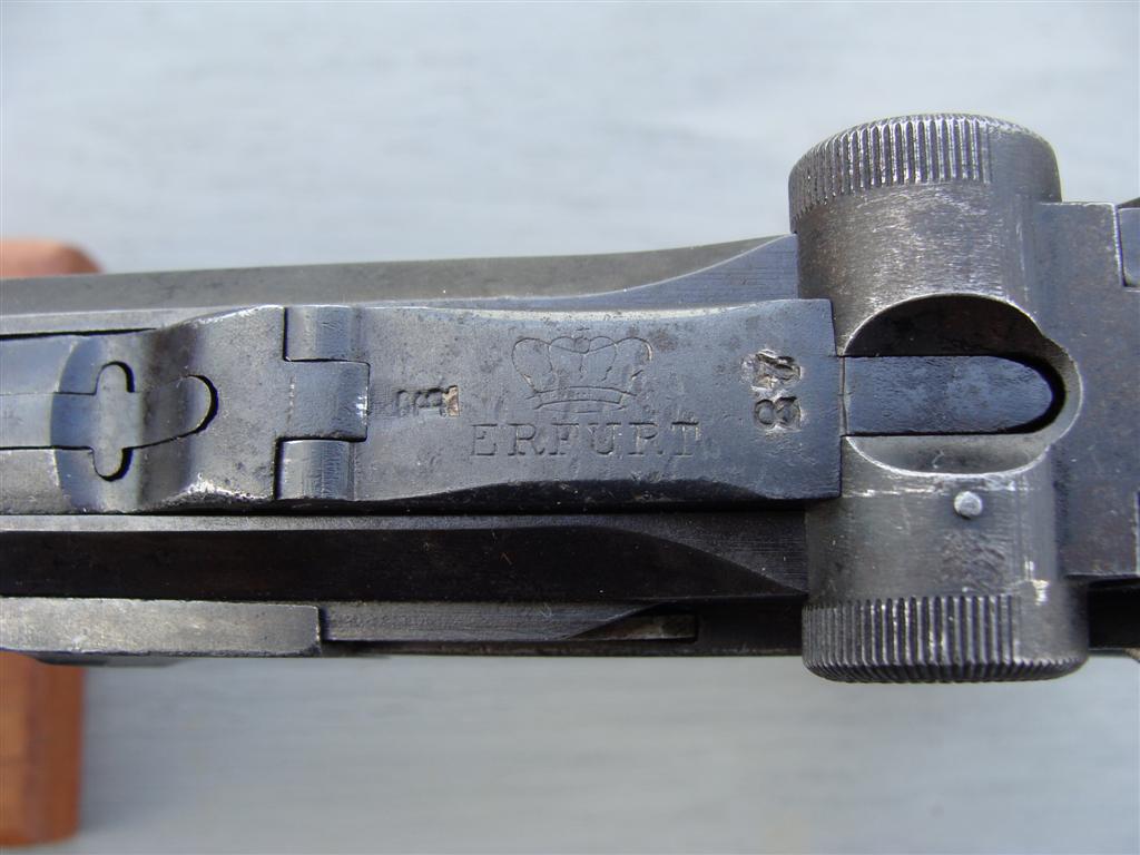

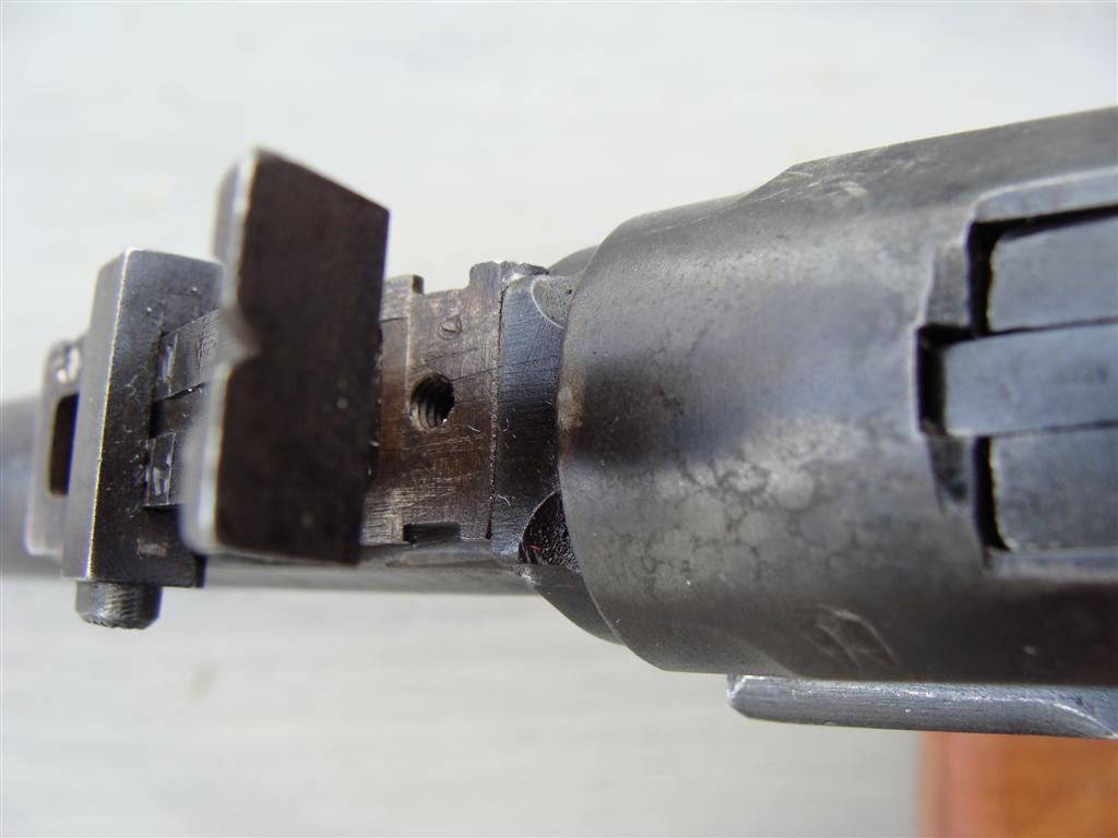

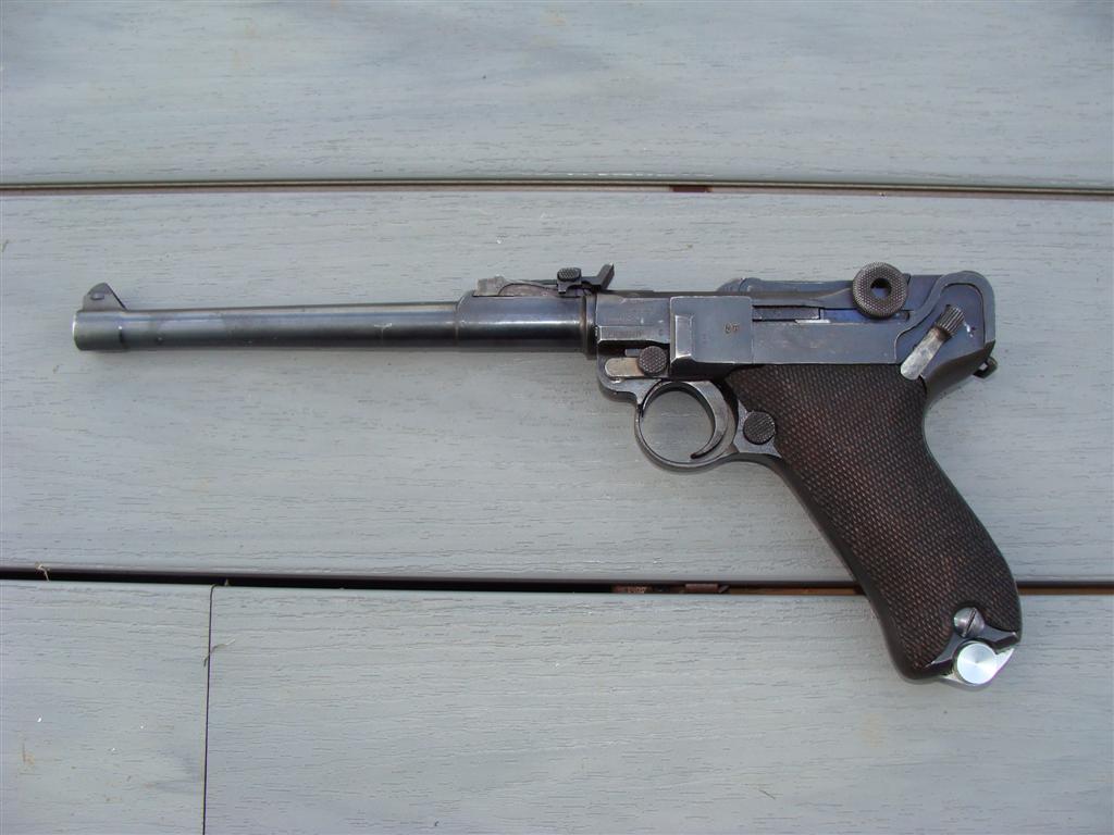

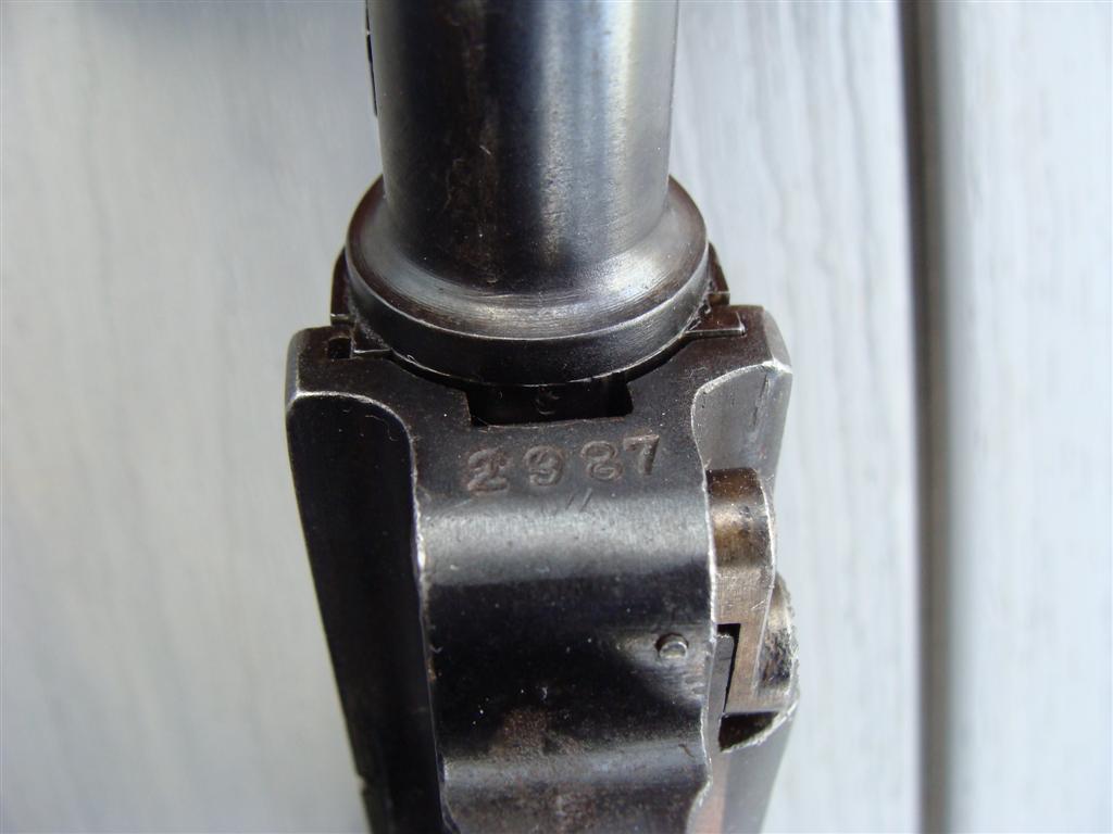

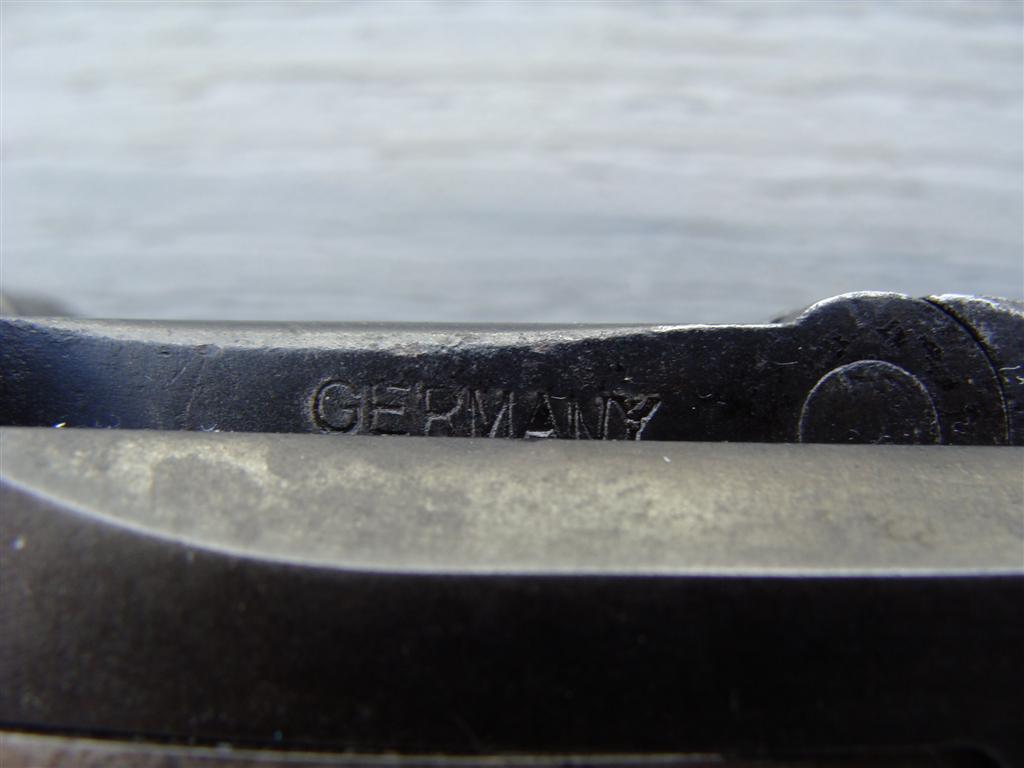

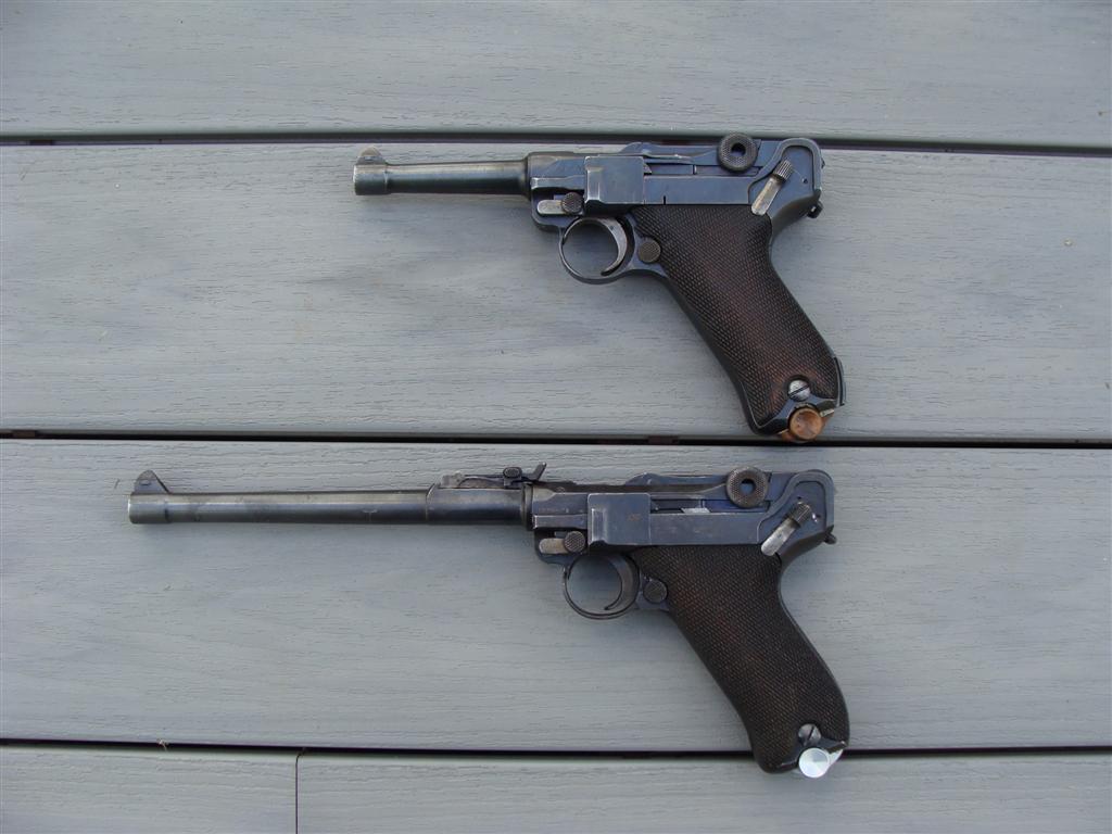

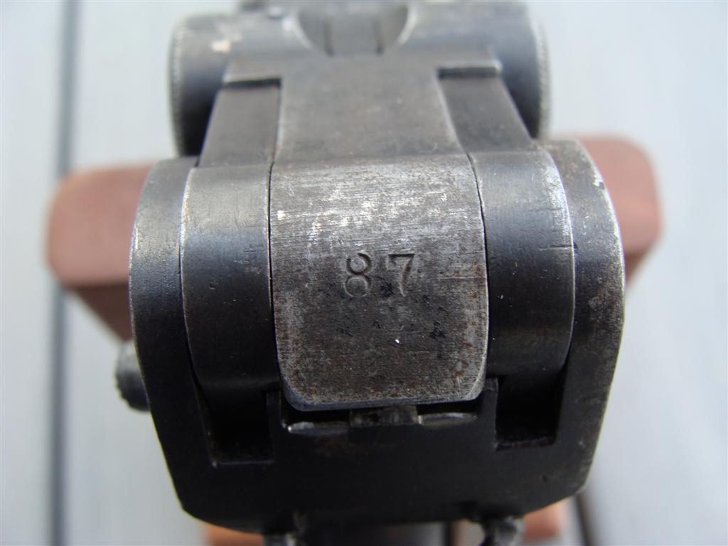

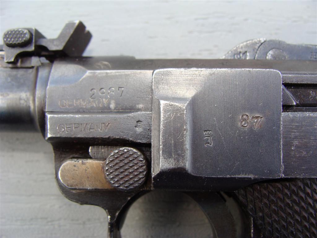

I recently bought this pair of Lugers as shooters. The standard one is a 1914 DWM that is matching but has been refinished. The other one is an odd faux long Luger. It is marked Erfurt but there is no date. There are multiple "Germany" stamps so I assume it was imported in the 1920s. The long barrel and sight are completely free of serial numbers. Several parts have been restamped to match. It doesn't have the receiver notch for the rear sight but it does have an artillery toggle that has been renumbered to match.
My question is, is it likely the new barrel was installed in Germany before it was exported, or more likely the barrel was installed in the US?

This Luger is all over the place. Others on this board have much greater magnitudes of experience and advice, but I'll try to start things off on this Artie.
The Artillery 8" bbl is not accommodated by the receiver, as you noted, which has no notch; so the frame was made before the point at which all Lugers had this notch regardless of what length barrel was applied to them. External serial number marking is military style. But the take-down lever should be numbered on the outside, as well. If a number is found on the bottom edge, it's from a commercial pistol. Also check for numbers under and behind the sight components on the bbl because if its origin was commercial, then they would have been tucked away, like the comm. style take-down lever.
Has anyone else used the term "Heinz Pistol" yet? Assembled from 57 different varieties...
A forum administrator told me last year that any artillery model would be worth at least $1,000 as a shooter; but I think in this case, in order to achieve that, you'd perhaps consider finding a Luger that has a notch and needs a barrel. The bulk of the remainder seems like an Erfurt, which would be proper, numbered military style.

Hi James, Welcome to the forum! I wish I had better news, but an Artillery Luger with no stock lug has limited usefulness. I don't know who assembled this piece, but I doubt it was the Germans. Regards, Norm

James, there is another "project gun"--so dubbed by Lugerman--in another post. I'd be tempted to use the bbl as I mused before, and use the Erfurt/Heinz for a Baby .45 GAP conversion. And/or perhaps pass the barrel on and defray conversion price tag with the proceeds.

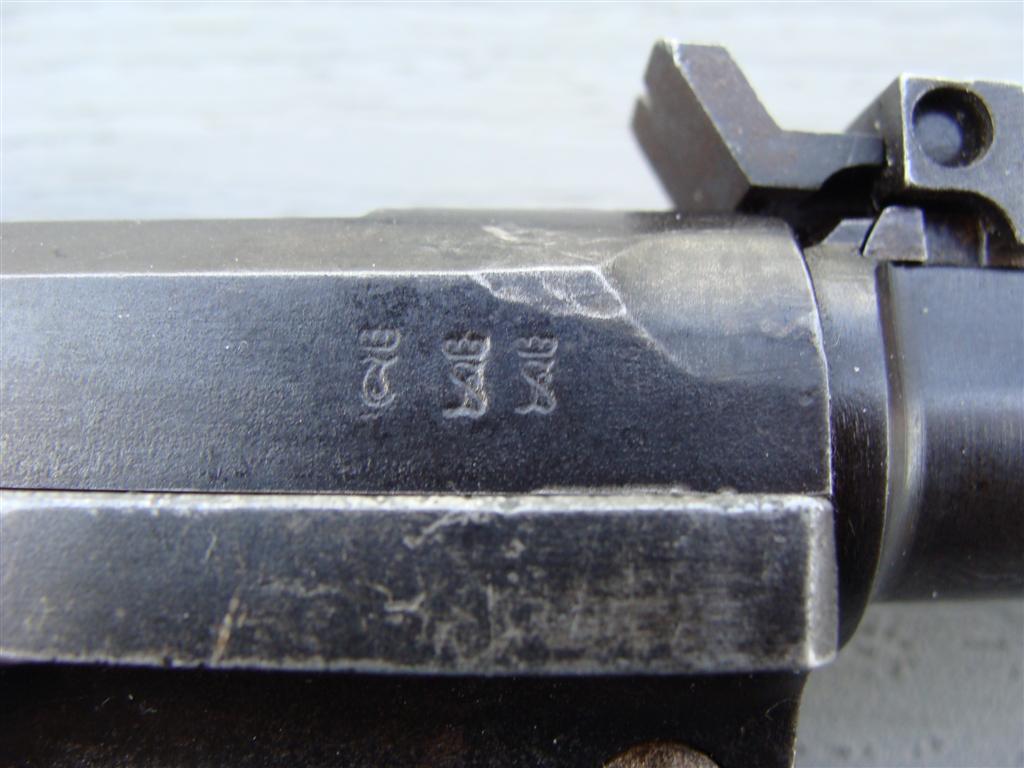

Agree with all of the above. The proof marks on the receiver rt. side (TSS) would indicate a 1917 or 1918 DWM.

Is the frame lug missing or ground off?
Ground off.
