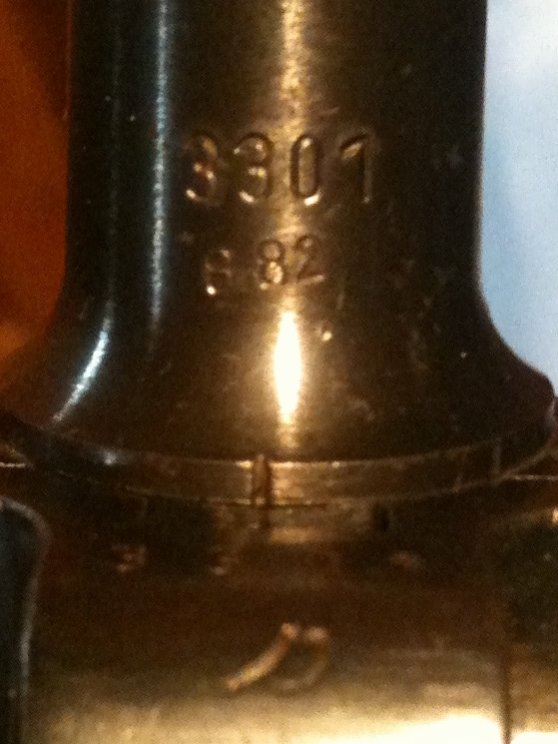

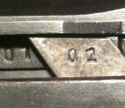

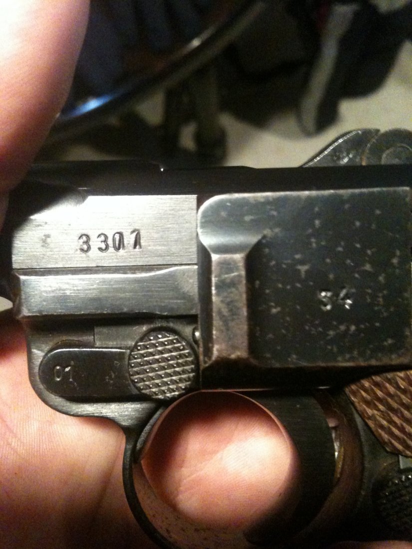

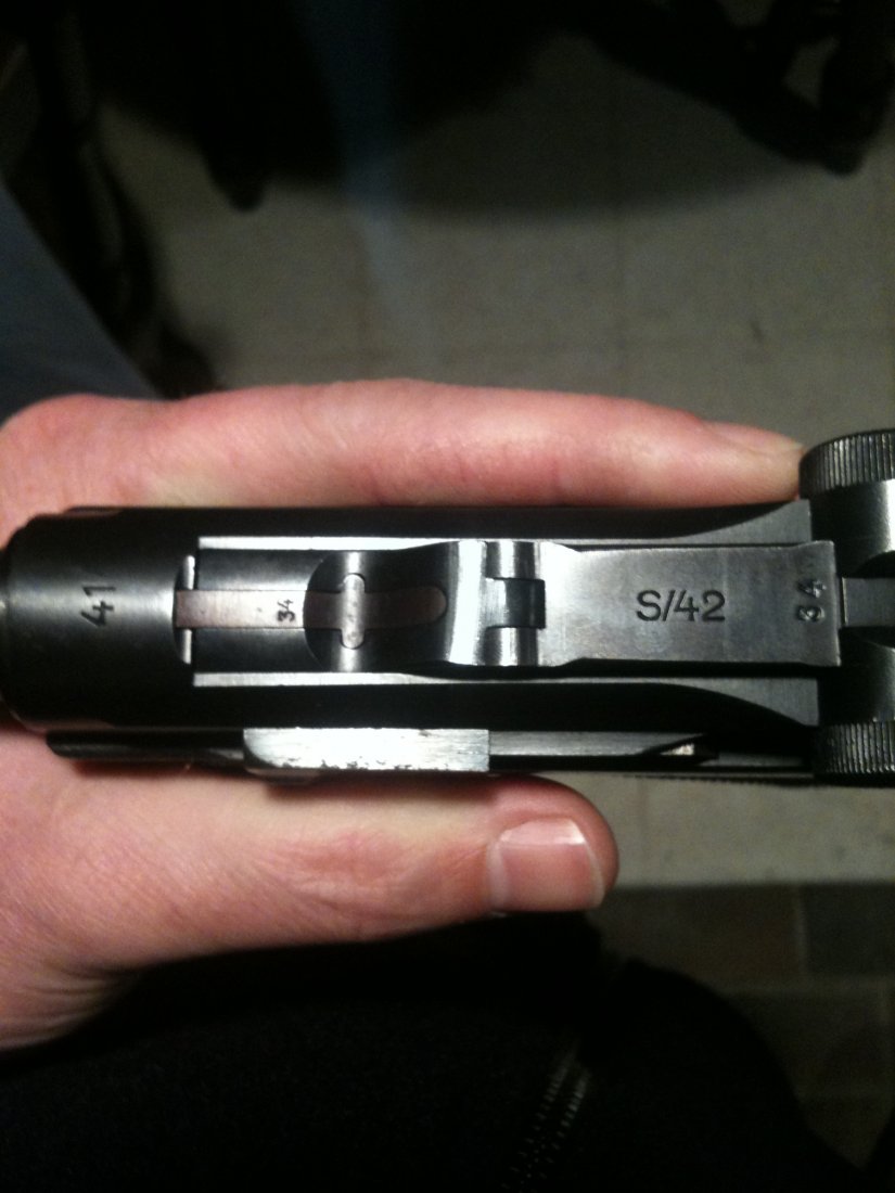

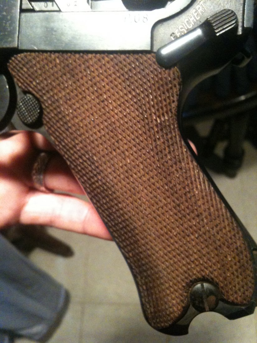

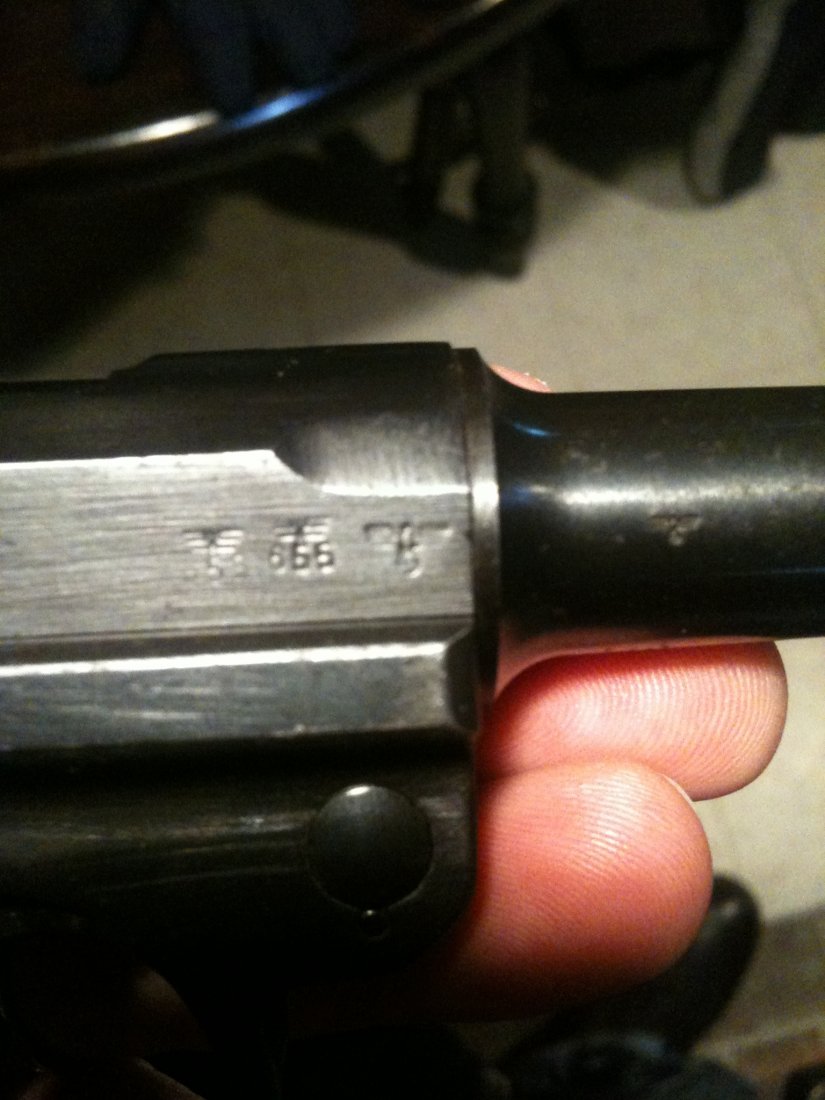

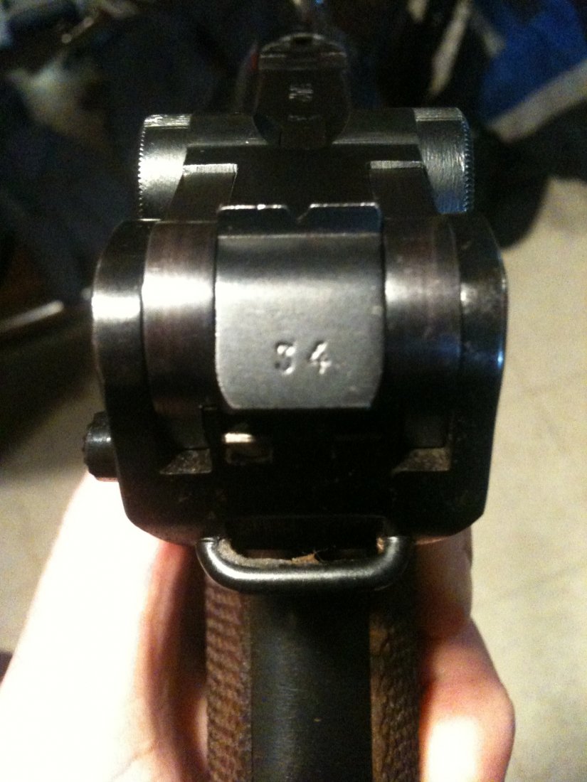

I am a new collector and have decided to take the plunge and purchace my first. I'm not too sure what I have and any insight is much appreciated. I have a few concerns... The first is the serial number on the left receiver. At first glance, it appears to read 3301. Upon further inspection the 0 seems to be a stamped over to cover another 1. Perhaps the original serial number was 3311? My second concern is the font of the silver piece on the left side. It LOOKS like 02 but if you look closely, it is infact 01 but the font of the 1 (looks like a stubbier version of this 1 font) is different from the other 1s which have the subtle hook at the top and a verticle and widening down stroke. My third concern is the other serial numbers. 34 appears multiple times. I believe I read in the FAQ section a while back that it was not uncommon for some of the serial numbers to be a digit up from the first two numbers of the original (ex. 3301 having 34 on some of the matching parts). I read recently in the FAQ that all military Lugers have the last two digits only. My final question is the overall condition and desireability (if that's a word) of the piece. I have a holster (minus the tool) for it which I deem to be in very good to excelent condition (but what do I know?). Also, I have two magazines serial numbered 8797 and 9290 both with various stamps which both include the stick-figure eagle. I have included many pictures and can aways take more if closer inspection is needed.

Hi Tim, Welcome to the forum! I'm sorry to have to be the bearer of bad news, but your Luger is mismatched. It appears to have been assembled from two different guns (at least), one numbered 3301b, and the other with a serial number ending in 34. It's likely though, that it's a good shooter, so enjoy it and hopefully your next one will be more collectible. Regards, Norm

Norme has given you the correct story. This is what we call a shooter class. If you paid for a collector grade I would try and get a refund. Shooter grades run $700-900. If the holster is in good shape $200-250. With certain year Mausers the number inside the sideplate will be generally one number above or below the serial number. All other numbers will be the full serial number or the last two digits. Bill

Since the toggle train came from a different pistol, it would have to have been properly fitted to the receiver, frame, trigger plate and trigger. These were generally hand fit when a pistol was manufactured. There are very few good gunsmiths with extensive Luger experience.

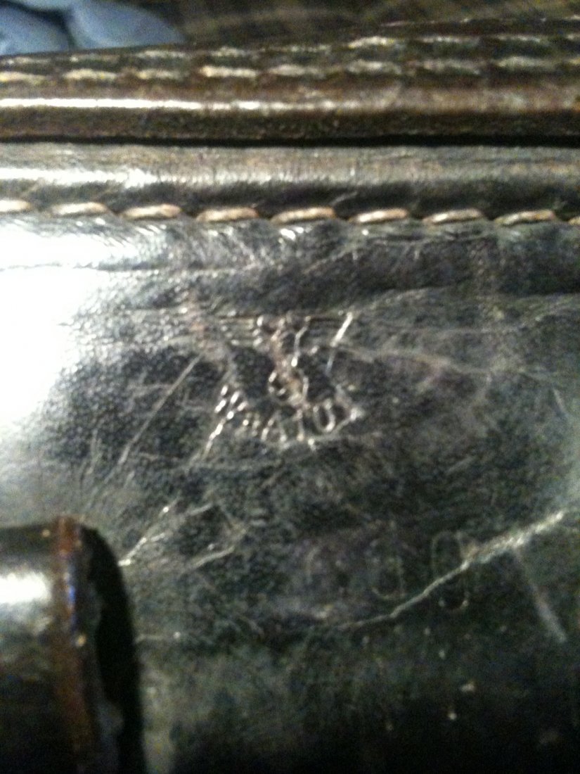

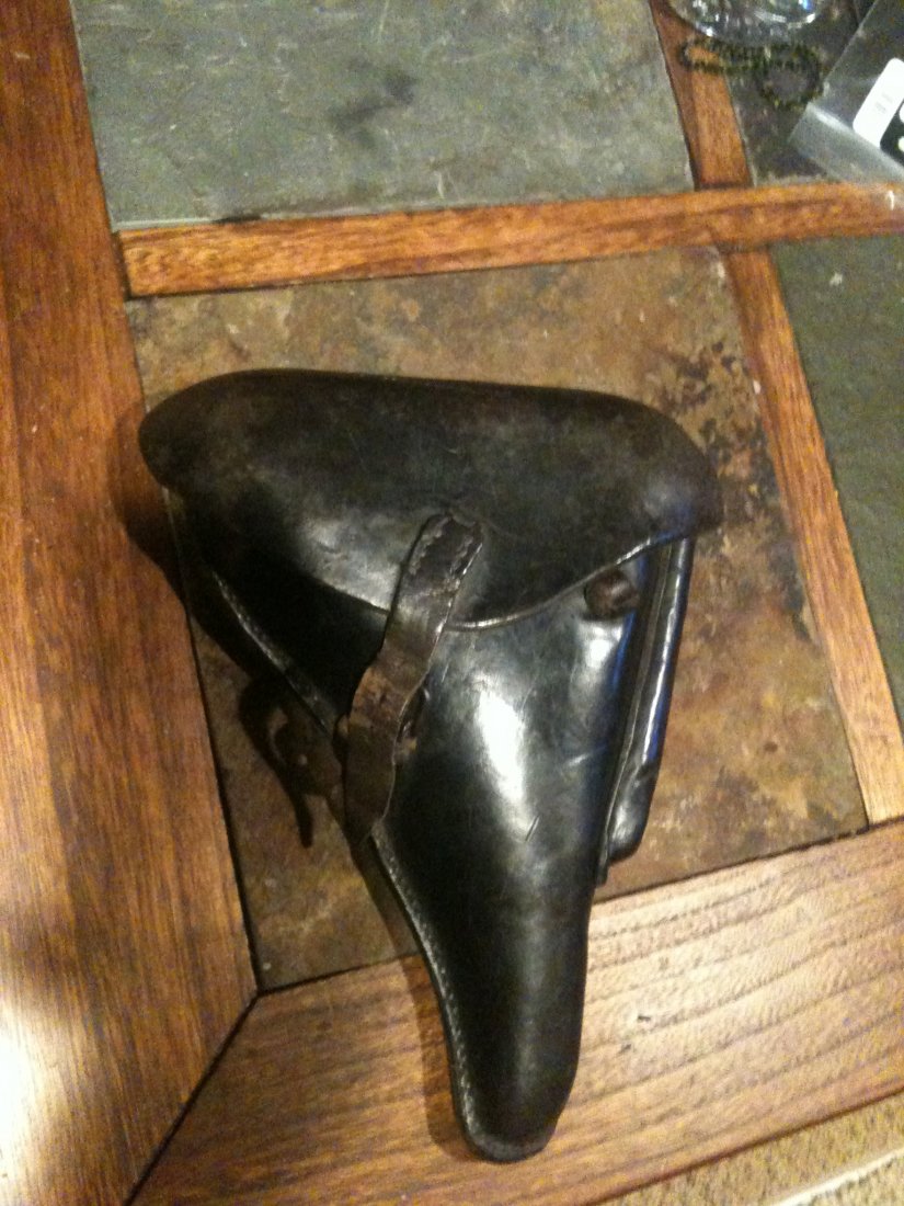

Also, if you post pictures of your holster, including edge on views of the left side, the inside and out, we can let you know if it looks original or reproduction.

Default Hoster pics
These are the pics I have on hand, I will post more shortly...

I wish I could just remember to post all of my questions in 1 post... Does anyone have an answer on why the font of the number 1 on the last pic is different from the others...???

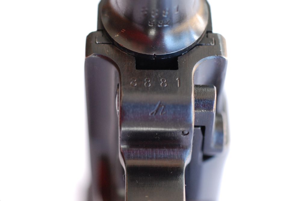

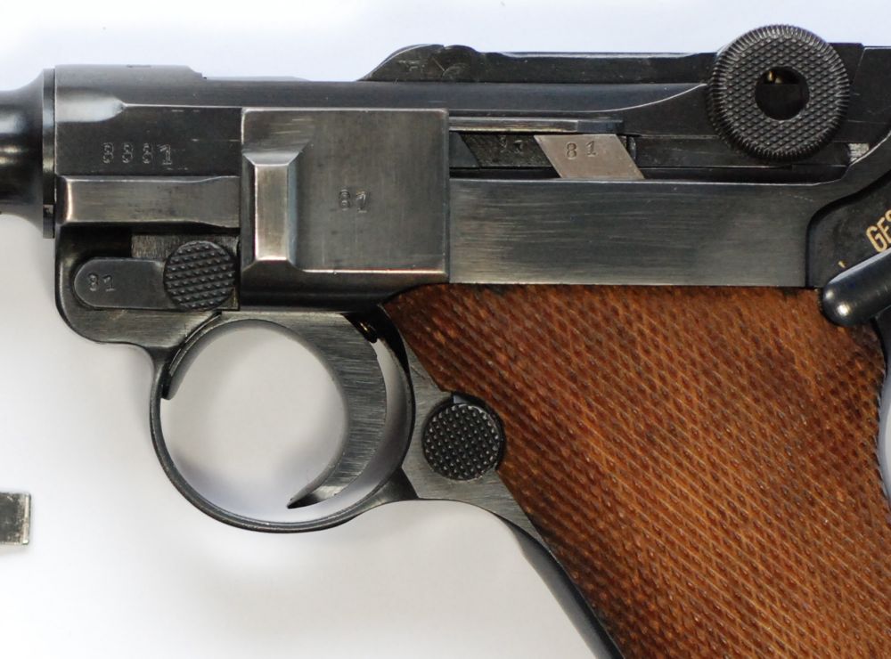

Hi Tim, I know some collectors obsess over font variations but they are rarely significant. The Mauser factory was vast and employed many thousand workers. It's likely that each fitter had his own set of number punches on his workbench and differences in font are quite common, often on the same gun. You will find flat topped 3's mixed with round topped 3's, and footed 1's mixed with un-footed 1's, as on your gun and the one shown below. Regards, Norm

There are many ways in which guns became mismatched. One is by repairs, and another common way was stupid soldiers or armorers who disassembled several pistols at once for cleaning or repair and then reassembled them without checking that the parts all came from the same gun...
