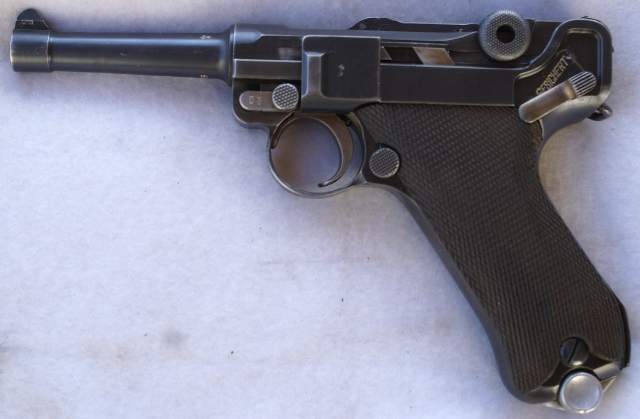

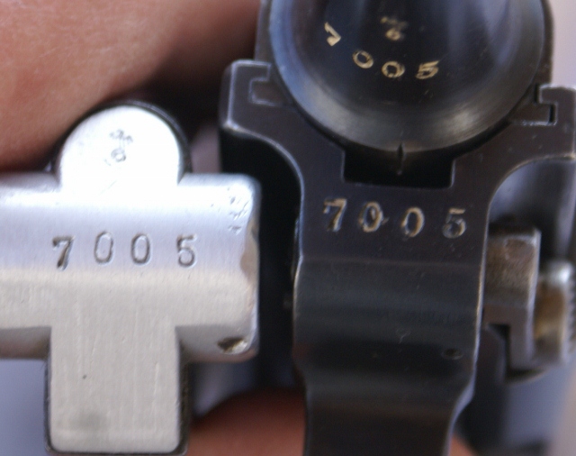

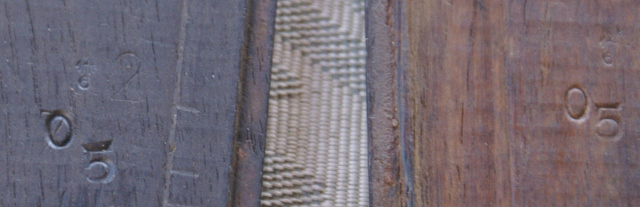

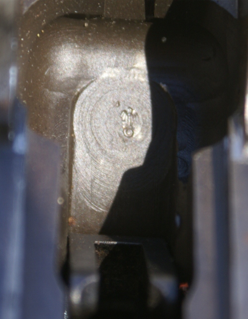

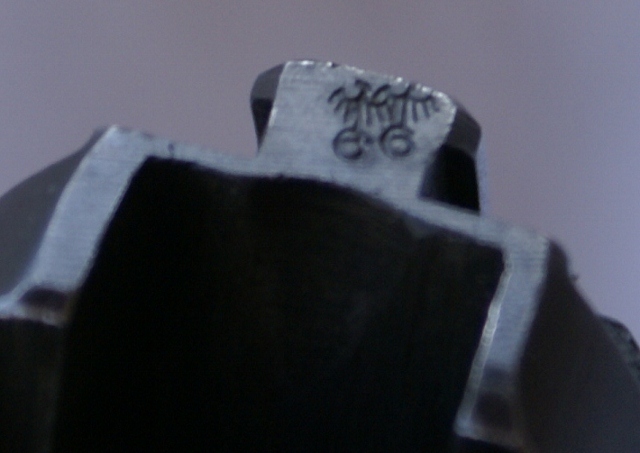

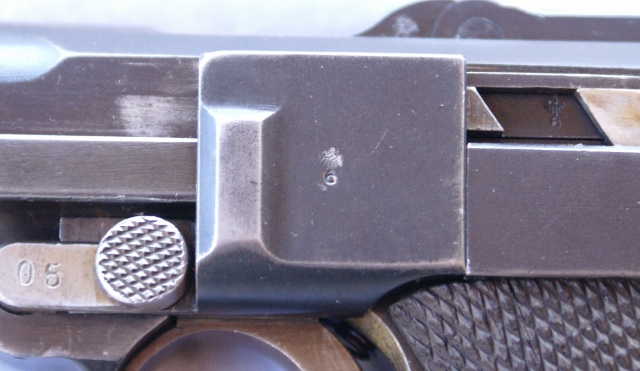

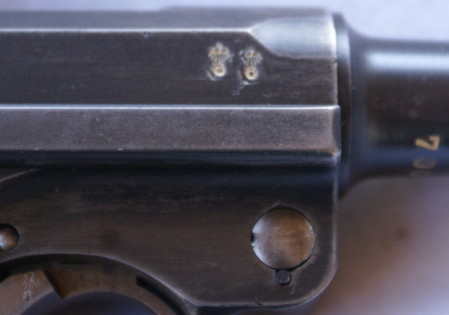

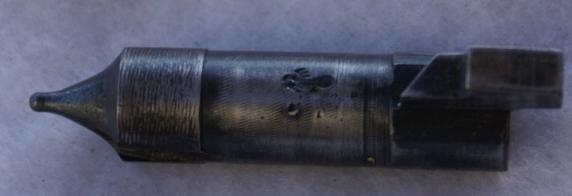

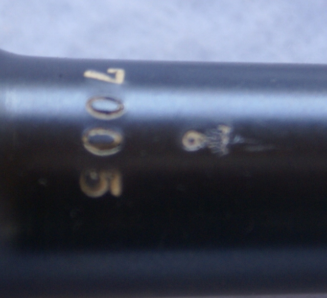

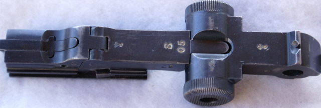

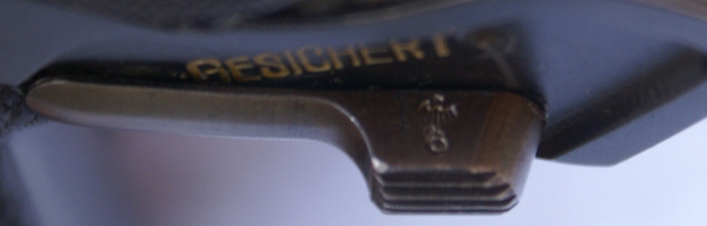

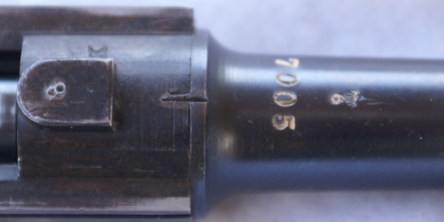

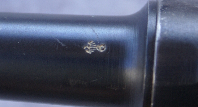

Default 30cal S Simson Pics
Here are the first of the pics. More to follow.
Jerry

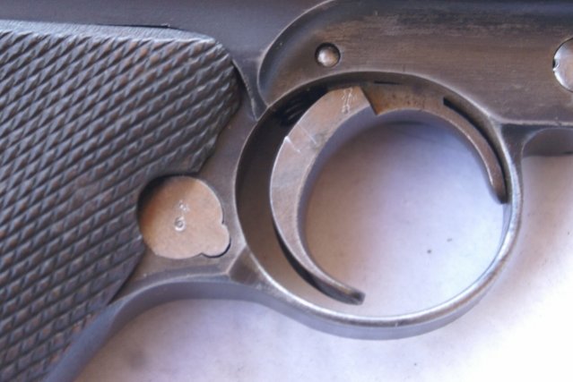

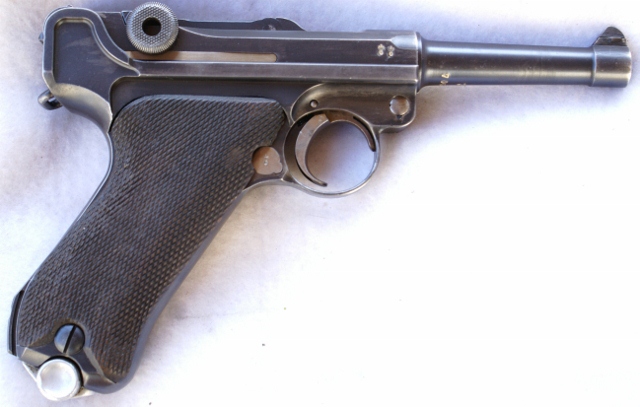

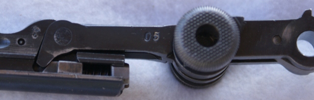

Default Last Pics
Thanks in advance for looking. The forward toggle link appears to be renumbered from 09 to 05 on the left side view.
Jerry

Unread 02-01-2012, 06:23 PM   #8
Posts: 15,976
Thanks: 2,074
I have never seen the stock lug eagle 6's so off-set...

Why do you think there are only two acceptance proofs on the right receiver? Since there is no firing proof on the receiver, could this pistol left the factory in a lunch box?

Unread 02-02-2012, 11:19 AM   #10
jfxcushman
Join Date: Dec 2010
Location: Virginia Beach, VA
Posts: 11
William,
I surmise this pistol, which is 30 cal barreled, went to the Reichsbahn Direktion (railroads). They were one of the few government agencies that used 30 cal. The police were using 9 mm by this time. It is definitely proofed Simson on the barrel in 2 spots, maybe one was for the initial parts inspection as Simson did not make 30 cal barrels, and the second was after final assembly. If as Ed surmises, this gun was rebarreled some time later, then it should have had the 3rd proof on the right receiver as it left the factory. As Ed said, Simson made no commercial Lugers, indeed there are no C/N proofs on it.
The pistol is a puzzle to me.
Jerry
