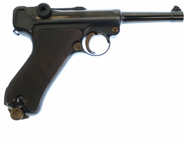

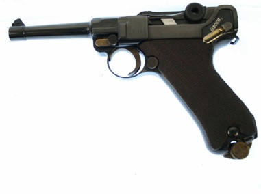

I recently picked up a restored 1914, that I probably paid far too much for, but I wanted a good shooter, and this one seems to fill that bill. I fired it for the first time yesterday, and while I had three or four "stovepipes" (Winchester 115 grain white box of 100 rnds, from WalMart) it's possible the follower spring is a little weak. Certainly, the Mec-Gar mags that arrived via US Mail just hours after I returned from the range are much "stiffer"!
Collectors will hate me, as I'm looking for a repro holster and tool, but it's a user, not just for looking at. As far as the cleaning rods go, I became a huge Otis fan in Afghanistan, so I'm not really looking for a rod or a jag.
Many silly questions to follow, as I have much to learn, but here is my first: Would it work to put a wooden base on the Mec-Gar? Even though it's just for the range, that plastic bottom looks just a little out of place.

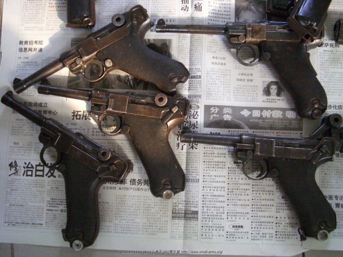

I saw people installed a Nambu Type 14's magazine bottom on a Luger magazine (no one could find correct parts and a solution was needed). Looks like it fits well.
