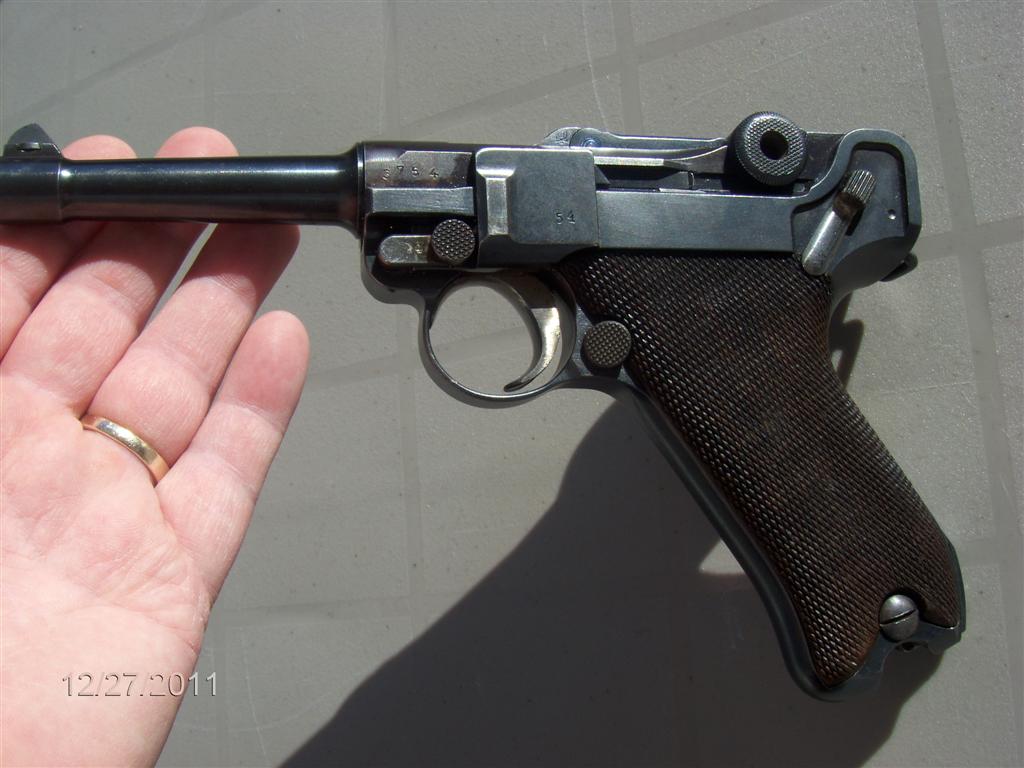

My father has just passed his Luger on to me after having it since the 1970's. He had purchased it from my uncle whom I have little contact with now. The story is that it was taken from a dead tank commander during WWII by his father. I have coveted the gun for many years now and am not interested in selling it or anything as it is primarily a sentimental link to my father. I would however like to have some idea of value for insurance purposes. The main purpose of my inquiry to you is to learn more about the history of the pistol.
I have tried to uncover some information about it by purchasing a book (Standard Catalog of Luger – Aaron Davis) and by reading comments on this forum, but to be honest I am coming away more confused than anything. I am having difficulty pinning down an exact model using the book’s trees as it comes close to some models but not quite right.

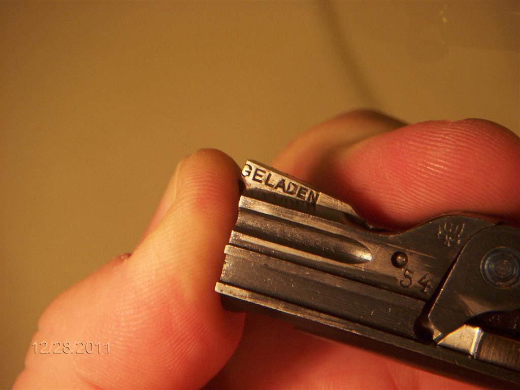

• The toggle is marked as a DWM but the year seems to be 1941 which confuses me.
• There seems to be a bird type stamp on the toggle section that seems to differ a bit from the other images I have seen.
• The gun appears to be in great condition with most of it's bluing intact.

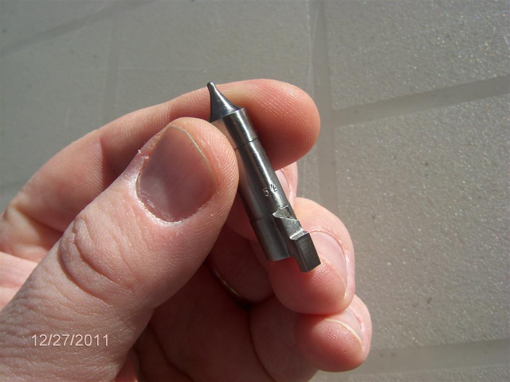

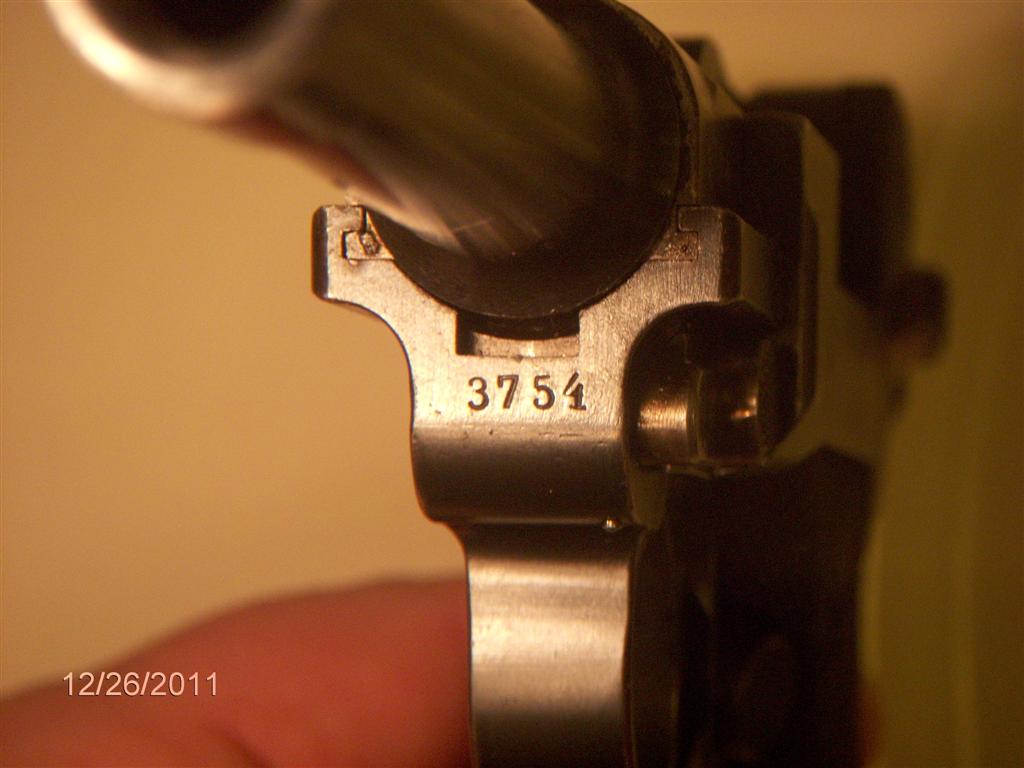

• The serial numbers all seem to match (to the point that I have been courageous enough to disassemble it) although there seems to be a different number on the trigger.
• The wooden grips appear original and have the last two numbers of the serial number stamped into them.
• The extractor has the word GELADEN stamped into the left side.

Hi Scott, Welcome to the forum! Your Luger appears to have been assembled from two very different guns. The lower half and toggle train from a WW1 DWM, the receiver, barrel firing pin and magazine from a 1941 Mauser. Can you post a clear photo of any markings on the right side of the receiver? The holster looks very interesting, it may be a cut down Imperial Navy. I'd love to see a photo of the back and the cleaning rod sheath. Regards, Norm
Unread 12-29-2011, 09:42 AM   #3
The top flap of the holster appears to be a replacement/later addition, as it lacks the curved, concave ends, which would have protected the pistol from dust and dirt. The profile is very flat.
I also agree that the pistol is made up of parts from two different eras, which happen to have the same serial number.
The barrel is also a concern, as the serial numbers are stamped more hap haphazardly than usual. There is no bore guage nor a noticeable witness mark.

I am a bit saddened to hear that my suspicions were correct regarding my Luger. My Dad has babied this weapon for a few decades now thinking that it was an all original weapon. He would be heartbroken to learn that it is made up of two separate guns. I think I will keep that bit of knowledge to myself. He has always felt that this was the heirloom he would pass down to his kids. That fact still makes it precious to me.
Is there a possibility that this gun was “officially” rebuilt from spare parts by a military gunsmith or some scenario like that? The gun seems to function well. We have fired it on occasion in the past and I don’t recall there being any issues. I have heard that Lugers that have been cobbled together from different parts can be temperamental. Might there be any validity to this idea?

Alanint: You say that the barrel is a concern. Do you mean safety wise or other?

The gun "is what it is" and was assembled as such for some reason, sometime. The fact that collectors, some 70 years later, are less enthused, should not take away from your family treasure. Cherish it and enjoy!
Unread 12-29-2011, 03:18 PM   #6
Since it's made from a mix of parts, it would be considered a "shooter" grade Luger.
For that reason, you won't lose value should a part have to be replaced in the future. Go ahead and enjoy shooting it if it's in good mechanical condition.
Most shooter grade Lugers sell for between $600 and $1000.
