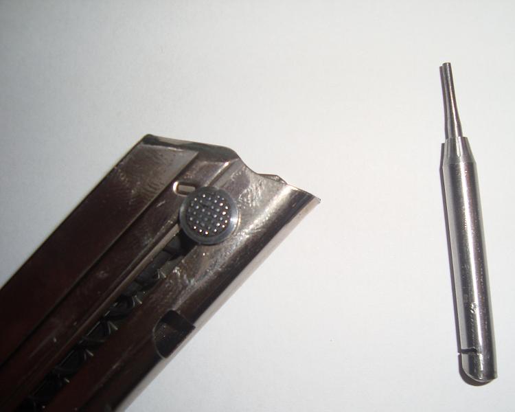

hello again Ugluk;
Please elaborate on how you "adjusted" the lip of your mags.
When I bought my Luger it hat three mags (Sorry, no pics) one was Mauser original, works fine.
2 was unmarked but the bottom plug fingerhold had a bullseye pattern.
3 was marked "Made In Holland" and won't feed 3 in a row.
All three have black plastic fingergrips.
By the way, I'm working on a Lucite tool to open the action for jam cleaning. Pics when complete and working.
Lliam is offline   Reply With Quote
Unread 05-23-2011, 05:10 PM   #18
Ugluk
Posts: 14
Thanked 4 Times in 2 Posts

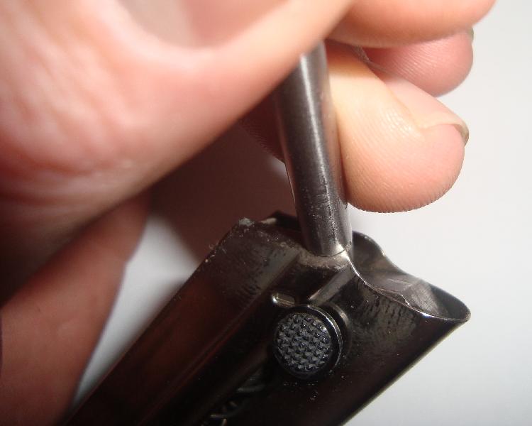

Hi Lliam
Please don't confuse me withsomeone experienced and skilled. There may be a lot better ways than what I did.
A little tool with a hacksaw slit makes it possible to adjust the lips without effort and damage.
I got my Luger with a well feeding mag and bought a Mec-Gar that didn't. I put two rounds in each and looked and measured how high and at what angle the top rounds sat.
Then I adjusted the mec-gar lips in until the mags were roughly equal.
The original one still is a hair better than the Mec-Gar so I'm not there yet, but it is a close thing now. A new main spring really improved things as well and I expect stronger magsprings would too.
There's real pros here that know how it's really done. Hopefully they'll call in and help out.

Very clever! What's the punch end for, the base retaining pins?
Unread 05-23-2011, 11:08 PM   #20
Ugluk
Posts: 14
Actually, I made it for the extractor pin. But I discovered that in a pinch the striker will do just as well. Just a little field tool for what the loading tool won't do..
