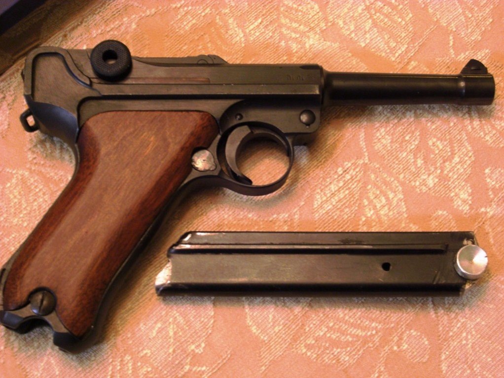

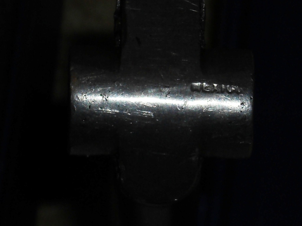

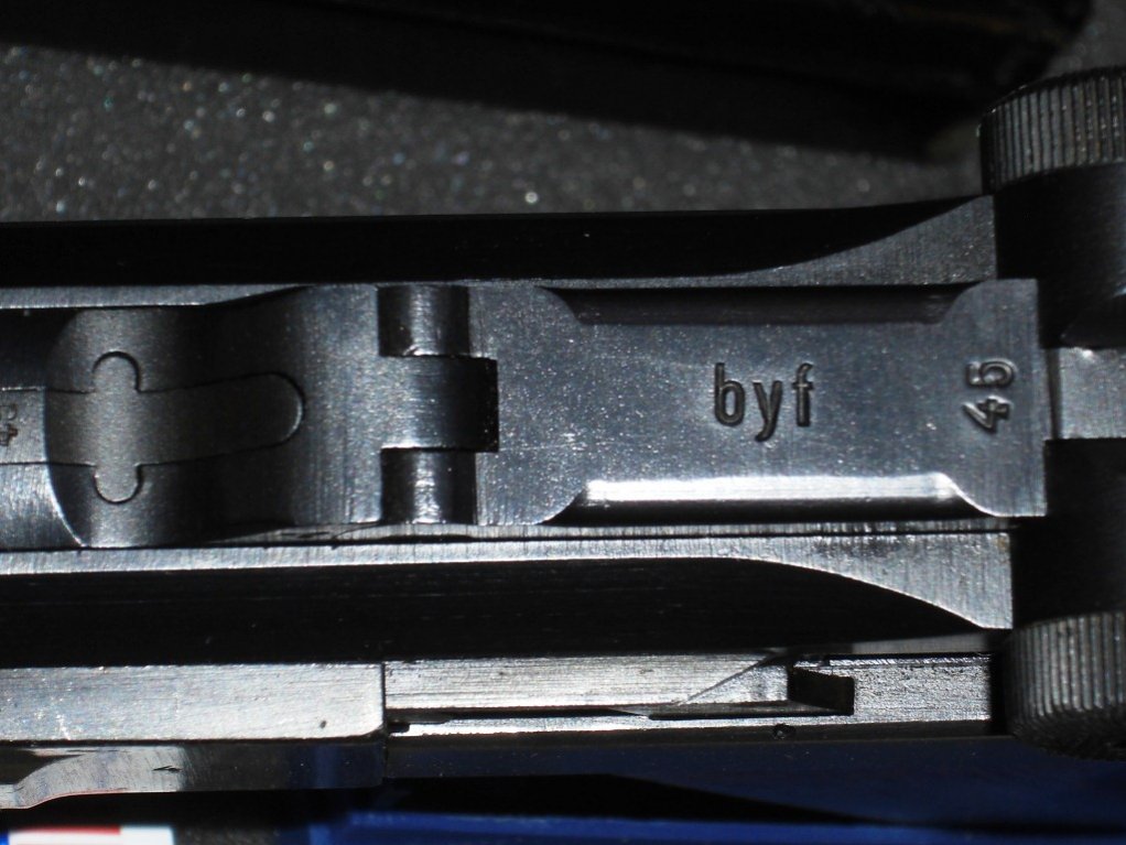

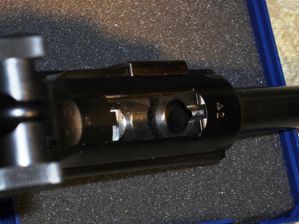

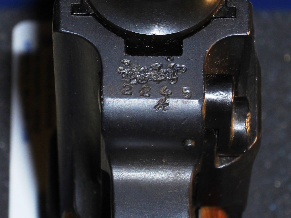

Gentlemen, I am new to this forum but not to shooting and have been a member of the NRA for 40 years. I am very interested in acquiring shooting examples of classic firearms. I have an opportunity to acquire a "shooting grade" P08 which has matching numbers with the exception of smooth walnut grips and a magazine which has had the numbers removed. The mag has an alum. bottom and is pinned on the rear side adjacent to thumb knob.
The bottom piece is stamped "Mexico" instead of Germany. It is a BYF 42 ser#2245k. Based on the almost 100% bluing and not original grips it must of been refinnished. On the forward grip frame below the trigger guard it has 1/P1.2.6. On the front frame under the barrel it looks as if the original SN was peened over and a new one matching the other parts added below it. Is this a real 1942 p08 or a good copy. I could provide photos if needed.

You must provide clear photos of the entire gun from every angle and close ups of all the markings in order to get the best informed opinions. Your gun is very unlikely to be a copy. It simply has its own history of alterations, which only the photos will reveal.

Hi Rich, Your gun has been assembled from parts from different guns from different eras. It would take clearer photos than you have provided to properly identify these parts. While the top half is from a 42 byf (1942 Mauser) the frame is from a much earlier gun, possibly WW1. It should be marked P08 on the left frame, and it should have the distinctive Mauser bump. So, more photos please. Regards, Norm

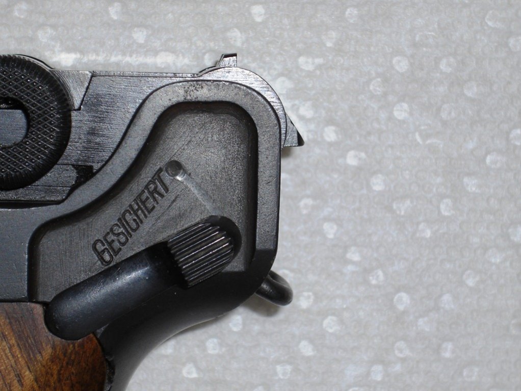

The "PO8" should be on the left side flat of the frame just below the knurled finger grip of the toggle and the "Mauser Hump" would be at the very rear of each of the frame ears.

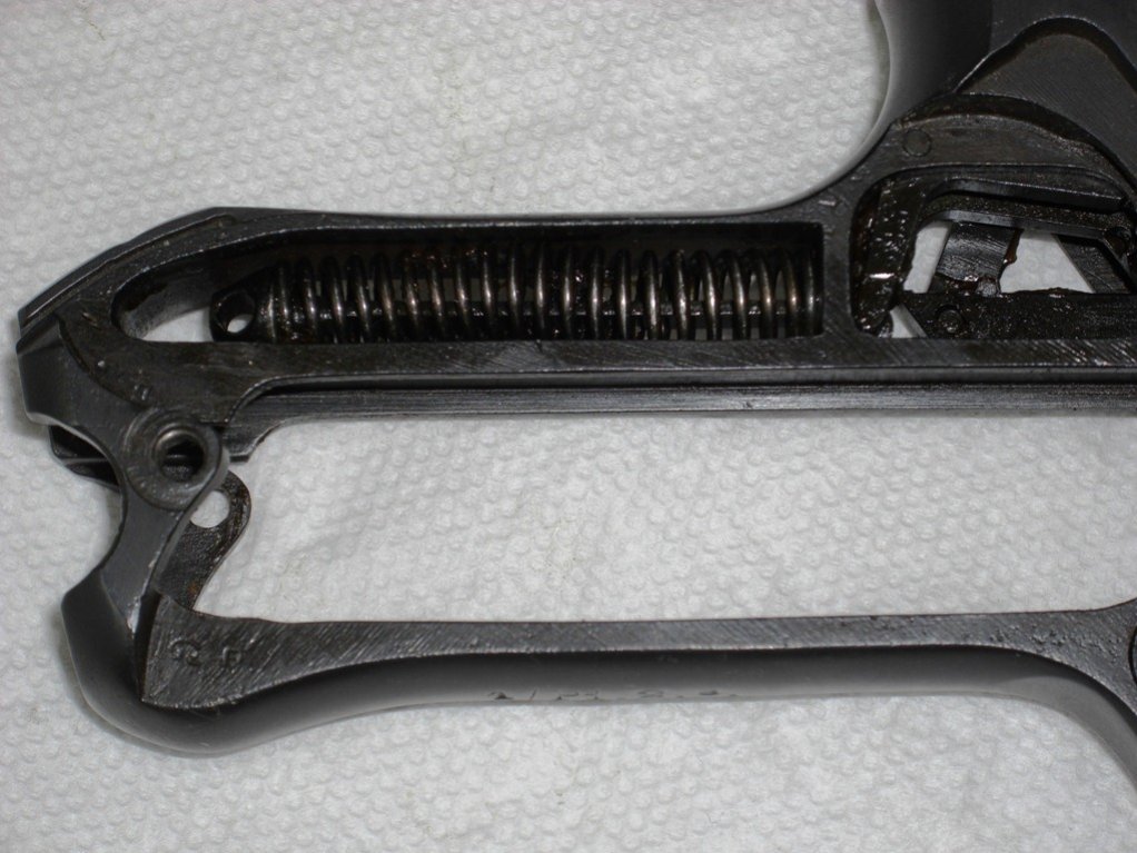

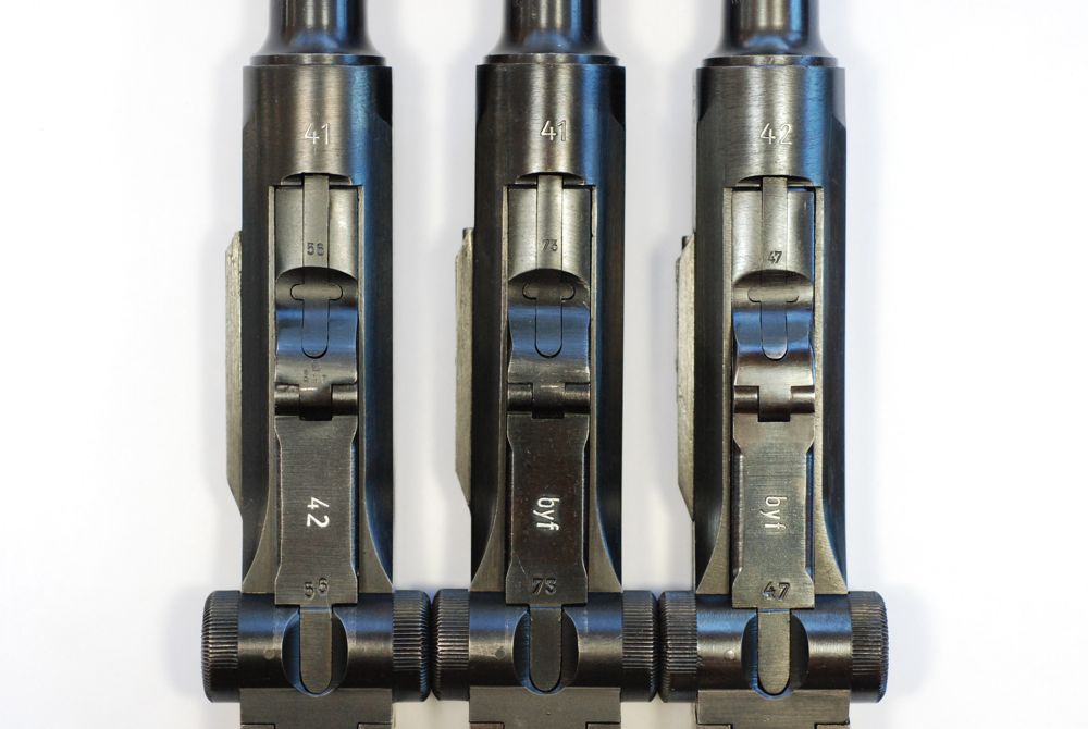

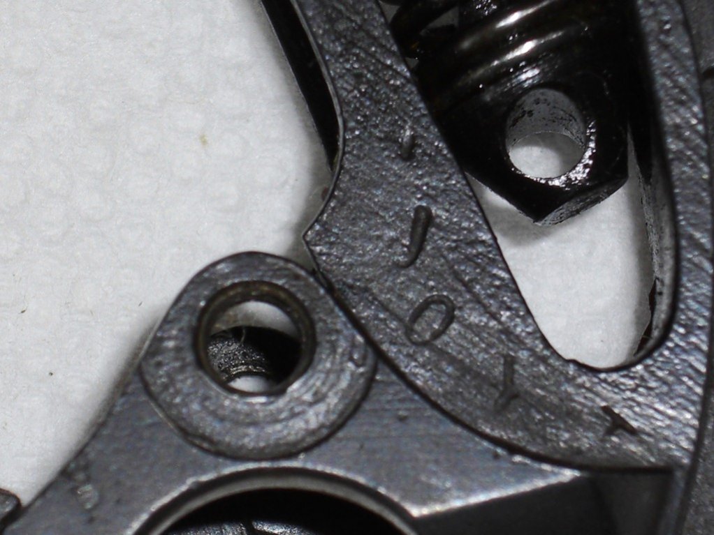

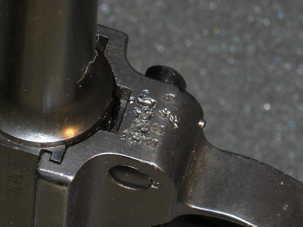

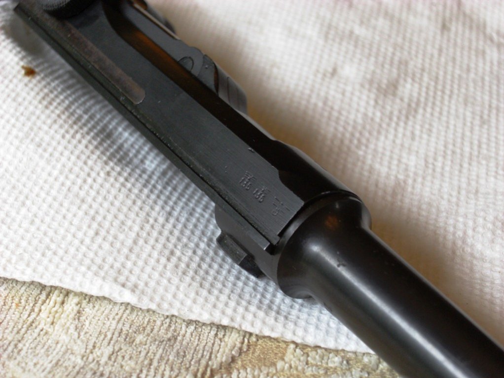

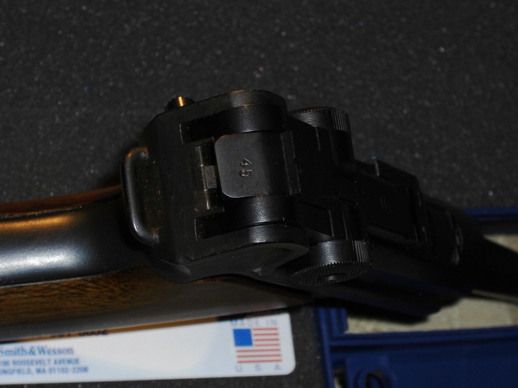

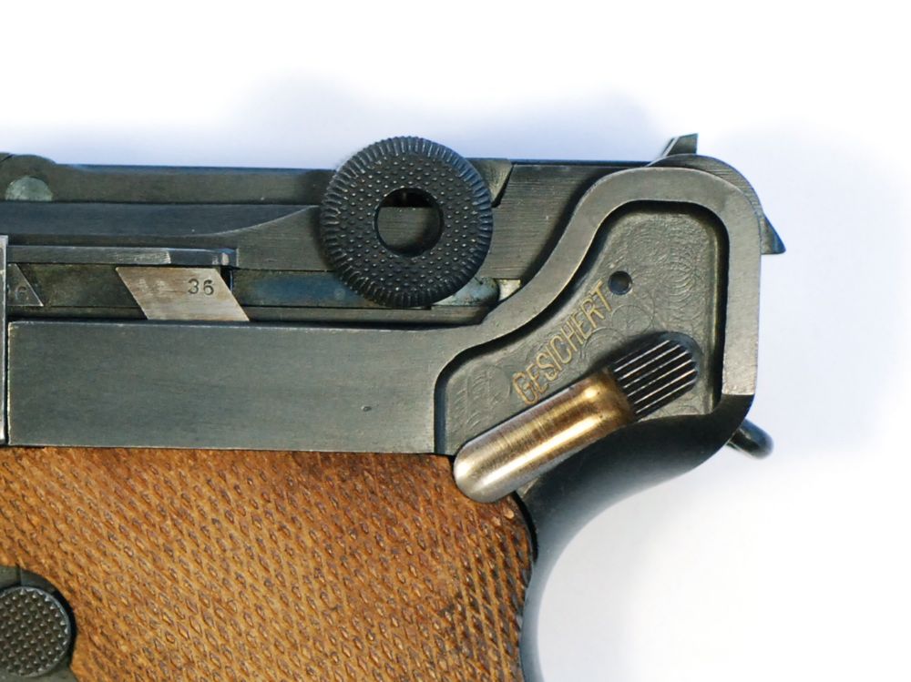

Hi Rich, Thanks for those additional photos, unfortunately they don't quite show the area I'd like to examine. For your benefit, and for others that are confused about the Mauser "hump", here is a short primer.
The original P08's made by DWM and Erfurt in WW1 had frames that looked like the first photo, at the back. The P08's produced by Mauser and Krieghoff from 1934 on, were lengthened 1mm at the back, to prevent the rear toggle pin from drifting leftwards at full recoil and jamming the gun. This was necessary because of the hotter ammo in use at the time, see second photo. In 1937, Mauser, for reasons known only to themselves, started milling away the lower part of the frame rear, thus forming the "hump", third photo.
Back to your gun, Rich. I believe it has a DWM frame, renumbered to match the 1942 Mauser top half. Best regards, Norm

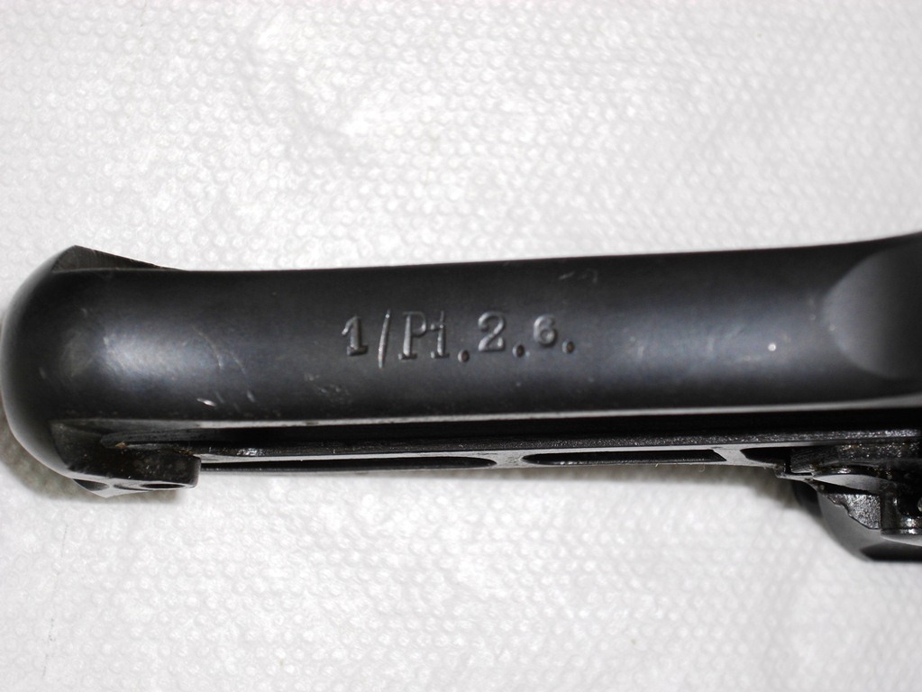

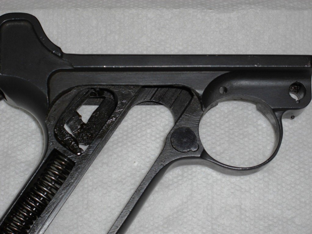

Now I understand, here is the photo you wanted. What do the characters on the front grip strap indicate, 1/P1.2.6.

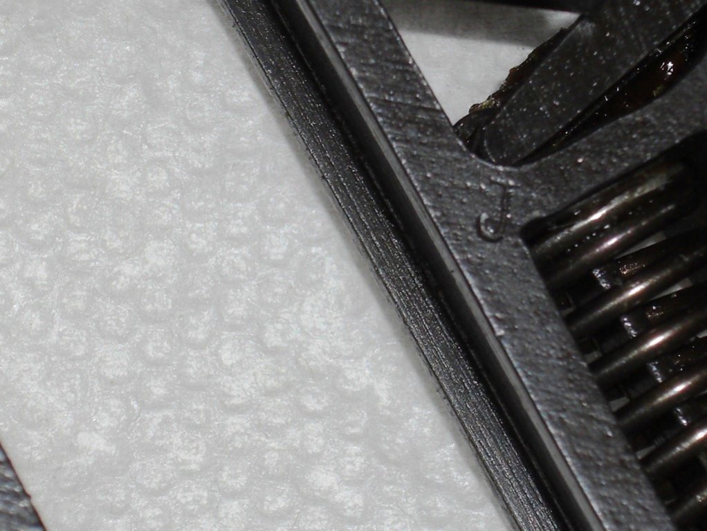

Rich, while Norm didn't say why he thinks your frame is one made by DWM, I agree with him. If it had been made by Erfurt, there would be a proof mark stamped on the front of the trigger guard below the serial number. Erfurt stamped just about every part with proof marks including the grip screws. DWM was much more conservative.

I am curious as to what others think of the chamfers on the sides of the toggle...Do they look 'enhanced'???

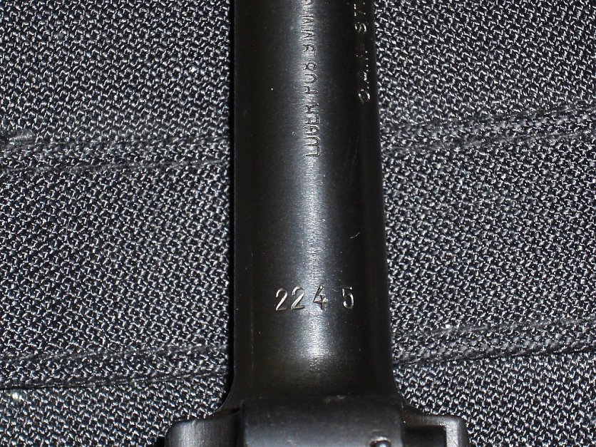

Please show a clear photo of the marking on the bottom of the barrel. This is the import mark. Many imported guns were renumbered before importation by the seller (Perhaps east germany) in an attempt to get a better price by forced number matching... Show us the mark and we may be able to shed some light on the gun's import date.

Default Barrel photo
See if this will do.
richie301 is offline   Reply With Quote
Unread 08-10-2011, 09:15 PM   #17
So, the importer is Century Arms, Inc... Perhaps from the batch a few years ago?
Is it a VoPo RC with the s/n renumbering done there?
The magazine looks late, not period. Was there someone in Mexico making them a few years ago?
If this shoots well (and you should verify this before acquisition) it should satisfy your need for a shooter Luger.
