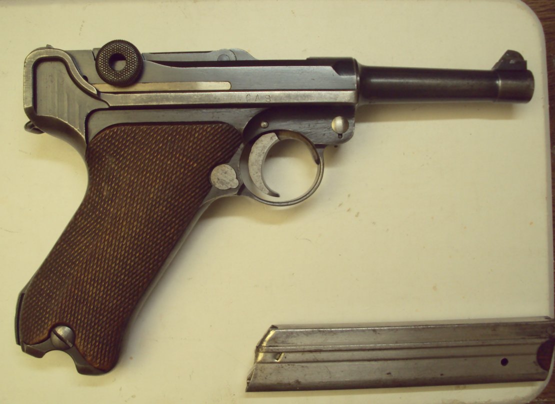

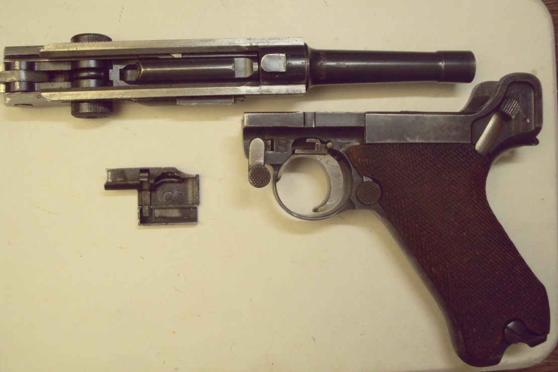

1920 com luger 8.jpgThis is my first post in the Luger forum. The first place of business is to complement the senior contributors in the forum. I have been associated with firearms for over fifty years and have never seen a more brighter group of people, there work and contributions to this firearm forum are monumental. I have only two Lugers a DWM 1920 commercial #82649 no suffix and a 1937 S42 with capture papers and German Binoculars bought from a gun show about three months ago serial #4326 Z suffix and will send pics later. The 1920 commercial Luger was purchased from my friends gun shop about two years ago. The 1920 commercial Luger has matching #s with the exception of the magazine hold open catch is a replacement it is numbered 88. The Luger has all the right crown N proofs as I can see. The bluing seems correct rust blued in the white interior. The inside of the grips are not numbered. My profession is a Gemologist so quality marks, hallmarks and stamps on metal and how they were applied I am very familiar with. The anomaly of the 1920 Luger is a CAS or GAS that is stamped on the frame rail of the piece. Using a Meji stereo microscope it appears that the stamp
was placed quite some time ago. The same style S is stamped on the frame under the grip panel. Unfortunately someone ruined the wooden magazine base on the original clip. Any additional information would be helpful

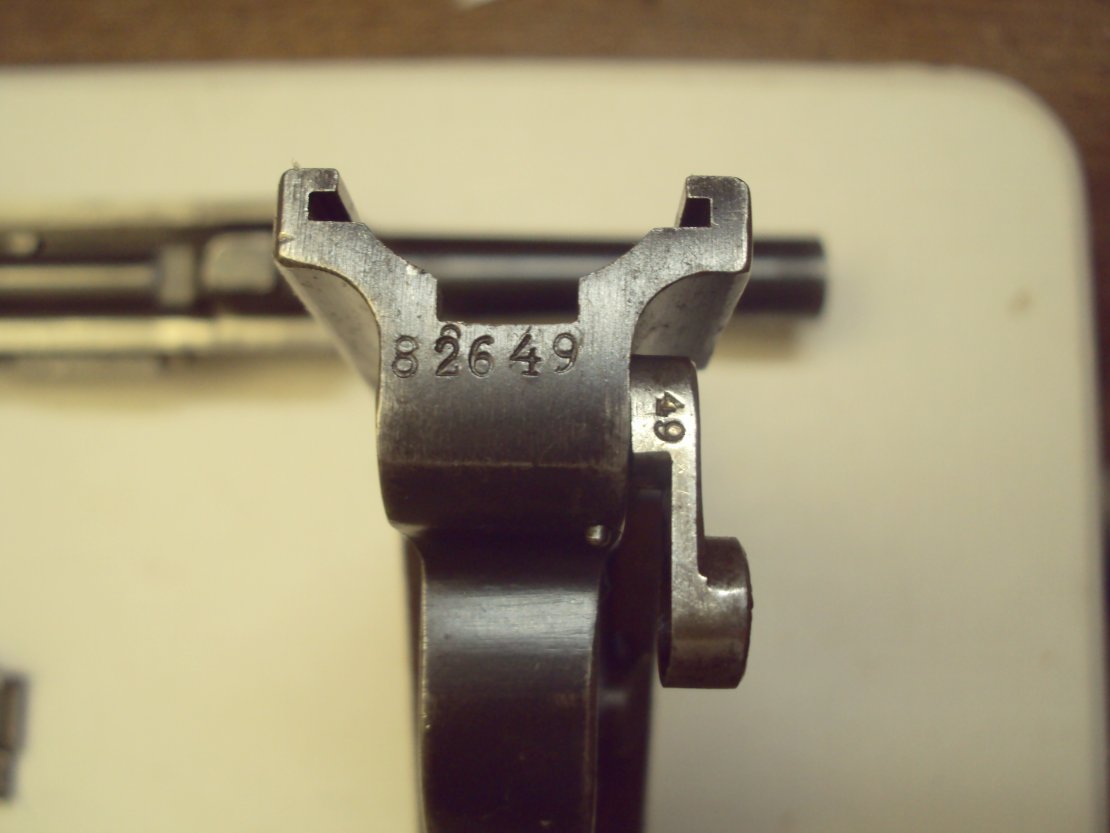

If you are familiar with stamps/application then you should be suspicious of the frame serial. I have two commercial Lugers plus one Army-issue; all have symmetrical numerals. No "added-on-later" look. The '8' in your serial does not look original...My two commercials are a 4-digit and a 5-digit. The serials are centered on the frame.

Hi Chevis, Welcome to the forum. Your Luger's finish appears to be original, but as Rich said, the frame serial number appears to have been re-struck. The 49 on the frame is clearly a different font than the 49 on the take down lever. How about posting close ups of the proof marks and other numbered parts? Regards, Norm
