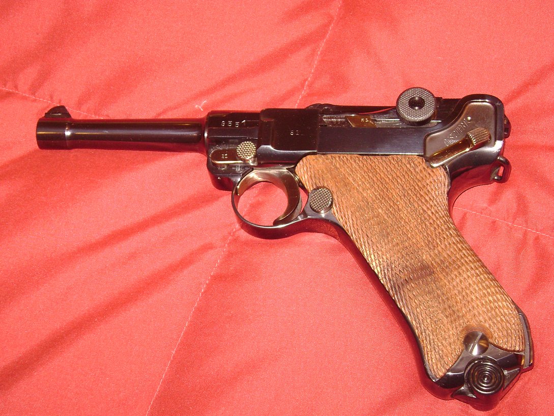

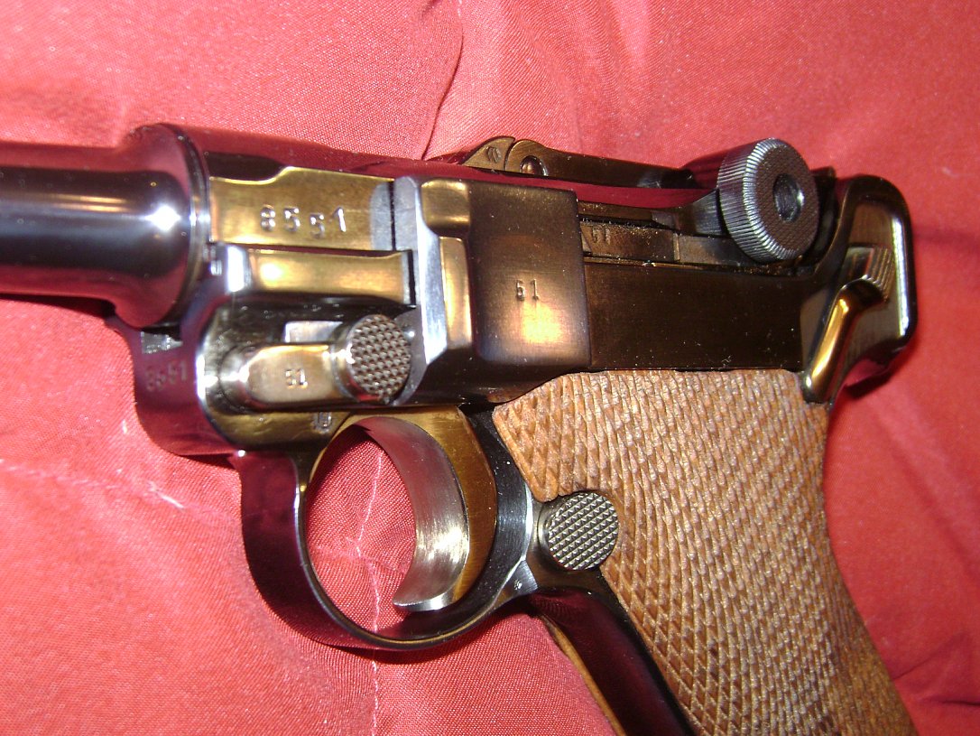

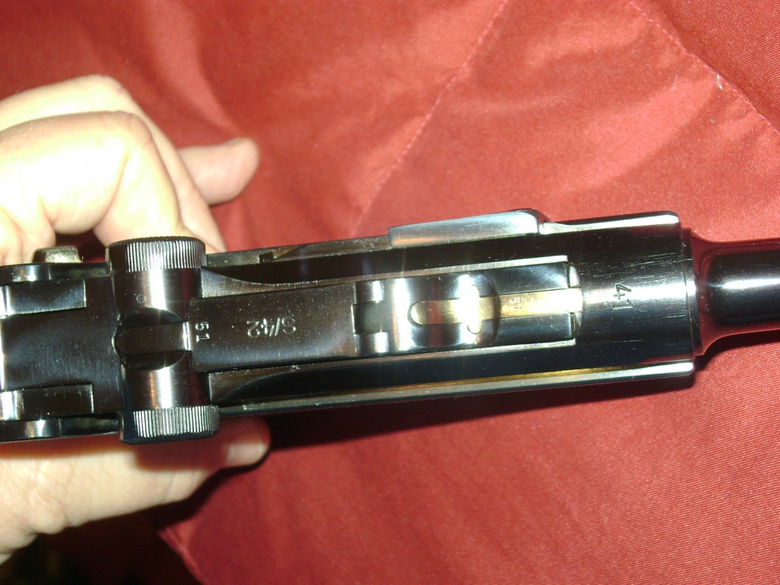

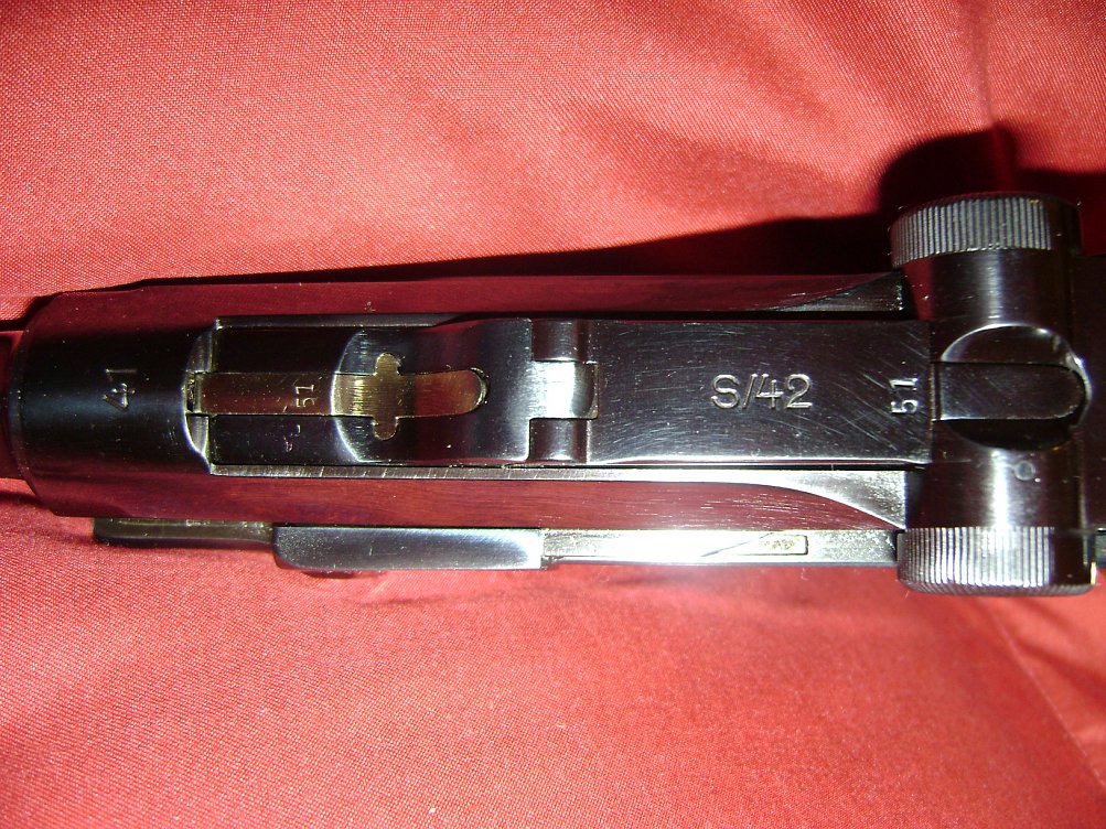

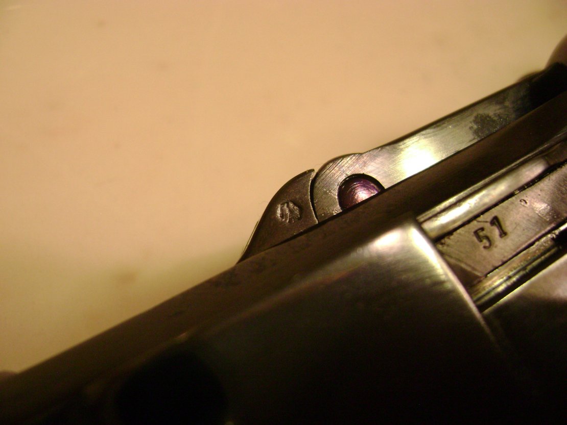

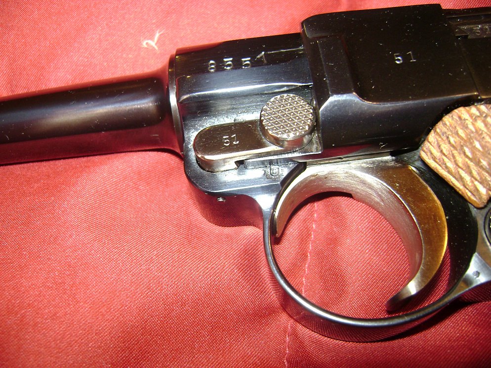

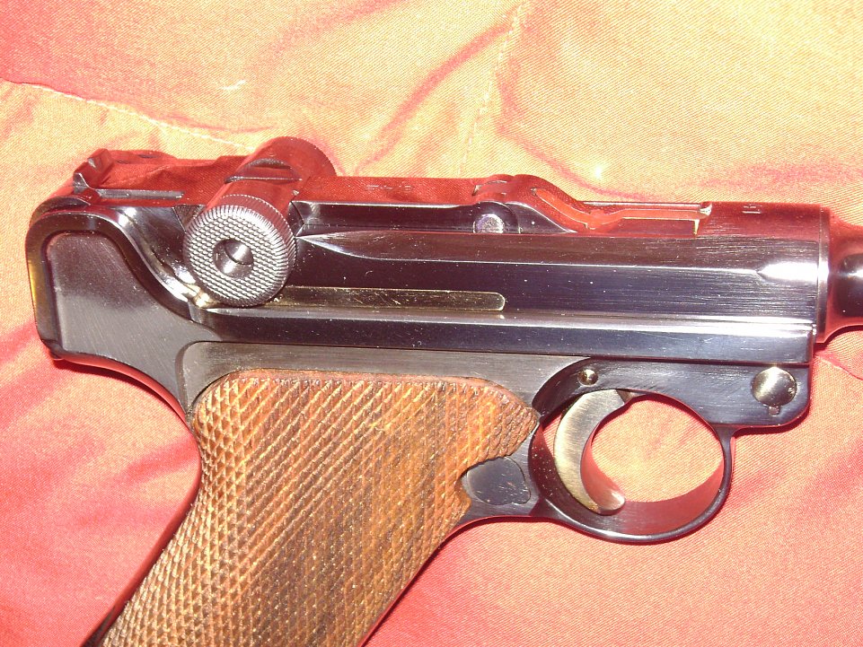

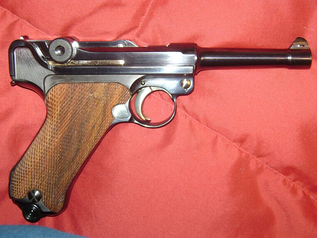

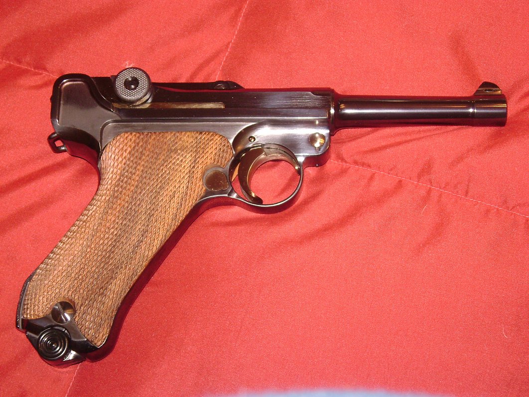

I have owned some Luger pistols in the past; the last one was about 20 years ago. I recently began looking for a Mauser Parabellum. Naturally a search like this leads to other things. Tonight I wandered in to a neighborhood gun shop a half an hour before closing. My wife and daughter were with me. I saw this Luger lying in the bottom of the cabinet with some other used stuff. I could see that it was mirror refinished and re-strawed. I asked to look at it. It looked nice enough and the price was very reasonable on it; much to my family's dismay I said, "I'll take it."
It is a 41 S/42 with a 4-digit serial number. I have not disassembled it but the numbers I have seen thus far match. Obviously the clip and grips are reproductions. I am buying it to shoot.
The restorer did an excellent job. The corners of the metal are not rounded. The Nazi proofs were completely removed from the right side of the receiver. That is fine with me. The restorer also chose to straw the trigger, take down lever, safety catch. magazine catch, ejector and also the extractor. It is not how a 41 S/42 would have looked originally, but I prefer straw for the small parts.
The only question I have is regarding the small proof mark below the take down lever. What is that?

Jim,
The mark is a VoPo East German Police property mark. Possibly the reason that the Nazi proofs are gone. They were most likely peened out by the Russians or East Germans. The person who restored it probably just draw filed what was left of them off.

Hi Jim, The S/42 Mauser code was last used in early 1939. Your 41 S/42 is an anomaly, either out of sequence production, or, more likely, assembled post war from parts from different guns. Regards, Norm

Hi Jim - Congratulations on your new Luger!
As Norm mentioned, your Luger is most likely assembled from parts of different periods.
By 1941 (actually during 1937) Mauser had added small extended "humps" to the top rear of the frame ears. Your gun doesn't appear to have these.
That means that the "41" dated receiver couldn't have left the factory with your frame.
The re-finisher took great pains to fire blue the parts that would have been that way before 1938. 1937 was a year of transition. The hump was added during that year, and the finish was shifted to complete salt bluing that year.
On military Lugers, there is generally a suffix letter below the serial number on the frame, on the front of the trigger area. You don't appear to have this suffix.
There were two periods during Mauser manufacture of Lugers when they had a block of guns without letter suffix. 1937 was one of those. My guess is that your Luger frame was from 1937.
The "S/42" on your toggle also corresponds to the typography that was used in 1937.
Your "41" dated receiver was probably the "donor" part during the rebuild. That partially accounts for removal of the firing proofs, and appearance of the serial number stamped into the left front of the receiver (which may be engraved rather than stamped).
I can't see the bottom of the barrel. Does this also have your serial number stamped in it? Does the witness mark lineup with the receiver?
Try taking your photographs without flash, in indirect even light. It will make it easier to evaluate things.
Someone went to great pains to make this appear to be a pristine all matching Luger. The presence of the toggle's axle retention pin (which appears to be still in the white) makes it possible that the train is in the original finish. It is rather well done work!
VoPo Lugers usually had obvious refinishing work. They also should have entered the USA with importer marks. If these are not present (sometimes they are under the grips - be very careful if you remove the grips; easy to break, particularly the left one at the safety lever) it's possible that they were removed when the gun was refinished to increase it's value. That, of course, would have been a federal "no-no"...
I would like to see a closeup of the serial number on the front of the frame. Is the second digit overstamped? I have a 1936 that has a serial number factory overstamped in that area. Would be interesting to see if that happened again.
The barrel does not have a serial number on it. You can see where 8.81 was polished down. The bore is nice and shiny. It is probably a replacement at some point.
The restorer STRAWED the axle pin!
I will try and take some snapshots outside in natural light in the next couple of days so we can get to the bottom of all this.
On the underside of the receiver corresponding to the chamber area it is marked "9mm para" with an East German proof mark like the one under the takedown lever.
I don't know what a witness mark is. But there is a little notch on the barrel and receiver that line up.
I noticed in taking it apart the the hold open is serial numbered 32, which is umatching.

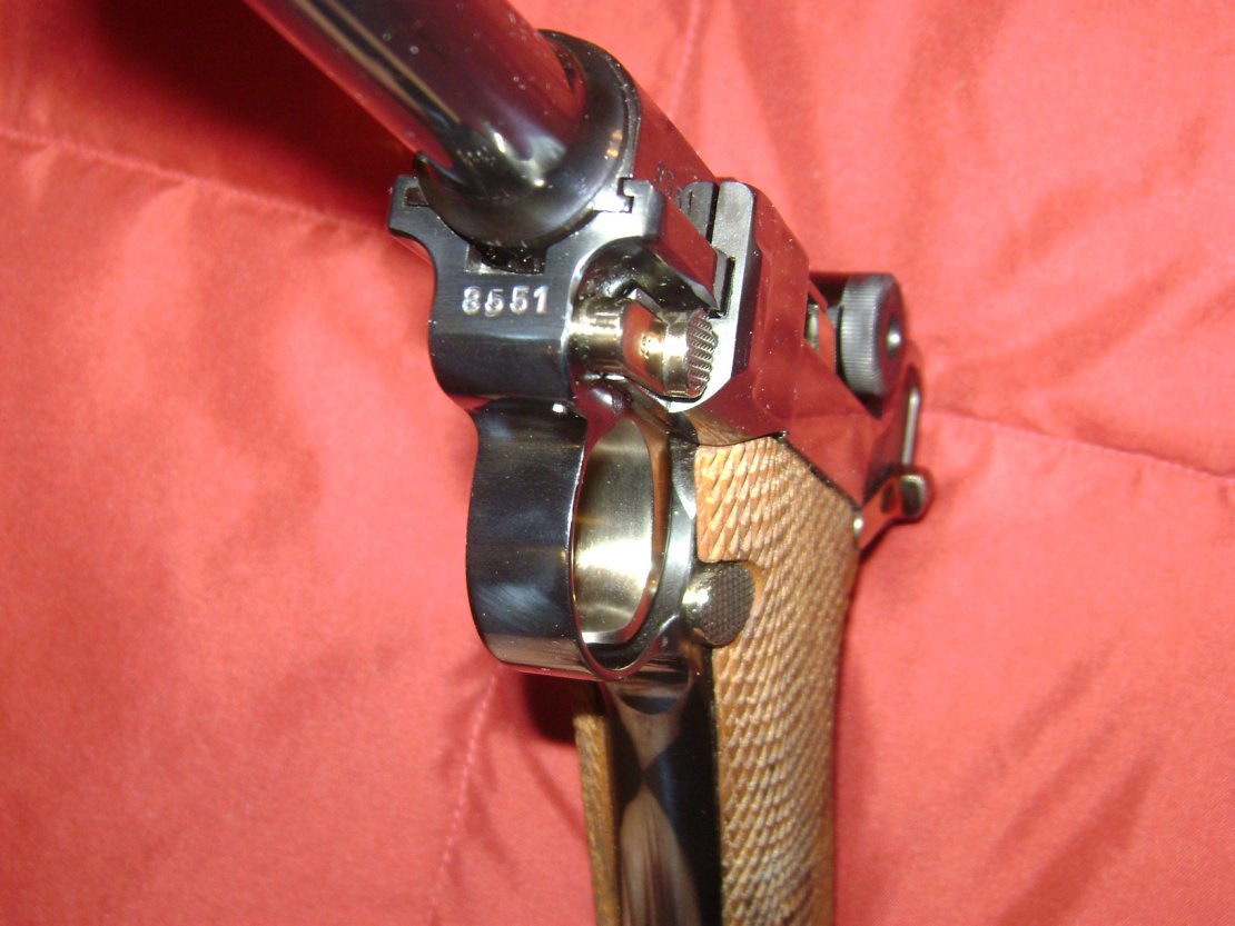

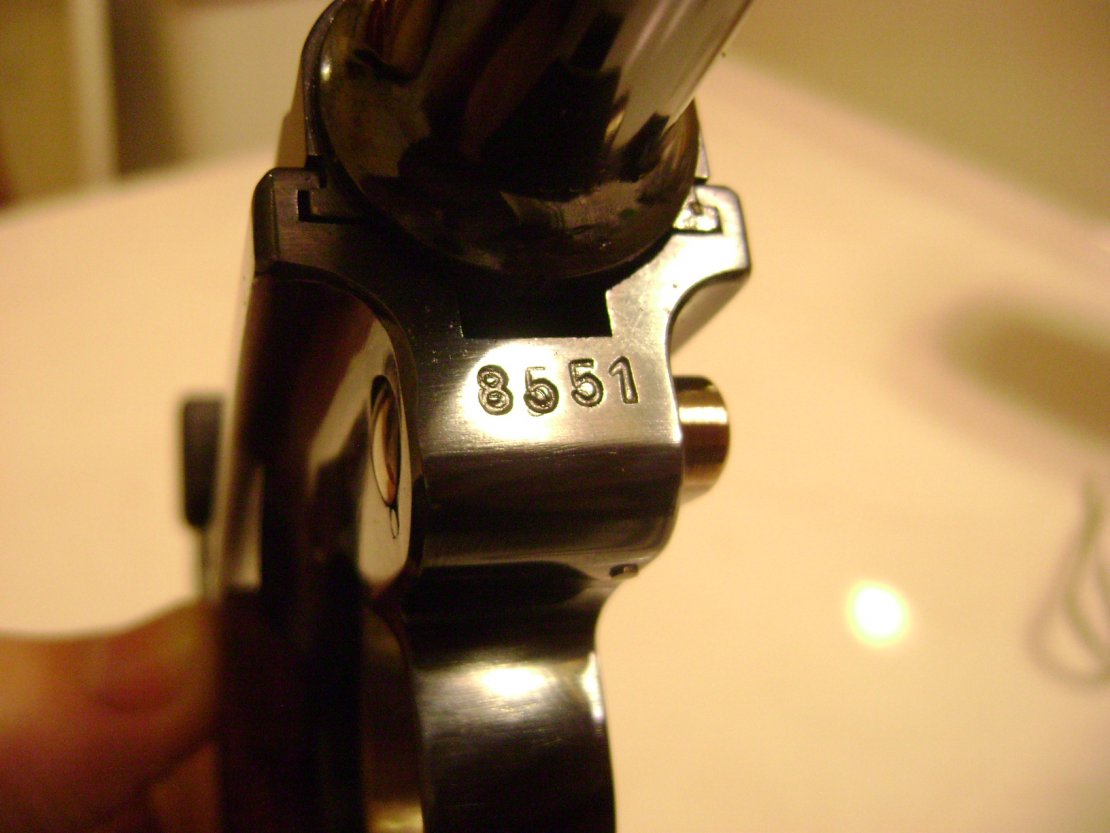

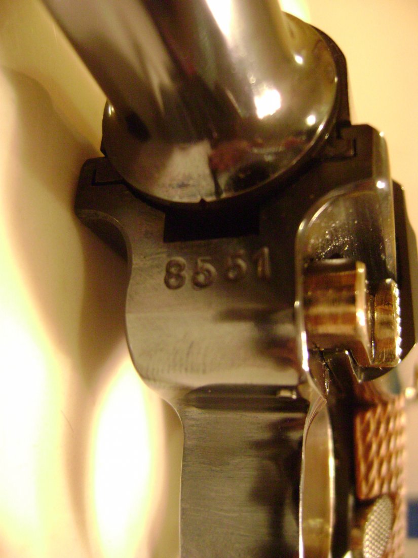

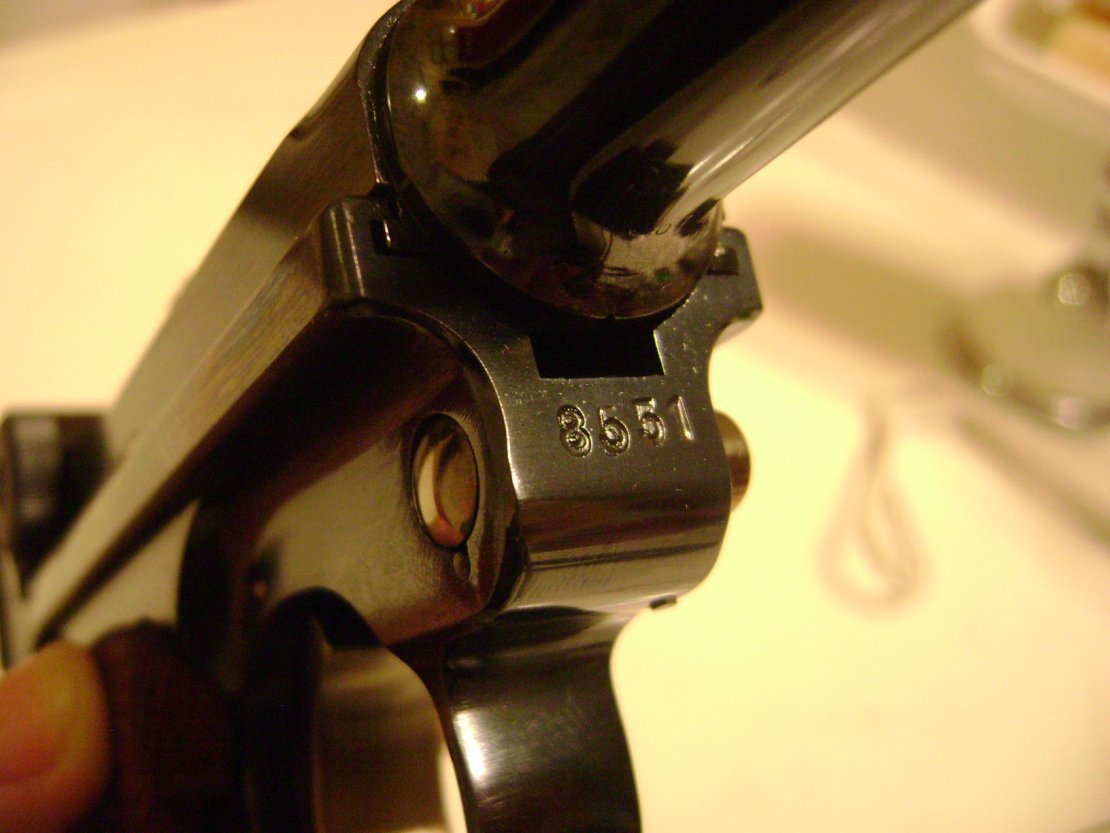

Here are some snaps of the front of the frame.

I also like it. Someone took a lot of time to refinish it. It may not be period correct, but it reflects what I would call a "labor of love"...
The grips appear to be one of the better reproductions. Some of the poorer repros leave a gap in the top left grip, where the grip fits under the sideplate...Others have a much finer checkering line spacing which just doesn't look right...Yours looks just the way it should...
A refinished Luger like this, mismatched & refinished, would still sell (and quickly) for at least $800 at the local [WNY] gun show...and quite likely more...

Jim,
Thanks for posting the CUs of the serial number.
It does look like this was overstamped, and it might be in a way similar to what my 1936 looks like.
In my case, they had stamped one of the digits in the wrong order, then corrected the error with an overstamp of the right digit.
Unread 11-25-2010, 12:02 PM   #16
Marc, Nice looking shooter. Judging by the alinement of digits on your frame serial, I would guess that it too has been renumbered. You might want to try a new Mecgar mag (instock @$35) and new HO spring @$25, to see if these solve your funstion problems. If not, I also repair lugers and find the one that are not matching factory original, usually have some problems. TH
