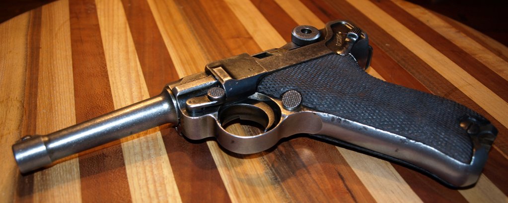

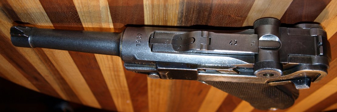

I've always wanted a Luger. Picked this one up from RGUNS as a shooter. This was sold to me as a non-matching WWI for $699, but the date is 1937. I've tried to research the marks on this thing to determine its history. I've read that these were Soviet captures?
One question I do have is that the takedown lever will NOT move to a completely horizontal position, probably due to the side plate being a non-matching piece. Should I bother buying a replacement or do ya'll think it'll be fine such as it is?

Your Luger is a Russian Capture "RC" Luger, as indicated by the X following the serial number. This is a Russian propery mark.
The Russians captured 100s of thousands and kept them in reserve , without regard to matching the parts. They mixed and matched Imperial and Third Reich components. As long as it worked they didn't care about matching it.
Rather than buying another side plate, use a small fine-cut file to thin the side plate tang. A little at a time, just enough so that the take down lever will slip into position with some resistance. Use 240 grit paper to smooth it up, touch-up with cold blue.

Welcome and congratulations. This one is definitely a WW11 Russian capture. Looks like a few mismatched parts, but you did fine on the price.
I wouldn't shoot it until you get that side plate and takedown lever straight!
