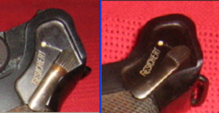

Dear Sirs,
I'm writing from Brazil and I would like to know if it's possible to identify the Luger shown below?
It seems to be a DWM 1914 military Luger, but I am not shure.
Is it original? What is the condition and value? Could it be considered a collector's gun?

Hello, Paulo
It appears to be a DWM 1914. It also looks like it had been refinished.

Paulo,
Better pictures now. A good looking piece. What is the full serial number? Read this off the front of the frame, just under the barrel. Numbers, and possibly a letter. There should be the same numbers on the underside of the barrel. Here too some smaller numbers, 8,81-8,86 which is the bore diameter land to land in mm. Also, I can not quite make out the inspection stamps on the right side of the receiver. Looks like a U, then ?, ? and then the acceptance stamp. Take a look on this forum under "technical information", and see if you can identify these letters.
What makes me think it may have been refinished: On the top of the left toggle knob is the head of a small retaining pin. This should be in the white, or bare metal. It looks blued in the photos. This often happens during a refinish.
Another clue is what is called a "halo" round some numbers. These on the barrel, top the extractor, and the back of the toggle after the DWM logo. If refinished these halos will not be evident.
Are there any letters/numbers stamped on the grip straps, front or rear? Does the crown eagle (C/E) on the right side of the reciever match the one on the left side of the breech black? The one on the receiver looks like the Erfurt mark?
FN

I think that is a Mauser frame with a DWM top, so collector value is lowered. Very nice looking gun though. Thanks for posting!

Ahhh... I missed the hump. Thanks, guys! I think a Mauser frame, Erfurt receiver group, DWM toggle group.

Morning Paulo,
It could be a good 'First Luger' if the price is reasonable. You'd learn what to look for and what things should look and feel like. My first was a byf 41 with at least 5 different numbers on the parts, but it shoots great! In the USA, this one would have no collector value, but as a shooter would be in the $500-700 range, I think. Brazil, though is a different market, so I don't know what the value would be there. They are fun to shoot. But be careful with the ammo. Modern ammo is different. Read all the info under the heading "Shooting and Reloading".

Norm says it all: a parts gun.
