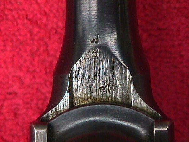

Regarding R/W, it's not singular. Here is another example, Mauser s/n 920498 Selbstlade, which is also the Mauser with biggest s/n that I've seen so far. I don't have Gun Report at hand.... if I remembered right, this is also not far away from the biggest s/n that has been observed by Schroeder. It's circa 1939.
I would believe it's a subcontractor mark. There are a few types of mark on this position, "M" is common, probably means Mauser made barrel. "S" is also observed on late 1930 barrels. WWI era six-point star, etc.
Please note the R/W on this barrel:

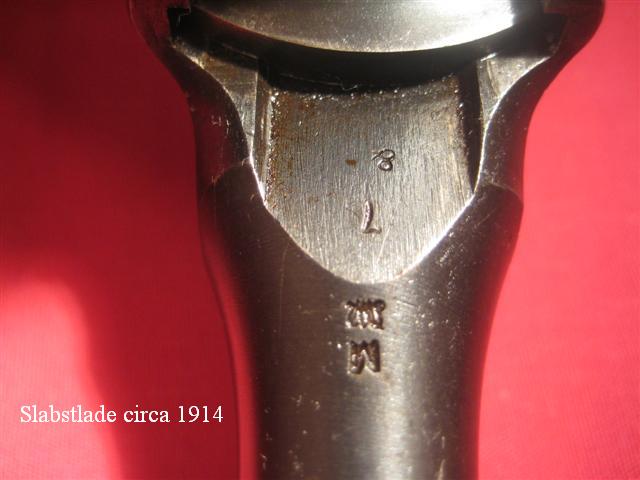

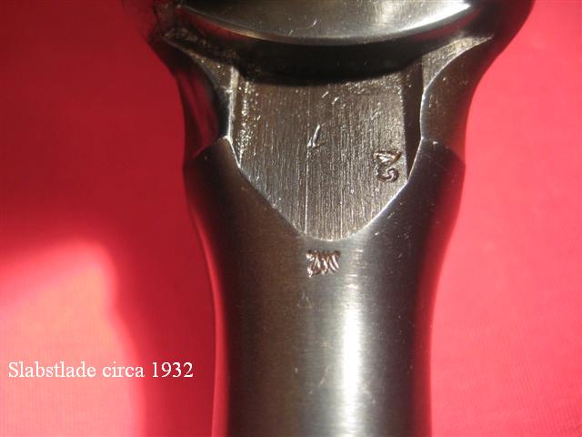

I would say it's not M. It's a curved W. And, W and R always go together. I have never seen one with R alone, or that W alone. They always go together, and always in this relative position. Most likely, it's a single stamp, not two stamps.
Please also see the following two examples, and note the M over something on the typical prewar instance -- something might be another stylised M, and the stylized M alone on a later postwar example.
Now, here is my question: does that "something" (assume it's a stylised M) also appear on Mauser made Luger?

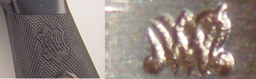

I checked that "stylised M" on slabstlade under 3x loupe. The more I look at it, the more I feel it's not a single character.
It's monogram "WM", i.e. Waffenfabrik Mauser. Looks very similar to the WM monogram on some rare plastic grip panels of this type of gun.
Let's assume it's "WM". Then, that stamp is more likely being the maker ID of the barrel.
I will take a close picture of that stamp, and a picture of the WM monogram on Mauser grip..... hold on.....
If this is true, then R/W on Luger is also supposed to be parts maker ID.
Grip picture stole from a gun listed on FGS website which has WM monogram grip. This camera .... no matter what I do, it can only perform this.... hopefully good enough:

Alvin, it almost looks like Mauser was trying to mimic the DWM logotype.
Just speculation, but I wonder if WM could relate to "Weimar Mauser" and "RM" to "Reich Mauser" or something similar...
If the RM inspection mark was used in 1938 through 1941, it's possible that the Banner Mauser forward toggle was a left over from a prior manufacturing run, and used for a military contract gun when "byf" parts were unavailable.
Are there any known examples of this?
Unread 03-04-2010, 08:18 PM   #12
No. "WM" stamp of same style not only appears on post WWI gun, it also appears on pre WWI gun.
The earliest "WM" grip that I have seen is on commercial flatside Mauser, circa 1900. The last WM grip that I've seen was on so call French Gendarme variation, circa 1919.
No Weimar on guns. The official name of the postwar republic was not Weimar. It's only a nickname used by historians.
A clearer picture of WM copied from Hermann Historica:
