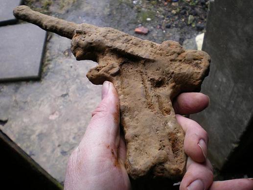

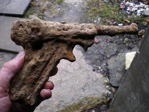

Hi all,
This is my first post, so please excuse my lack of Luger knowledge as I am not a firearms collector but have some interest as this area is directly allied to my main interest of military history. I found this Luger on the WW1 battlefield of the Somme, and it remains in France, and I am trying to find out more information about it, including:
1. How is the best way to clean it up with a view to finding markings etc?
2. Can it be deactivated and by whom (I will not attempt it AT ALL)?
3. Is it possible to have a bullet in the chamber as well as a full mag?
4. All the grime on the piece noted, is it possible to tell what the manufacturer is from these photos?
basically, I am fascinated by this luger pistol, so any information you can offer is welcome.

Hi,
Yes it is possible to have a round in the chamber and a full magazine, although that wasn't standard practice. With a full magazine inserted, you'll find a total of 8 round, one of which can be located in the chamber, giving you 7 in the magazine.
Although it's safe to say that this pistols firing capabilities are a thing of the past, it is good to observe some caution. The rounds themselves have brass cases and survive in the ground pretty well. The bullet jackets are usually copper washed steel, so expect those to be severely corroded.
I would suggest removing the loose dirt first, then soaking it in a bath of solvents for some time, removing dirt as it works free of the gun. A brass wire brush and some gentle brushing can work miracles.

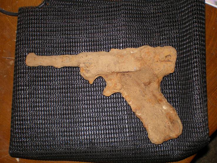

Hi... I have added a better side profile shot in the hope that it might yield info on whether the gun is loaded or not.
As on safety ... I am cautious beyond belief. I am making heaps of queries even before considering cleaning, and will not mess around with amunition. That is best left to qualified people.

Hi, the extractor, which doubles as a loaded chamber indicater is located at the top of the toggle, right after the chamber. You could start cleaning that part first, in order to determine whether the extractor is still there and in what condition it is.
If the extractor is missing (or so badly deteriorated that it will break apart), it will allow you to see part of the cartridge rim if it is in the chamber.
If the barrel is free of obstructions (or cleaned out as much as it can be), you can insert a rod into the barrel and chamber and use that to measure the total distance from the muzzle to the toggle. If there is no round in the chamber, it should be evident by the distance measured.

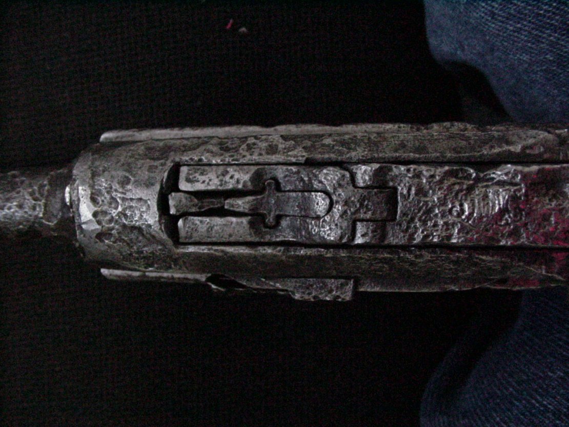

Note that on this example the extractor was broken in two pieces. I also checked whether a loaded round was in the chamber by using the rod approach. In this particular case there were only the remains of a fired steel case in the chamber. The gun is long gone, I still have the case

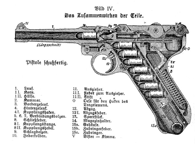

Hi,
All military P08's are basically the same. Details only differ when it comes to finish (not an issue here) and markings. All small parts, springs and the general layout of the gun are identical. It is virtually impossible to make any decent statements about origin, etc... without a couple of cleaning sessions.
You are correct that the metal tube visible through the grip openings is the magazine. It is still inserted into the pistol. The area behind the magazine houses the main spring (coil spring type).
