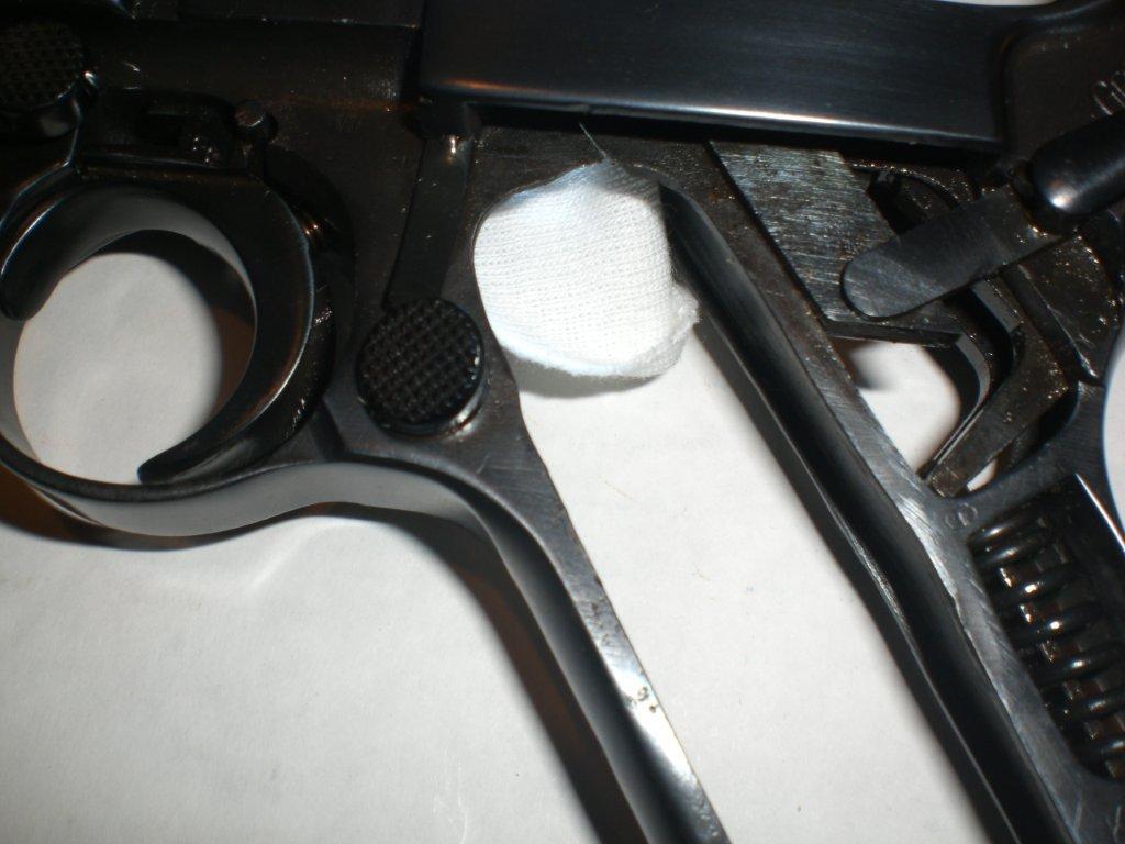

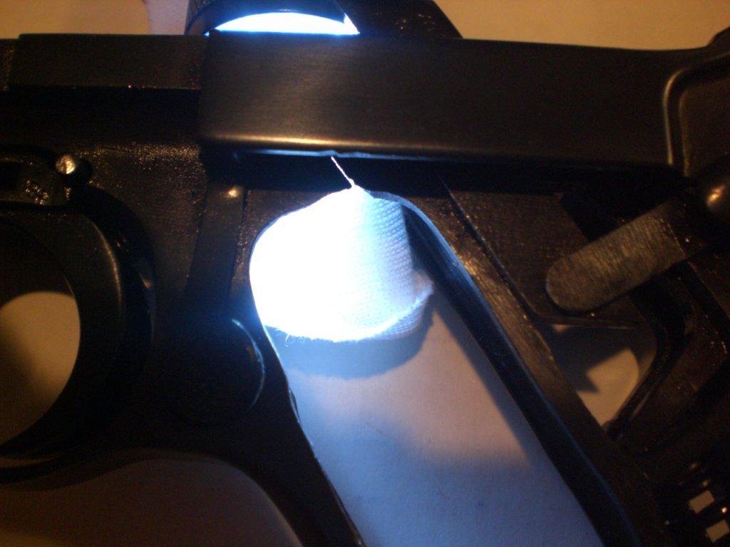

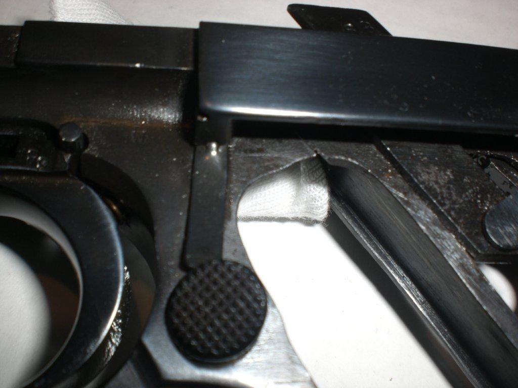

Anyway, onto the crack. Before I took it out to test fire it, I field stripped it and gave it a good look over. I noticed a crack about 3/16" long and wide enough to slide 2 sheets of newspaper into (didn't feel like looking for my feeler gages!) on the left side of the frame adjacent to where the top left side of the magazine is when it's fully inserted. It doesn't look structural to me, but I'm VERY new to Lugers and may very well be wrong. It almost looks as though at one time someone either forced a damaged magazine into it causing the split/crack or repeatedly used a damaged magazine which eventually shaved/stressed the metal enough to make it split over time. I've attached pics to help explain and show the damage. Is this crack fairly common on Lugers, or should I be concerned about it?
I've contacted the seller and he was very apologetic and is ready to refund my purchase price with shipping AND the cost to send it back to him. I'm happy with the look of the gun, the 15 rounds I fired from it (read my above mentioned post in "New Collectors") and would like to keep it, but I'm afraid that even if I can solve the functioning issues after replacing the springs, I may be stuck with a gun that shouldn't be shot.
Inputs or advice?

This crack is not normal !
I would return this gun.
It's a safety issue, too.

Hi, I think you should get out of this deal if you can. I don't know how safe this gun is to shoot - I do know that I wouldn't shoot it! One thing you can be sure of, cracks like this don't improve with time. Regards, Norm

Nope, you dont want this Luger!! This is in an area that is thinned to make room for the middle of the magazine side where it is thicker for the crimp of the magazine body. Not normal to have a crack there.

Agree with all the above. At least it looks like you purchased it from an honest person. I'm sure there is a better one waiting for you. Bill

I agree with all above - get your money back if you can. I would also note that in addition to the crack, the photo shows the frame is bent in the rear of the magazine well at the top of the mainspring housing. Something bad happened to this gun. KFS

Can you take a side shot, showing the entire grip frame w/grip & cannon off??? And a top shot, looking down into the magwell at the crack??? This would help us determine the full extent of the damage...
Looks like "something happened" in the top part of the magwell...with bad results...

Thanks for the advice guys. The functioning problems i wrote about in the "New Collectors" might have been fixable, but judging from the responses I got herewhen I asked about the crack, it is most definitely NOT normal. If I got it just to collect dust in the safe maybe i would have been good with it, but i want something I can enjoy and shoot.....this doesn't fit the bill. I will be sending the pistol back to the seller. He seems like a straight up guy and wants to make everything right.

Hi Dutch, I have never heard of a Luger cracking like this. Something unusual happened to this gun. In photo #3 you can see that the part of the frame that forms the back of the magazine well is distorted. Regards, Norm

maybe a round cooked off in the mag well

I had the same thought. This gun has been refinished and I thought that perhaps it was in a fire. After some reflection I decided that this was an unlikely conclusion: the damage seems to me to be less than what I would expect for such an event and the back of the frame appears to be stronger at that point than the front - I would expect the front grip strap to be deformed if a round cooked off. KFS

Is the barrel original to the gun? This looks like somebody shoved a rod or wood block into the magazine area of the frame, perhaps in an attempt to leverage either the top assembly off or somebody dumb enough to try to remove the barrel without disassembling the gun.
