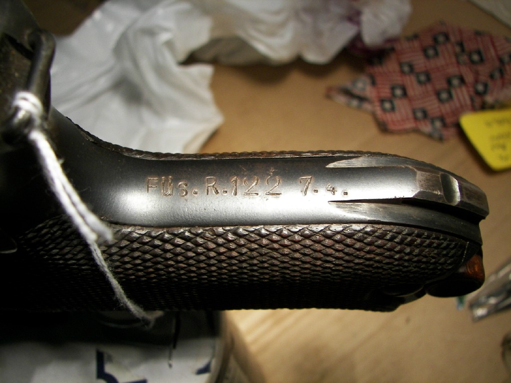

Gentlemen,
After some 20+ years, I finally found an LP that to me looks all right. It's a DWM 1916, serial # 61XX a, with a matching magazine. It came with a stock, holster, magazine pouch and harness, as well as a Type I (?) drum magazine.
It did set me back a pretty penny, but since this is probably the last Luger I'll ever buy (yeah, right) I was ok dumping around $ 5K for the whole deal.
I would appreciate your expert comments, also I'd like to know what the unit marking means.
Please excuse the picture quality, it was the best I could do in the fading daylight. I can post more pics tomorrow if necessary.
Balder

Hi John,
Füs.R.122.8.7. is Füsilier (Rifle) Regt. 122 company 8 weapon 7
That is a great unit mark , and an interesting history.
The 122nd Füs Regt. was part of the 26th Infantry Div. 1914-1915
~Divisional battle history~
1914~Lorraine-Argonne
Flanders
Russia
Poland
1915~
Serbia
Belgium
1916~ Moved to the 105th Infantry Div.
Bulgaria
Macedonia
Galicia- The 122nd Regt. sufferd 26 Officers and 1165 Enlisted casualties.
1917~ Moved to the 243rd Infantry Div. (Formerly the 8th Ersatz Div.)
Lorraine
Aisne
Meuse Hill 344
Meuse (Left Bank)
Verdun
1918~
Battle of Picardy- 122nd Regt. lost 207 casualties.
Picardy
3rd Battle of Somme

Balder, congratulations on a great LP08. If you would please share the full serial number for my records. Here's mine one company removed and a couple hundred higher serial number. I have also seen a 1917 LP08 marked to the 122nd Regiment.
