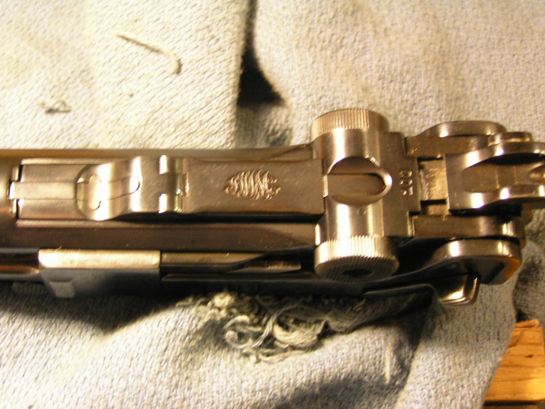

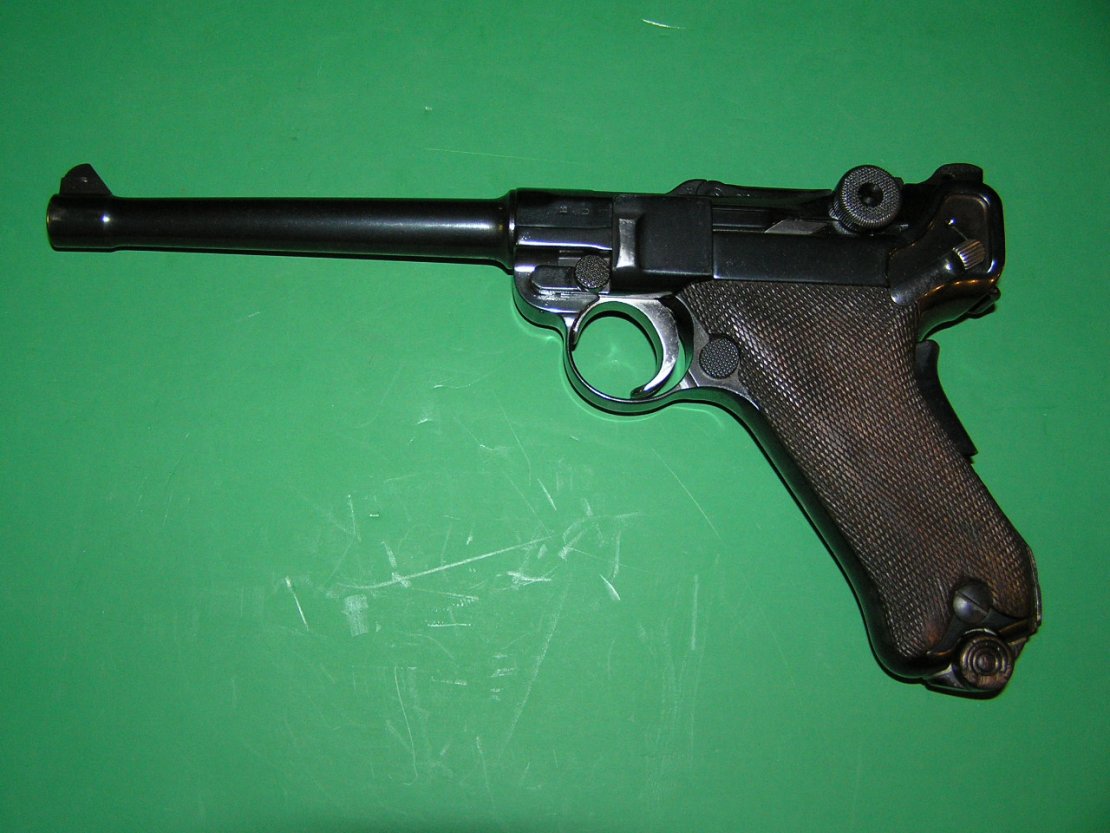

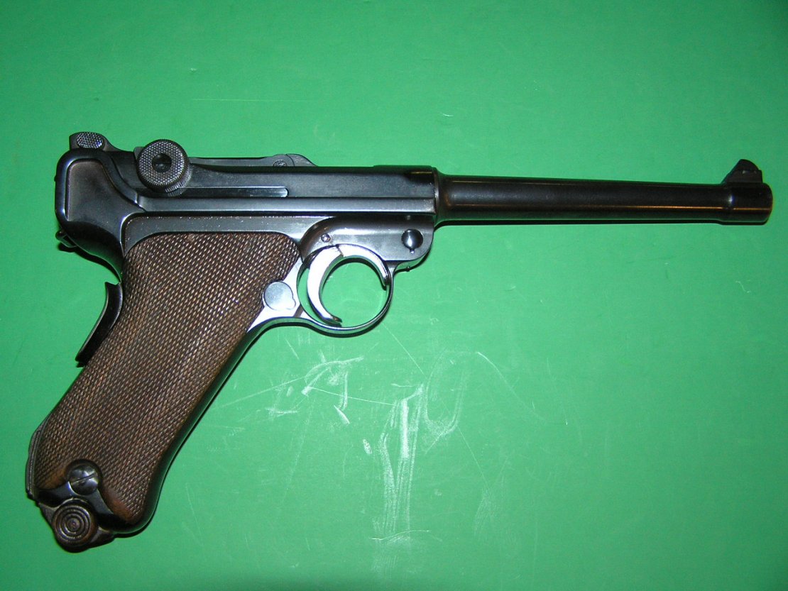

I have been lucky enough to obtain a 1906 Argentina Contract Navy luger with 6 inch barrel and safety grip. The gun was purchased new in Argentina and remained in the family until the owners grandson (living in the US) was willed the gun. It took him some wrangling, but he successfully imported it into the US. The only problem is that the gun was reblued years ago in Argentina. The guy did a good job, but the normal 'strawed' luger parts (safety lever, ejector, mag catch, and locking bolt) are blued. The trigger is silver - probably had the straw buffed off. Aside from that, the gun is in great shape - all matching parts and grips. The magazine is Navy, but not numbered? The barrel has some Spanish writing on the top.
My question is this - were the safety lever, ejector, mag catch and locking bolt originally strawed? Since it has already been reblued, I was thinking of having them strawed so it would be back to original. Any help would be appreciated.
Also, any 'rough' idea on value for something like this? Here are a few pictures.
Additional Note: I have all the paperwork (about a 1/4" stack) showing the gun being exported from Argentina to the US. What a customs mess it was!! I will post more detailed pictures tonight.

One important thing to avoid misunderstandings: there is no "Argentinian Contract Luger". The Armed Forces of that country tested the Luger around 1904-05 but never adopted it as an official sidearm. They choose first the Mannlicher Model 1905 and then, in 1914, went to the Colt Governmental pistol.
What you have here is a Commercial Navy, brought to Argentina by DWM's agent. Much more rare than a standard military Navy, as far as I know.

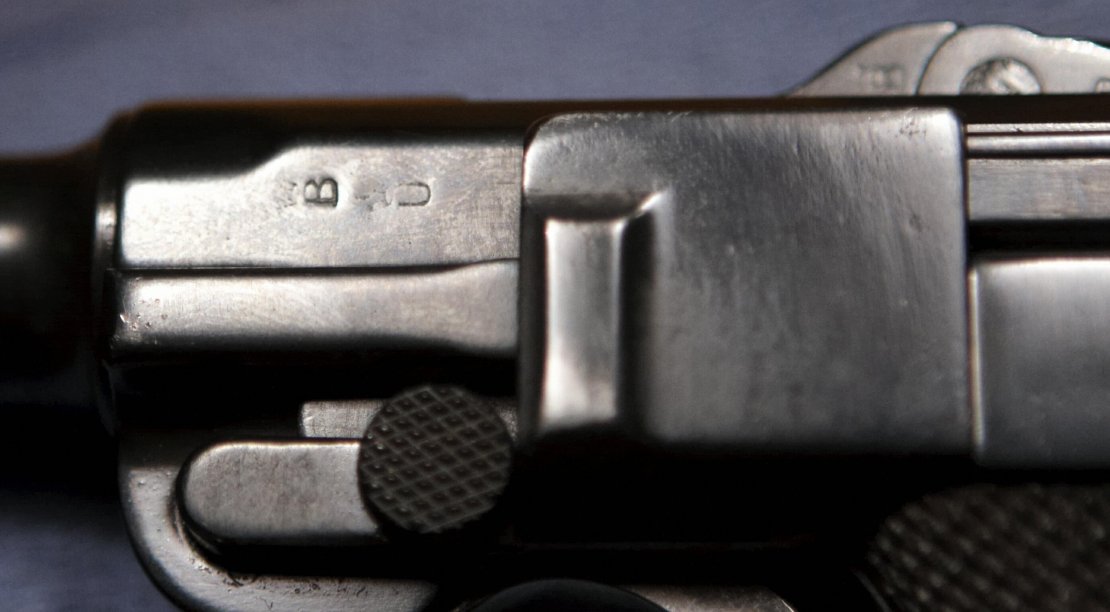

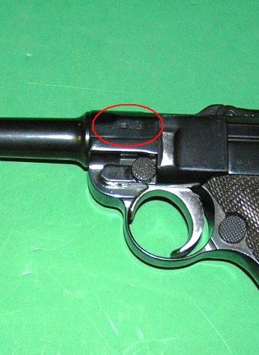

Dwight, from what I can see in the first picture, yes, the gun is BUG proofed.
Douglas.
+ 1
I am curious...Were the c/B, c/U, c/G proofs put on horizontally on all Navy's???
(Enlarged, lightened, and negatized pic attached)

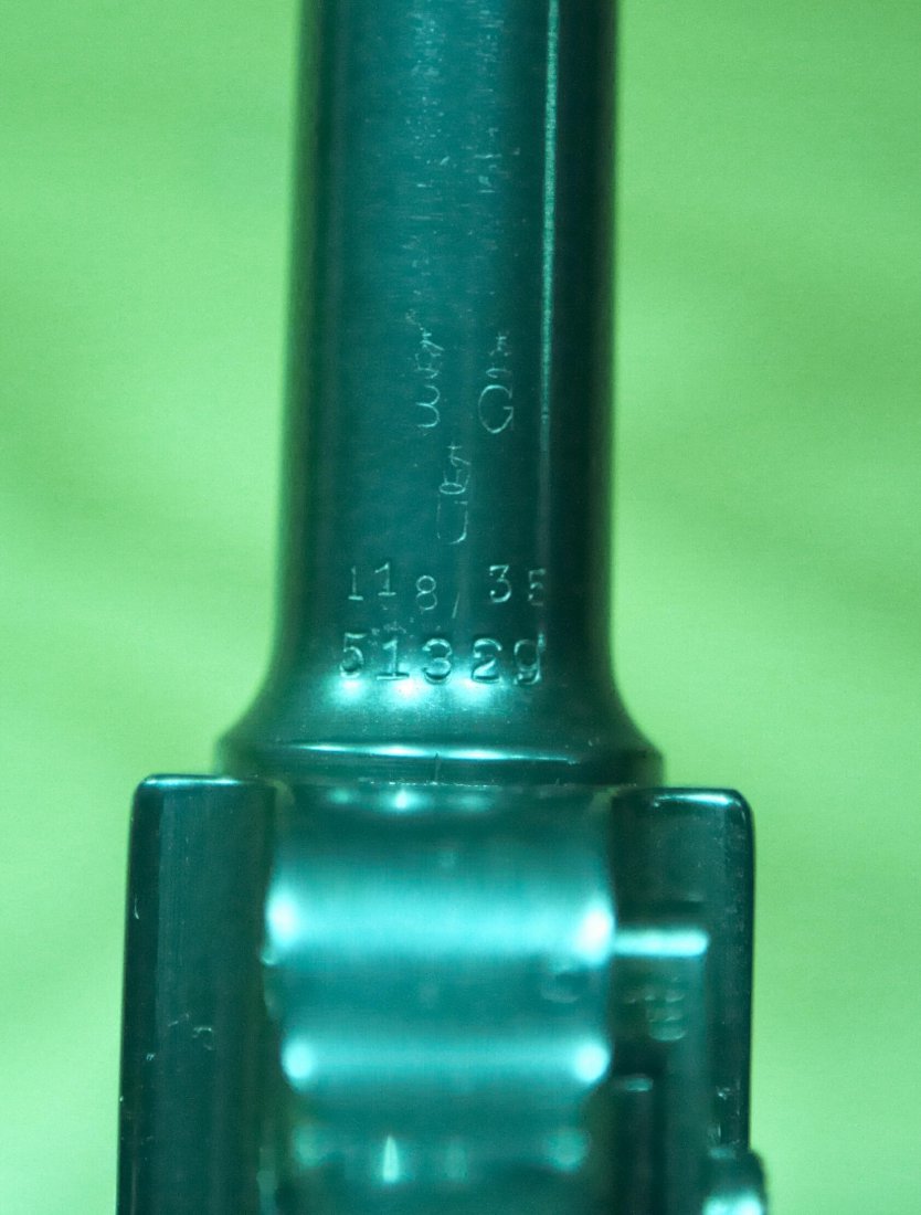

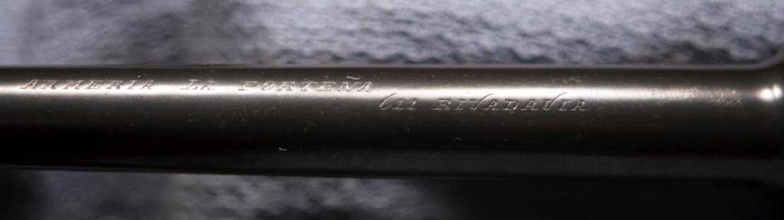

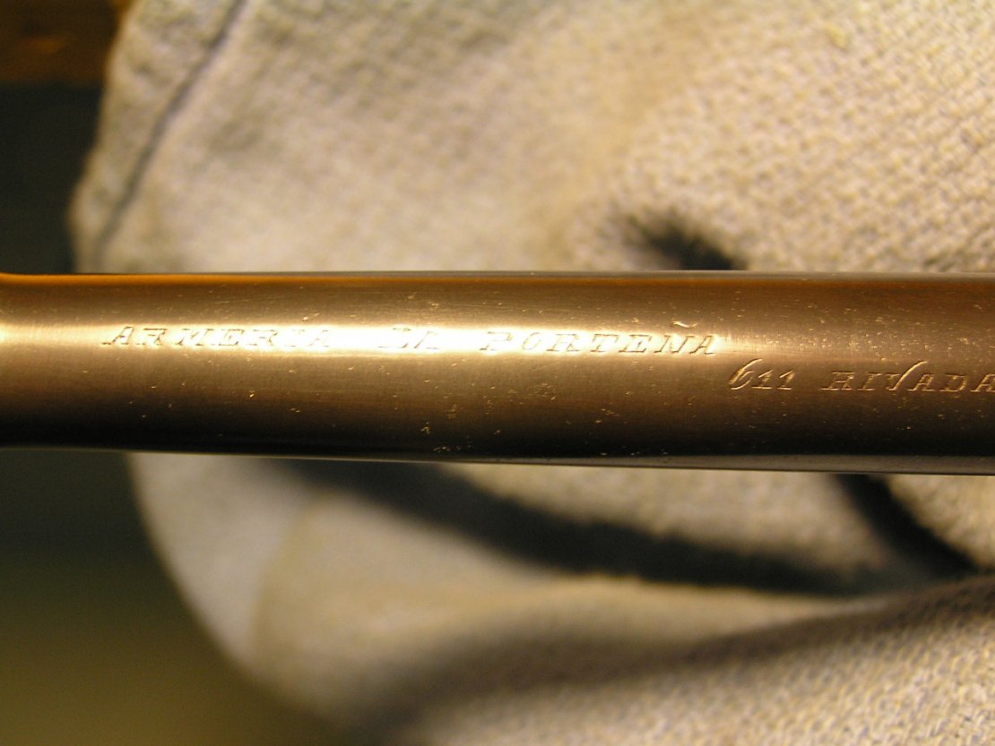

The Spanish writing on the Barrel is not a goverment mark but the name and address of an arms dealer in Argentina, (perhaps the importer, similar to the US requirements).
The glare prevents a clear reading, but what I can make out is;
"Armeria ** Nortena" "611 Hivalda" or "Northern (something) Armory,, 611 Hivalda Street."
This is just assuming that this is an Argentine dealer and address, based on the information above. The Spanish used could be from any number of countries and the gun could have started life almost anywhere in South America, (except Brazil) and ended up in Argentina.
Unread 01-14-2010, 12:47 PM   #7
Looks to me like it is "Armeria La Porteña / 611 Rivada..."

c/B, c/U chamber marks are horizontal on all DWM c/BUG-proofed commercial pistols.

Rivadavia is a major avenue in Buenos Aires.

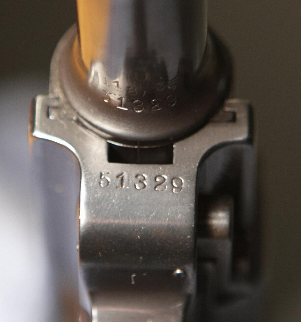

Probably the dealer's address. I would love to know the serial number.
Douglas
Unread 01-14-2010, 02:11 PM   #10
"I would love to know the serial number"
Me too. Thanks for the info on Rivadavia.

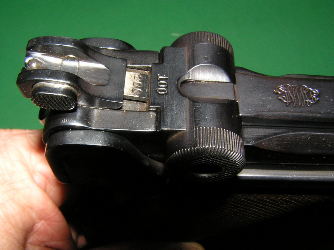

Hello:
Just posted 4 new pics. Would like an opinion an an approximate value and also if the items listed in the main post should normally be strawed.

Can't help much with value, but the items listed in your first post should be strawed. It is fortunate that whoever re-blued the piece did not over buff it, it still looks pretty good.
Unread 01-15-2010, 09:33 AM   #15
To increase the value, simply restrawing small parts is not enough, professional restoration is needed. As I've noticed, people have different opinion on the process, but one thing for sure, value is increased with cost. Not sure value/cost ratio, probably 1 dollar in, 70 cents out? If for keeping, it's an option. If the purpose is for selling higher, that ratio has to be better. Again, I don't know the ratio.
Unread 01-15-2010, 09:59 AM   #16
Hi Mark, You have a rare and valuable gun and I think it deserves a ground up, professional restoration. Although,for the most part, the gun was not over buffed, the side plate looks "soft". In addition to strawed small parts, the gun should have a rust blue, not a salt blue finish. Regards, Norm
