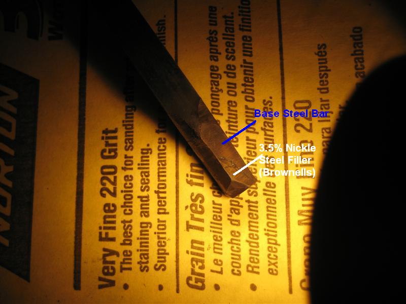

Brownells arrived. The 3.5% nickle steel rod after welding on base metal blues OK (rust blue). That's also a little bit surprise to me.
The pix shows how the trial bar looks after applying the oxidation agent the 2nd time (N times needed), not bad.... I mean it rusts not bad, my welding was horrible

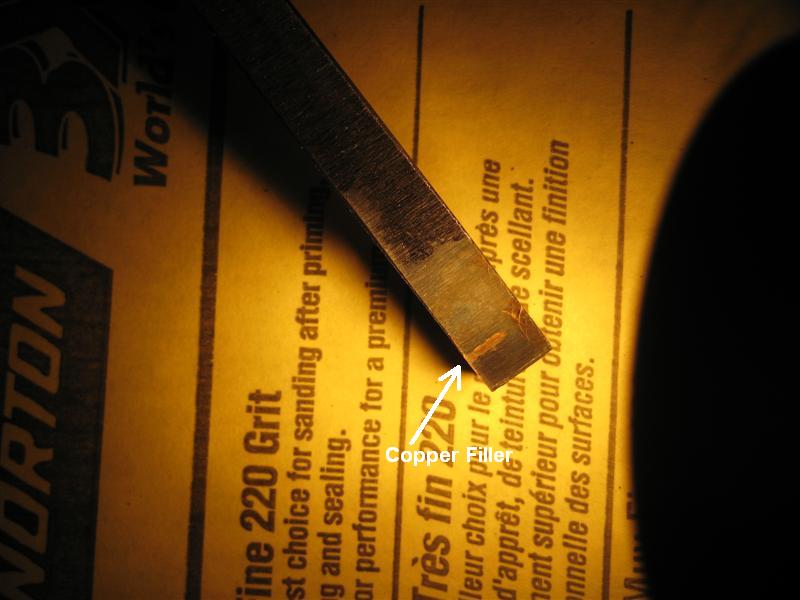

I did some brazing work on my basement water pipe in the past, that's way easier, no spatter (for some reason, copper or silver does not splash, but steel filler splashes like crazy during the welding process ). The biggest problem of brazing is color.
Copper filler in this pix, after applying oxidation agent 1st time. It won't turn black.

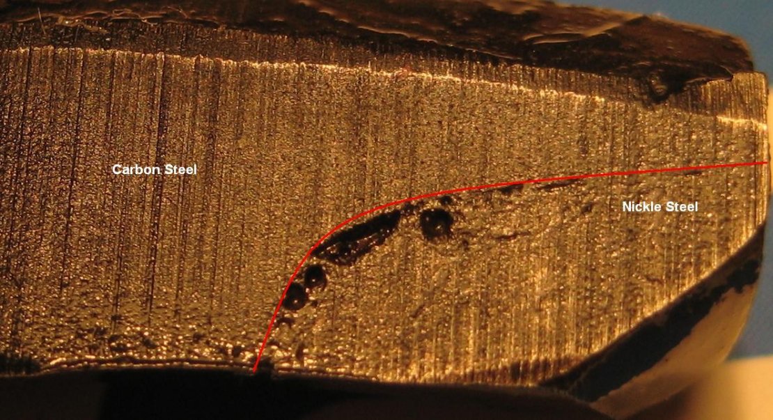

Finished 4 cycles of rust bluing. Boiling water does NOT convert rust on nickle steel into Fe3O4 well. After carding, more "floating" rust on nickle steel was brushed away.....
So, Thor and PoliceLuger were correct. Nickle steel (even a 3.5% one) does not blue as good as regular carbon steel.
