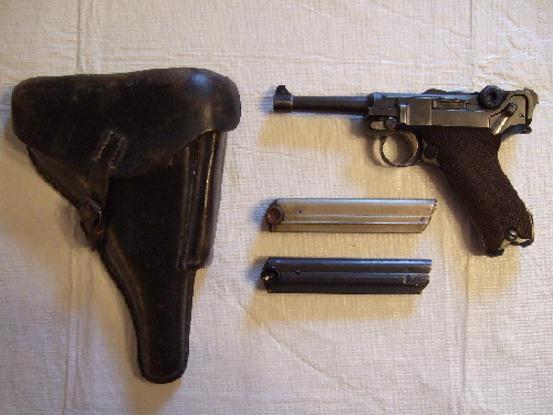

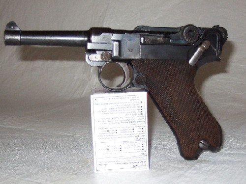

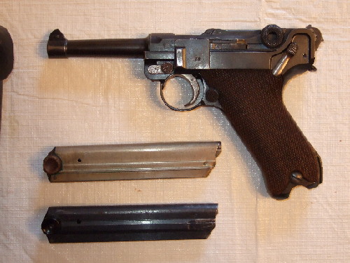

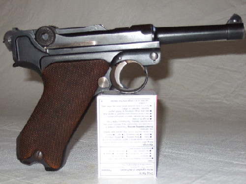

Some basic shots of the Luger I have, still trying to get the focus & lighting right to the markings are visible but here are a few to start with...

From what I can see it appears to be a 1920 Comercial that was modified for police use (as evidenced by the sear safety) and in your photos it is not correctly assembled. The coupling link on the rear toggle link is not engaged with the recoil spring lever. The SM marking is a property number for the Schutzpolizei Munster.
Unread 12-05-2009, 06:51 PM   #8
...... Don't shoot it this way.

Thanks for the info & safety advice. I inadvertently removed the trigger plate looking for number stamps & evidently failed to reassemble correctly. Could you please expound on how one would know when the gun was manufactured and what the terms "commercial" and "reproduction" mean related to how the weapon was used and it's present value?
