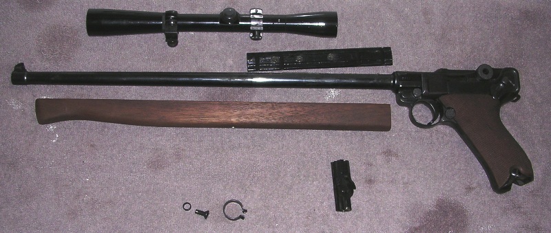

Long story short . . . bought a $750 shooter, parts Luger under the assumption that it worked fine. Well, hasn't worked correctly since I bought it. 16-inch barrel looks like. HAD scope, forearm etc. before today.
Problem #1: Original breech block failed. Got breech block from GT. Gunsmith at store I bought it from couldn't fix it.
Problem #2: He couldn't repair it mainly for firing-pin issues where the pin wouldn't strike the primer hard enough. Took it to second gunsmith. He fixed firing pin. Firing pin broke after a couple of rounds at range. He repaired the pin. Took to range today. Pin broke again eventually (not surprised) but here is what I DID find out before the pin broke:
Problem #3: Pistol would not extract round or cycle correctly. I then wondered if weight of scope etc. attached to barrel would have caused the function issues. I removed forearm, and scope. Pistol started firing correctly, but had some intermittent extraction issues. Then the scope mount blew off (not surprisingly - see pics). After that, the pistol started working much better, but then the firing pin broke again.

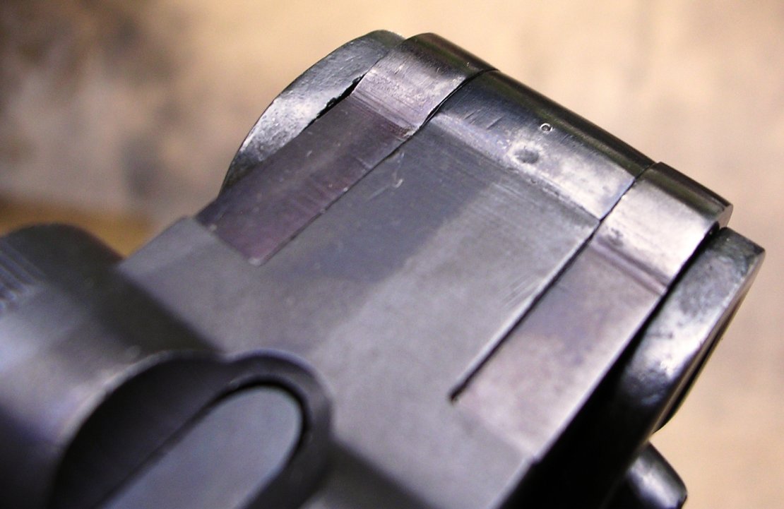

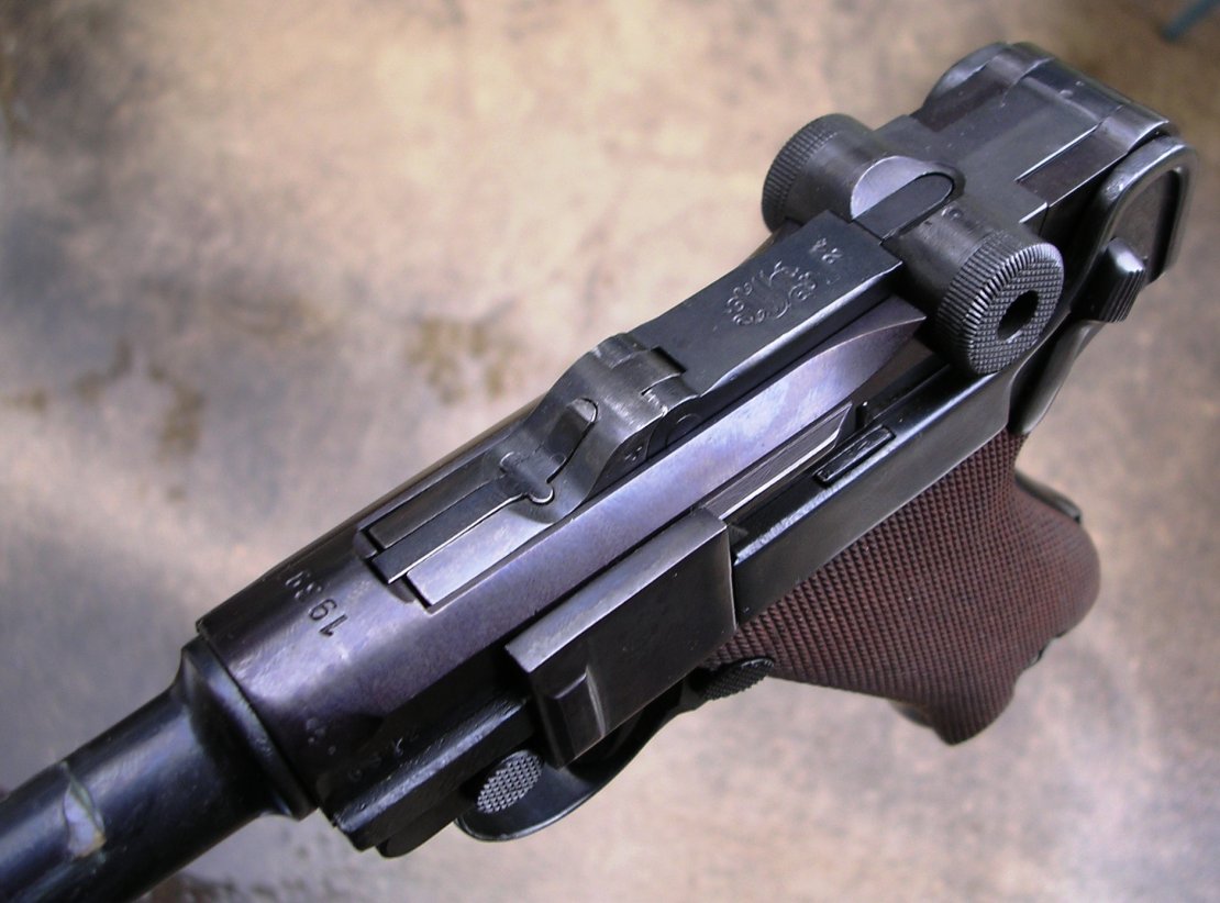

Question 1: Pistol does not have a rear sight. I looked at the way it is refinished etc and I THINK I might need a new toggle. Please see pics. If so, I'll have to get one from someone on here. Unless there is a way to affix one back on this toggle - I kind of doubt it. I am planning on leaving that abomination of a scope off the gun. Any other rear-sight ideas for me?

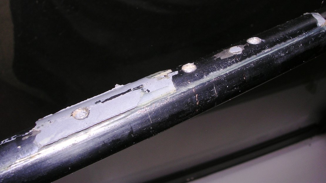

Question #2: Please look at the machining marks on the barrel that were used to mount the scope. They bored slightly into the top of the barrel before affixing the scope rail with epoxy Will this affect the safety of the firearm?

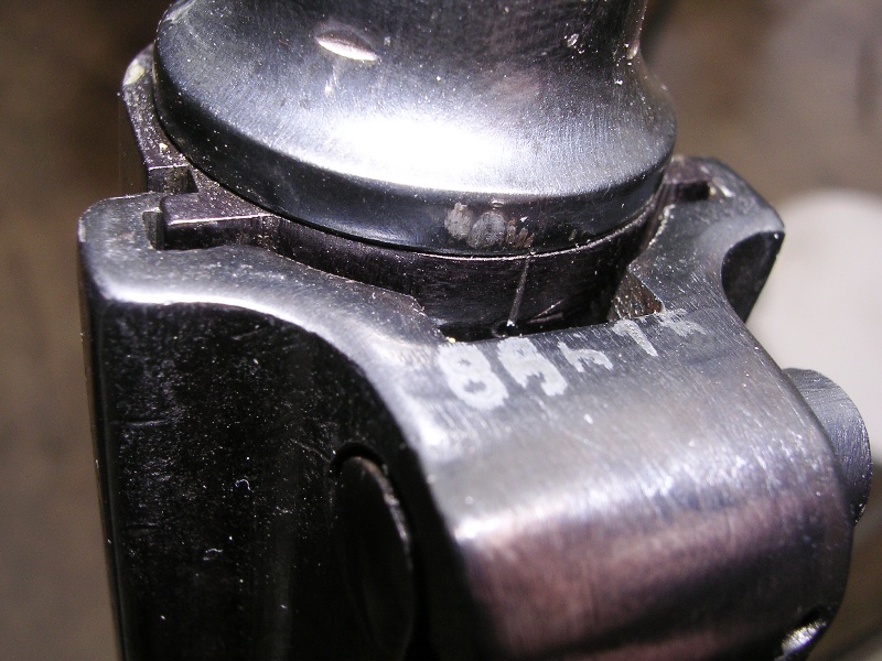

Question #4: SN on the frame is 86515. Looks to have been slightly machined off before it was blued. Where exactly does that put this frame date wise? Receiver is a 1939.

Pic of the front of the grip frame (where serial should be) - If the receiver is properly in place, it looks like the grip frame has been ground down...quite a bit...
Toggle pic shows crude file marks where the rear sight should be...

WOT, Your barrel sure looks like one of the Numrich 16&1/4" ones. The weight of these, even without a scope mounted, does make it difficult to set up recoil system for reliable function. I do have rear toggle links available with the standard fixed rear sight in the $25 to $50 range, depending on condition. I can also supply exc new forged rear links with the 2 position Navy type sight @$500. TH PS: note to HC, good luck getting this one to functon reliably, as I've given up working on this variation.

The barrel forearm resemembles an offering by Numerich(Gun Parts) and others(?). Always wondered if they would work at all(with such attached wood). Some have been for sale here before, and questions were asked about functionality of said barrel/forearms. Never saw a response, guess people did not know or did not wish to comment. Still looking for such comments to ponder on my own time
In my experience, that was one of the major problems. The forearm did not interfere with the function of the gun, but as more rounds were fired, it slid forward. It absolutely wouldn't stay put even after retightening. Tried it two or three times. that's when I decided to remove it.
I have not seen any early carbines with scopes on the barrels, however some later made up carbines had scope mounts on the side of the frame, thus no additional scope weight on the moving mechanism.
Yep seen this too! Makes sense to me after this experience.
The weight of the rifle scope, longish barrel, and barrel attached forearm will not do function any good; even with such mounted to a shoulder stock for stability. Just a lot of mass/weight for the mechanism to overcome.
Again correct. Once all the "stuff" i.e. weight was off the barrel, then it started working. Unfortunately the firing pin finally broke so I could not test any further.
You might ponder what one would want out of the purchase. Sounds like you got it for good now; perhaps no return?
Yep, it's mine now. As GT says, "You're learning a lot about Lugers now" and I have to agree there
Good luck with your new acquisition. Not sure if it will ever work as pictured, but one should never say never...... but this one will be a task as originally purchased. On the plus side, you have most of a Luger pistol to start with for a more thought out firearm.
