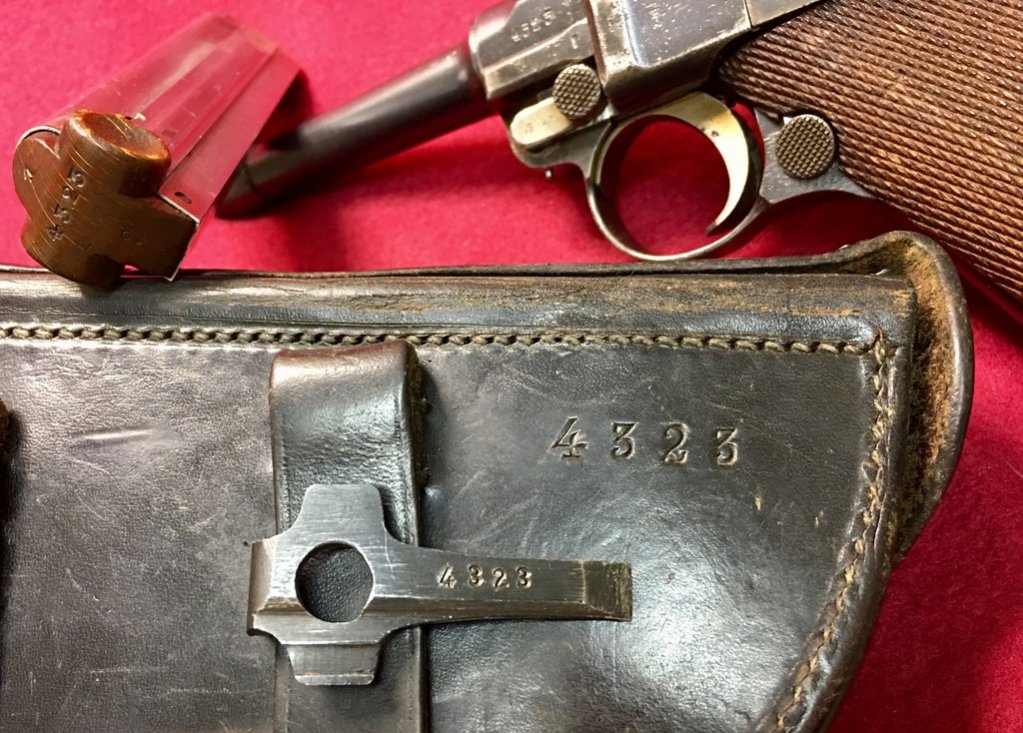

-Accessories/Other: Black Police type holster with “4323” stamped upper right back; loading tool numbered 4323 with */s inspection

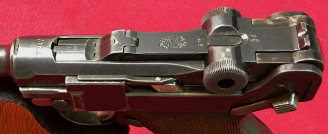

2.1-Center toggle link was replaced with a DWM marked part-numbered before finishing after re-work as the "23" has no ghosts. The toggle was replaced before the pistol received the sear safety, as the sear safety rivet is not blued- or else just the toggle center link was blued; the rest of the toggle train appears to be the original numbered and acceptance marked parts from Erfurt. The small pin in the top of the toggle is in the white and the breech block and toggle show more wear than the center link- a mystery for sure.

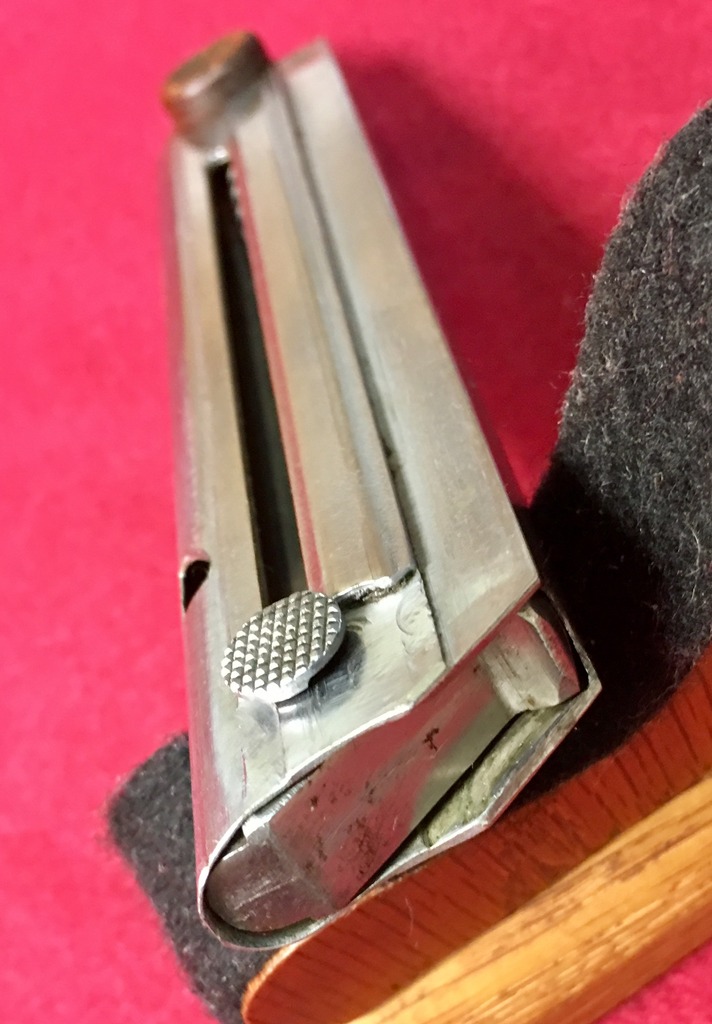

3.1 - Mag body is scarce 1st type Haenel Schmeisser, with */k inspection, and flat checkered button; must be one of the 6,000 spare magazine bodies ordered from Haenel for replacement use in Sept. 1935.(Goertz and Sturgess)

C- Holster- For Jerry!
The police up-strap type holster is not marked, except for the pistol serial number in the upper right.
Is it a commercial holster pressed into police service?
Likely; if so when? It has the later "wide, integral" back piece to form the magazine pouch, but not the full stitching across, nor does it have a "strap retainer" for the up strap. The holster bears a resemblance to AKAH holsters shown in Goertz and Sturgess.

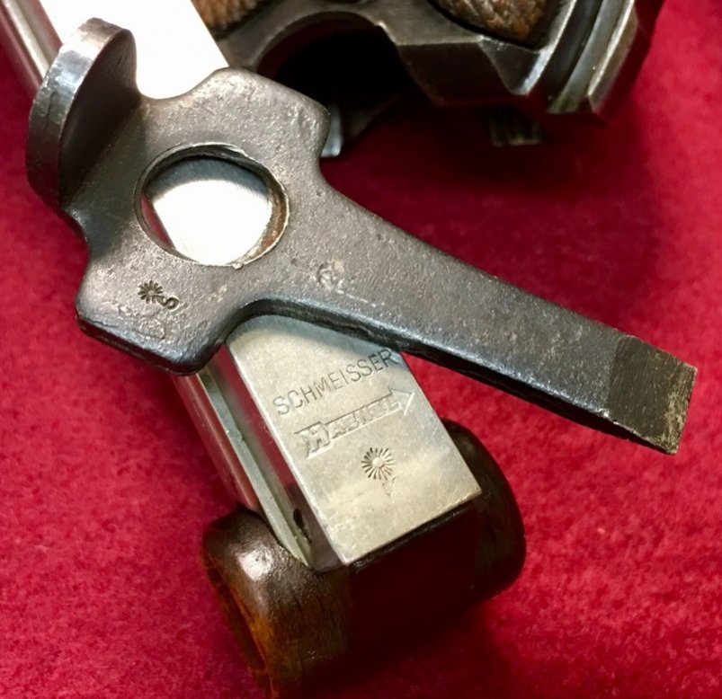

I was quite happy to add this rig, and to have an example of the early type Haenel Schmeisser Magazine. You will notice it has the angle cut and round spring of the early mags, not the straight cut of the second type Haenel type with zig-zag spring; in addition to the different shape of the follower button.
The star/k and star/s inspection markings on the magazine and tool are the two police inspectors whose names are fairly certainly known to be Krause and Schmidt.

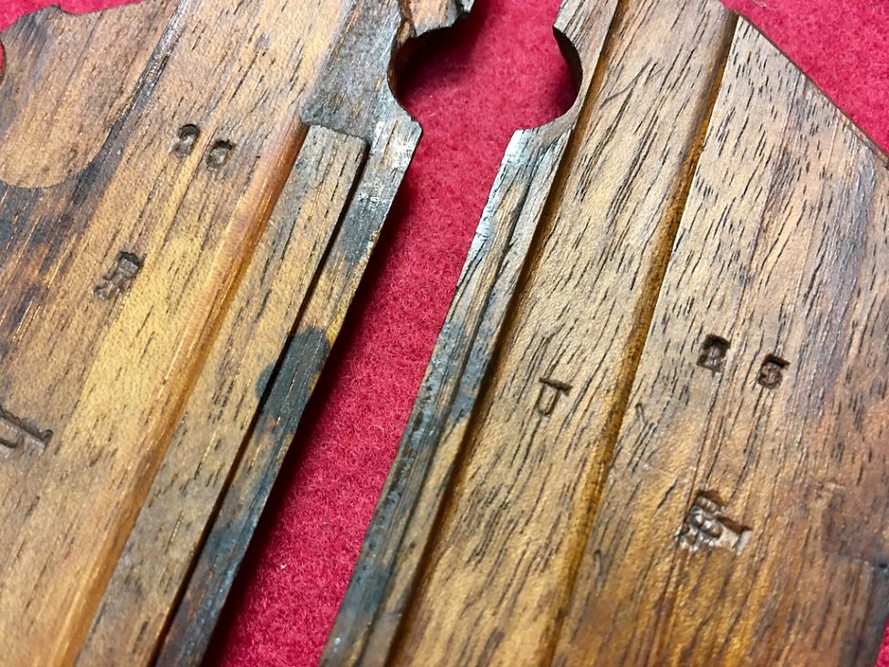

Notice the markings on the frame and inside of the side plate, these may be original from 1917 or date to the rework- either way they would enable the pieces to be kept together. Note the small Erfurt acceptance marking on the trigger lever.
