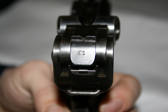

Hey guys im new to this forum and this is my first post so bear w/ me. i was helping my mom the other day and we stumbled upon this gun in some of my grandfathers stuff. i know its a luger, and i know its chambered in 9mm, but thats about all i know. if you guys could help me get and idea of when this pistol was made and mabey what its worth that would be great!! thanks for your help.

What a find, 1900 American Eagle in .30 cal I believe....looks like some right grip damage...more detailed pictures would help give value, but about 5k+ would be my guess....very nice condition

Your M1900AE is too early to be in the range of the US test guns. Finish is rough, but if all matching parts, in serviceable condition, should retail in the $1500 to $2500 range. TH
Unread 11-09-2009, 02:51 PM   #8

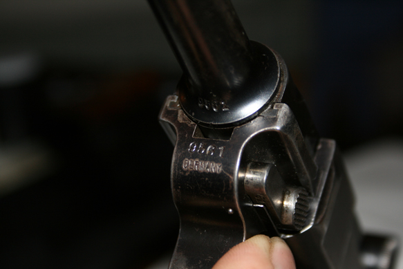

It looks like the serial number is 9561, which would make it later than the US test guns. The indentation in the right grip looks like it was crushed rather than cut in...very odd. Also, the catch on the frame for the toggle lock has worked loose and has moved partially out of its slot. It could come out completely and be lost. It should be secured with Locktite or silver solder...for goodness sakes do not let anyone use a pin punch to stake it into place! I have seen that done and it looks awful. I think Lugerdoc's price estimation is pretty much on target and probably toward the middle of that range.

Serial number suggests manufacture very late 1901
