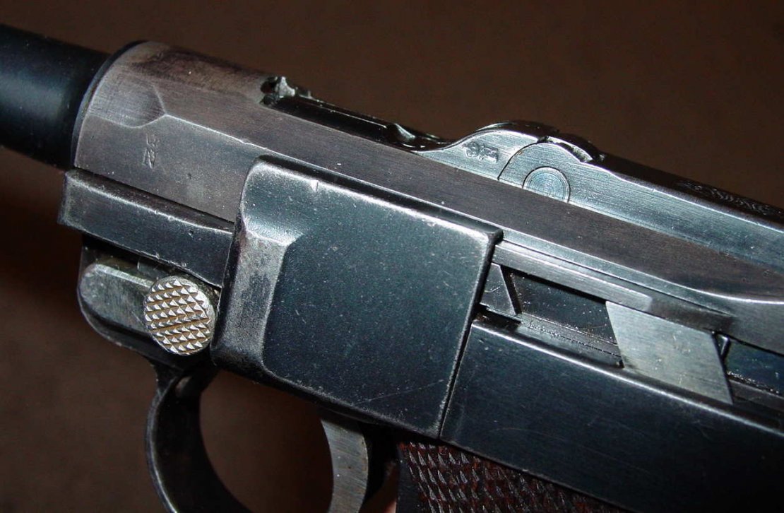

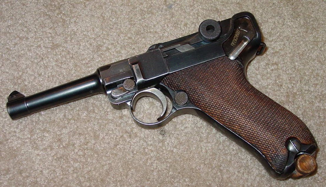

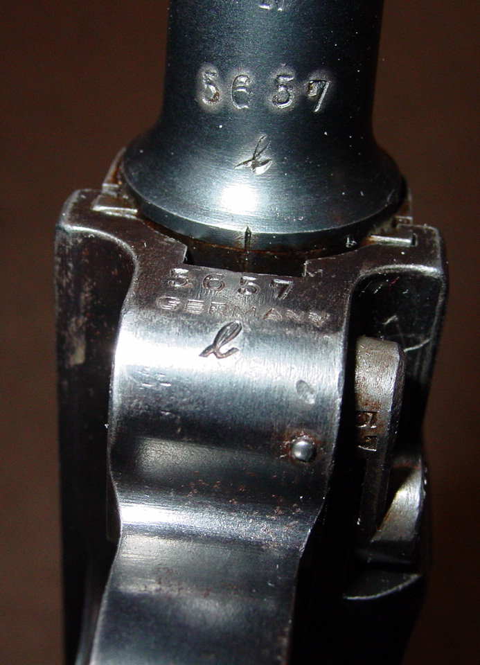

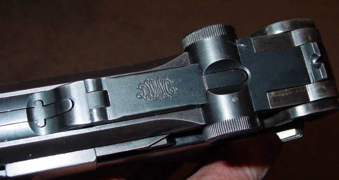

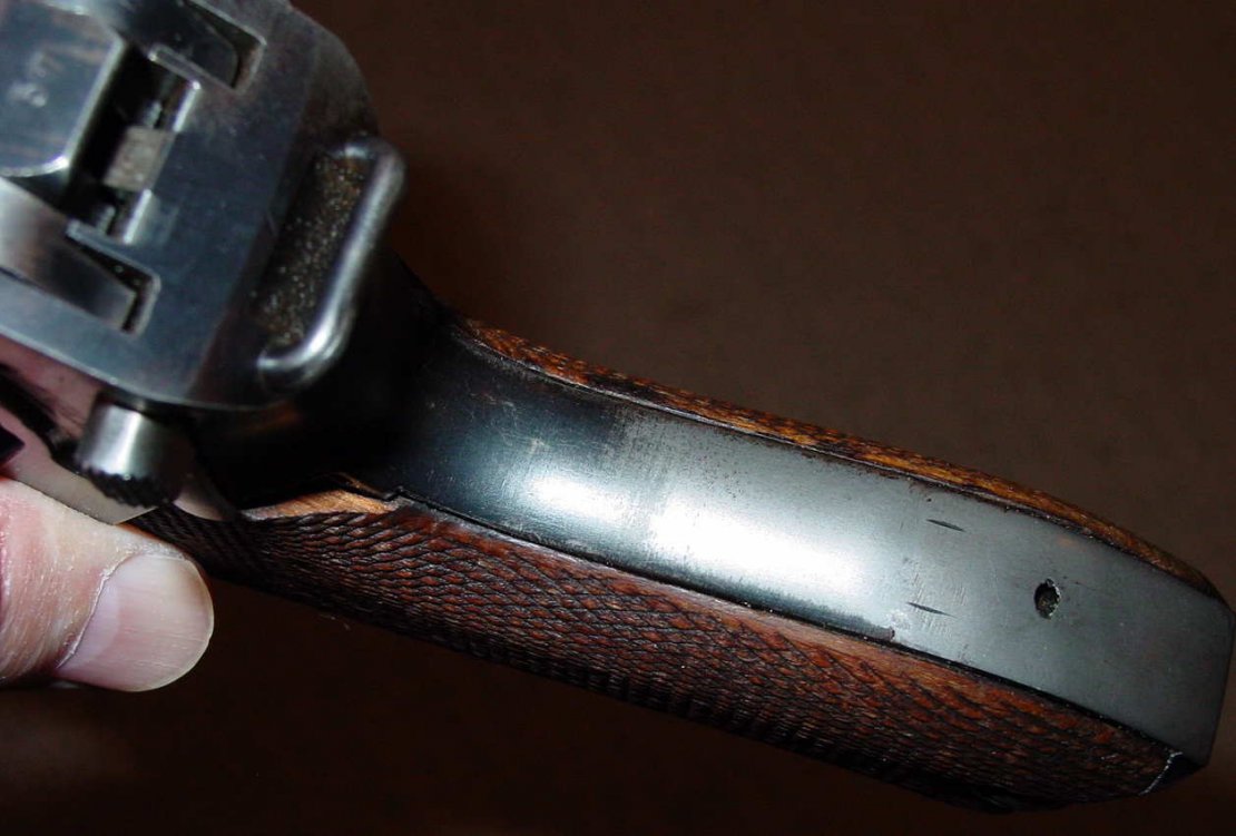

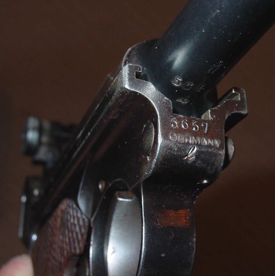

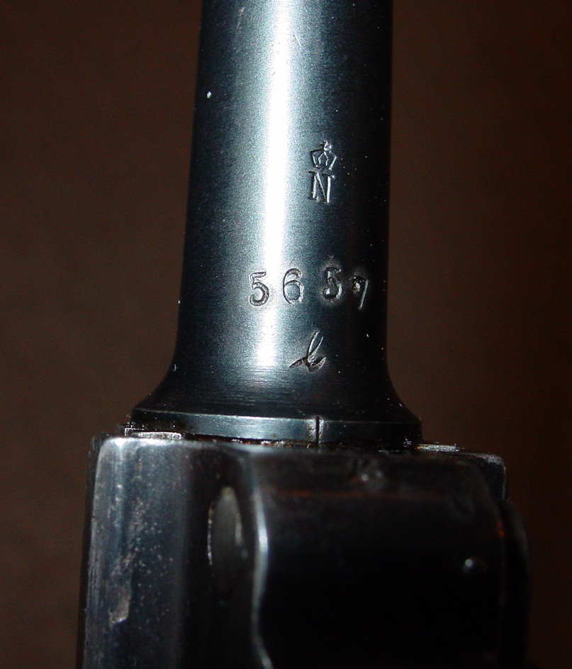

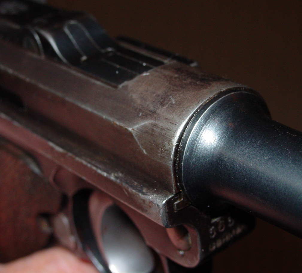

Got a cursory look at the DWM Luger today, and have attached some pics. From what very little I know, I'm thinking this is a commercial Luger, in 7.65mm, with matching numbers (what I could see...owner would not field strip it).
Overall it seems in pretty nice shape, barrel and feedramp look mint. top of receiver/chamber appears to have been ground down, and the finish is very worn in that area. Owner says it was probably a commercial police pistol and had police markings removed when sold in civilian market??? Balance of finish looked good, but showing holster wear on high points
No number/markings on mag, chip in one grip, and the shoulder stock lug had been removed.
Based on pics (sorry they aren't better, took them in the seller's living room) of condition, markings etc. do any of you gentlemen have any comments/thoughts/suggestions as to the particulars and/or value of this piece. Any wild ball park numbers would be appreciated. Seller wants $750, but with my current lack of knowledge, I'm very hesitant to buy it.
Thanks again for any and all assistance.
John

Unread 11-12-2009, 07:45 PM   #9
HuntMaster
Join Date: May 2009
Posts: 69
Thanked 2 Times in 2 Posts
Personally, I would offer $450 for the gun. If it offends seller or he simply says no, I would walk or better yet RUN from this pistol.
Too many shades of blue, not to mention the grinding off of the lug and other ailments visible.
There are far nicer Lugers to be had for the price on this one, IMHO.
Just my .02
Derek
HuntMaster is offline   Reply With Quote

Unread 11-12-2009, 08:47 PM   #11
I agree. $750 is the "last man out" price on that one. Hold your money close and don't get in over $500. Have you priced .30 Luger ammo. Really not good shooter stuff.
I know the urgency in bringing home the first Luger, but if you hold off a bit for a better gun/price you will love yourself for it in the morning.
DJU

The gun has been ruined and is only a collection of matching parts in a caliber that is expensive to shoot. If you can get it for $450 or so then it is a reasonable deal. Otherwise, spend your $750 on a better 9mm piece to, as Lugerdoc stated, "shoot and learn about the function"
