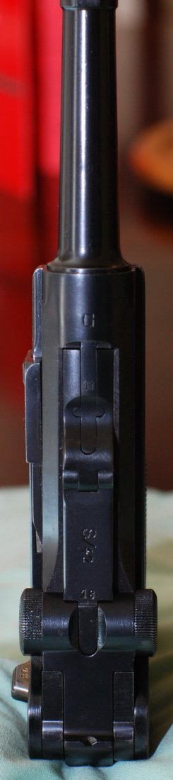

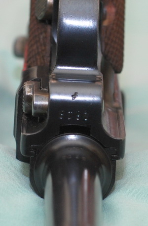

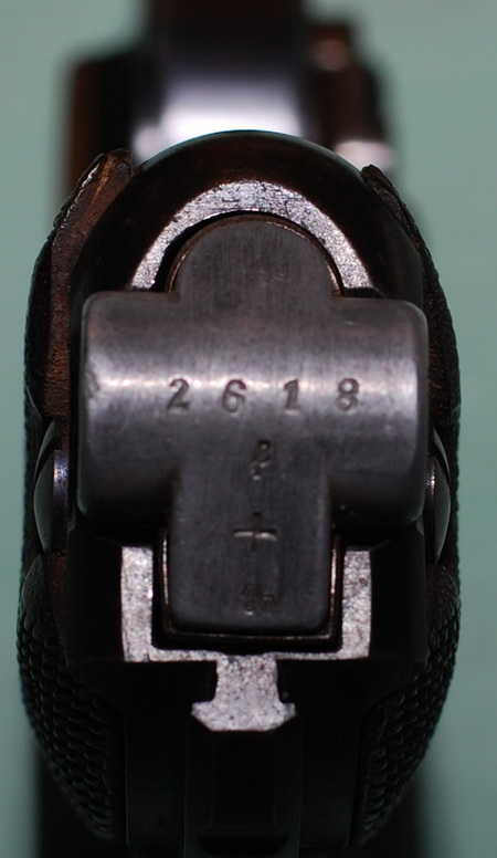

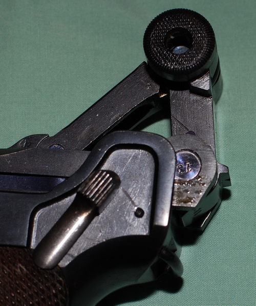

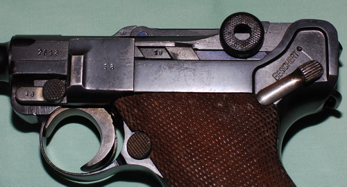

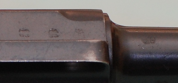

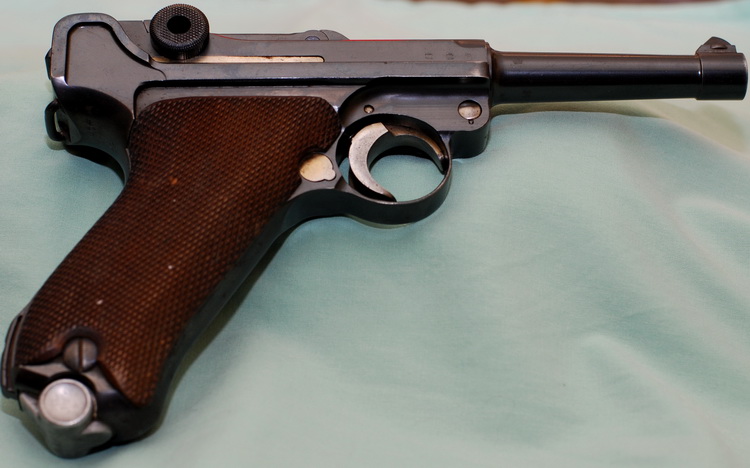

Here are my first efforts at photographing the Luger I inherited. I have not (and at the moment will not) attempt to field strip it or remove the grips to check interior numbers. However, my brother said that is was all matching inside and out. So assuming that it is all matching, what is a reasonable vaue to insure it?

Looks like a 95%. Where did 70-80% come from.... where is the lost of finish? On grip?
Unread 10-05-2009, 11:28 PM   #6
I'm just a meat and potatoes guy, but this one looks very nice. Congrat's. Check Simpson Ltd. for like models for comparison. Depending on insurance premium rates how about $3K valuation? What it would bring in this rotton market doesn't seem relavant to the insurance question. Anyway a very nice Luger.

Nice G Date saxthorpe.
The "f" suffix below the serial number is part of the serial number and indicates which block (a,b,c,d,e,f...) of 10,000 the serial number belongs to. The Droop Eagle 63 (DE/63) stamps are correct for the f suffix. The Early Test Proof (ETP), I believe it's called, stamp to the right of the DE/63 stamps on the right receiver, and on the barrel (right), are also correct. On the barrel left should be DE/63 (as you also see on mag bottom). Now, I'm just learning as well, so I'm sure others will correct/confirm.

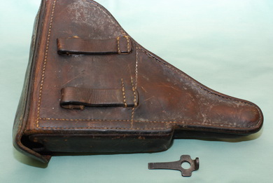

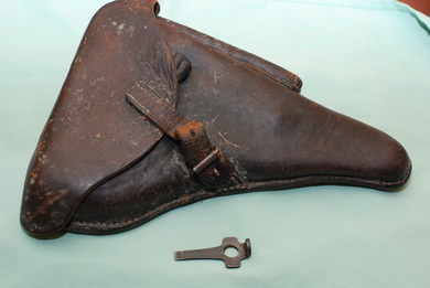

If that is a 1935 holster, it's rare and would be worth consulting with lugerhosterrepair (Jerry Berney?) about possible clean up. Photos of stamps on holster back and on tool are helpful too.

Regarding the % finish, I was being very conservative and don't have any experience doing an "appraisal" of a gun's condition - so what you see on the photos is its true condition.
I know the holster came with the pistol, and my brother bought it sometime during the late 1950s or early 1960s. If getting the holster cleaned and repaired won't ruin its value (as it will for a pistol), then I would like to do it. My brother smoked cigars and the leather reeks of tobacco, which is why the holster is NOT inside my safe with my other firearms.

EricW - thanks for the referral to Jerry, he is going to "clean and lube" that old holster for me. Sounds like a very nice fellow, too!

Bruce, The droop winged eagle over 63 proofs are correct for your F block G date. The finish appears to be exc original, but had to guage percentage from a flash photo. The flash also may bave obscured the number on the safety bar, which should be matching last 2 digit of serial. Nice PO8. TH

I have ordered some maco lenses for my Nikon digital camera system, and will dig my studio lighting out of the storage closet for taking some better photographs. The bluing is definitely original, the pistol has sat in its holster - unfred - in a drawer for at least 40-50 years. Yes, the safety bar also is numbered "18". Many thanks for the nice feedback!
