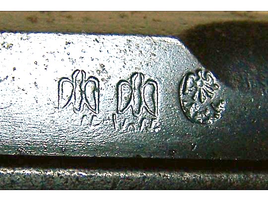

hallo
this came today across.....1921 DWM number match without mag....condition is fine....but look at the proof marks,what is the right one??
best regards

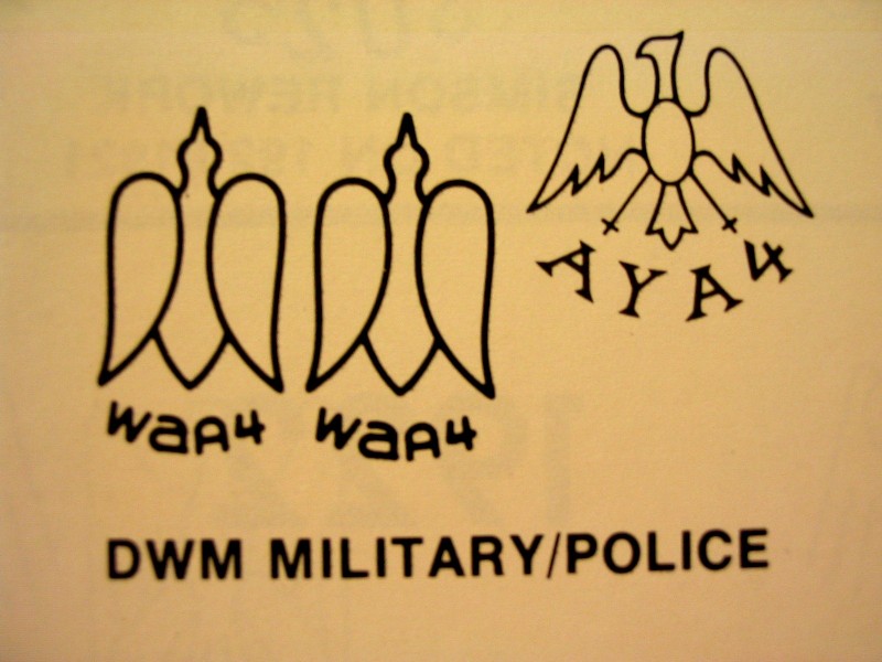

These Proofs aka Waffenamts, are found only on 1920 and 1921 production DWM military and police Lugers. Known as "Dove" and/or "Buzzard" proofs. They are found in different combinations. Eagle(Dove)over WaA4 or ArA4, and Eagle(Buzzard)over WaA4 or ArA4. Yours has two Doves and the Buzzard (on the right).
I'm not certain that anyone knows why they were of both designs, or found in different combinations. Other than to identify the individual inspectors that they were assigned to.

I believe that the stamp on the right is the Weimar firing proof and the two to the left are Reichswehr inspection stamps.

1921 was the transition year from the Ausrüstungsamt (ArA) to the Waffenamt (WaA). Perhaps they also changed from the buzzard to the dove. This pistol probably was produced during that transition.

You're right, I had forgotten the term "Ausrüstungsamt". Do you know the approximate month that they began the change over? Do you have any information on why they are found intermingled? Kind of mixed and matched from what I have seen.

Ron, I recall having read something about the transition from ArA4 to WaA4 but can't remember where or anything more about it. The formation of ArA4 is discussed in Görtz & Bryans, p. 131.
George is probably correct that the right stamp is the Weimar firing proof.

It's an Eagle over ArA4. I have 6 1921 military Lugers, 4 in the b suffix block which are marked as in the photo. They all have a variation of Eagle(Dove)over WaA4 and/or Eagle (Buzzard) over ArA4 or AyA4. If by "Weimar Firing proof" you mean the droop eagle as found on early Mauser Lugers? It is not the same.

The difference between the dove and eagle WaA4 is simply the replacement of the stempel used by the inspector. The eagle is sometimes found above ArA, and sometimes above WaA, denoting the change in the name of the inspection office. The firing proof inspector retained his e/WaA4 stamp long after the old, worn eagle inspection and acceptance stamps were replaced with the dove stamp. Eventually the firing proof stamp was replaced as well, as late production is found with all dove/WaA4 stamps .
