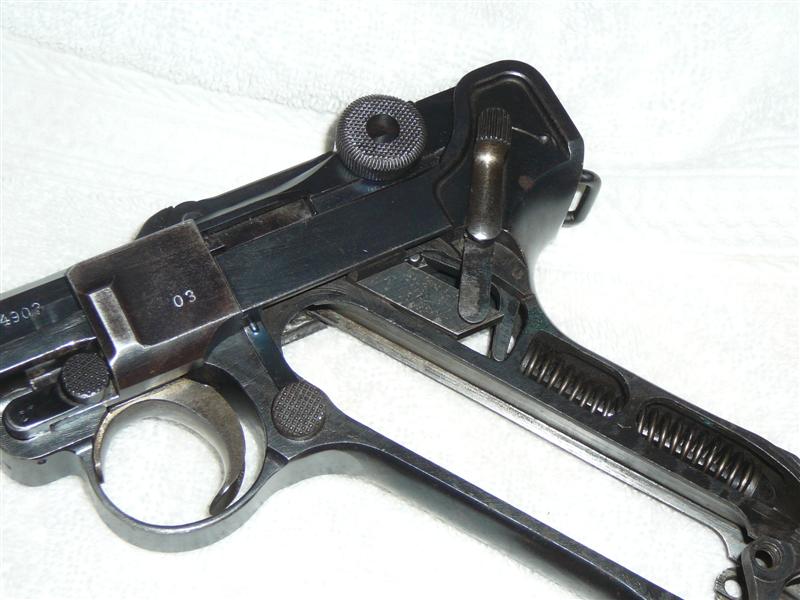

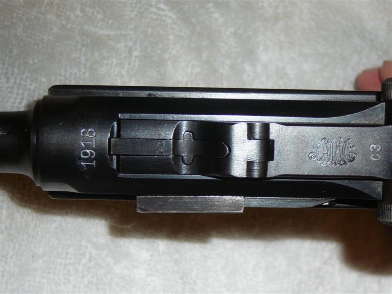

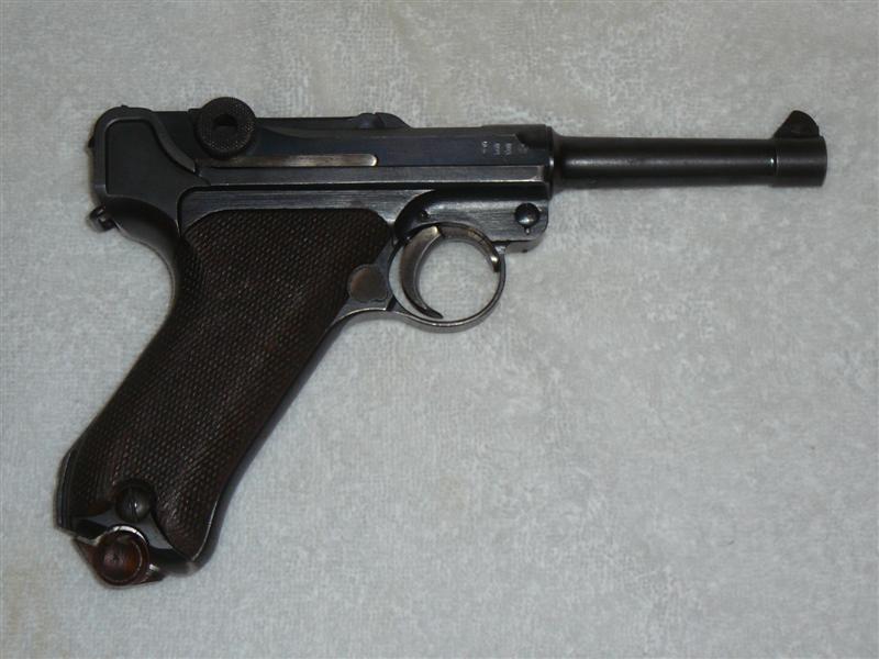

Hey Guys,

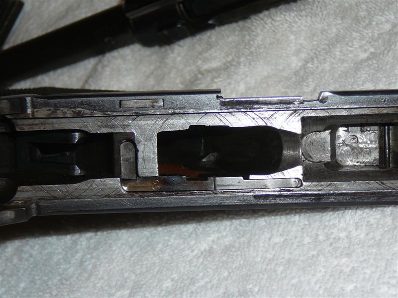

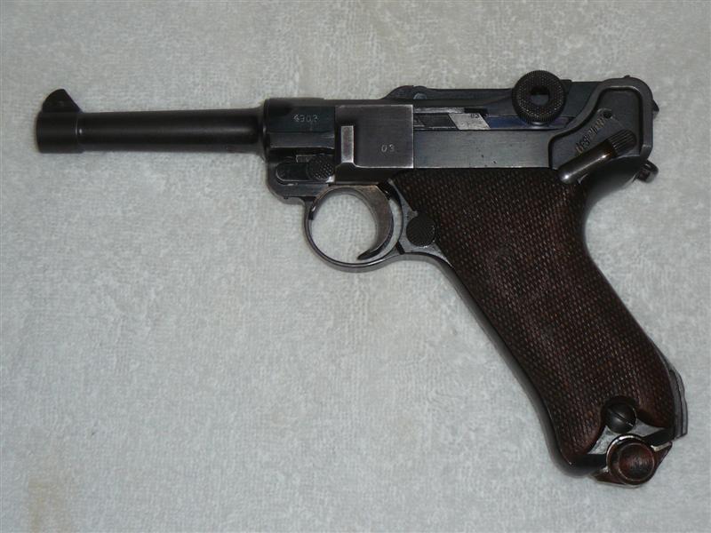

I just recently picked up this 1918 DWM, I'm not sure, but I think this one may have been reblued. The condition is pretty good, but sadly the take-down lever isn't matching the gun.
I normally only collect WW2 Lugers, but I am starting to like these WW1 DWM Lugers. I'd like to know of this has been reblued or not, either way still a nice looking shooter I guess.
All comments are welcomed.
Cheers,
Rylan

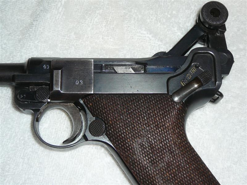

The frame and barrel look OK. Why the sear cover being so unbalanced is unclear to me, might be fake matching. The trigger was somehow treated with abrasive stuff.
Unread 09-08-2009, 10:04 AM   #3
Remember that there are many sear covers, which are correct, that display noticeably different color than the balance of the gun.

That topic was archived so I could not post there. If owner of this topic could allow me.... I have a question. For this light colored side plate (or Vlim's Vopo examples posted in the other topic), how does the interior of the side plate look? Does the color also look much lighter inside, or normal inside just like rest of the gun?

The finish appears original to me. The white metal inside the frame indicates that it has not been hot dip blued. KFS
Karl is online now   Reply With Quote
Unread 09-09-2009, 07:07 PM   #10

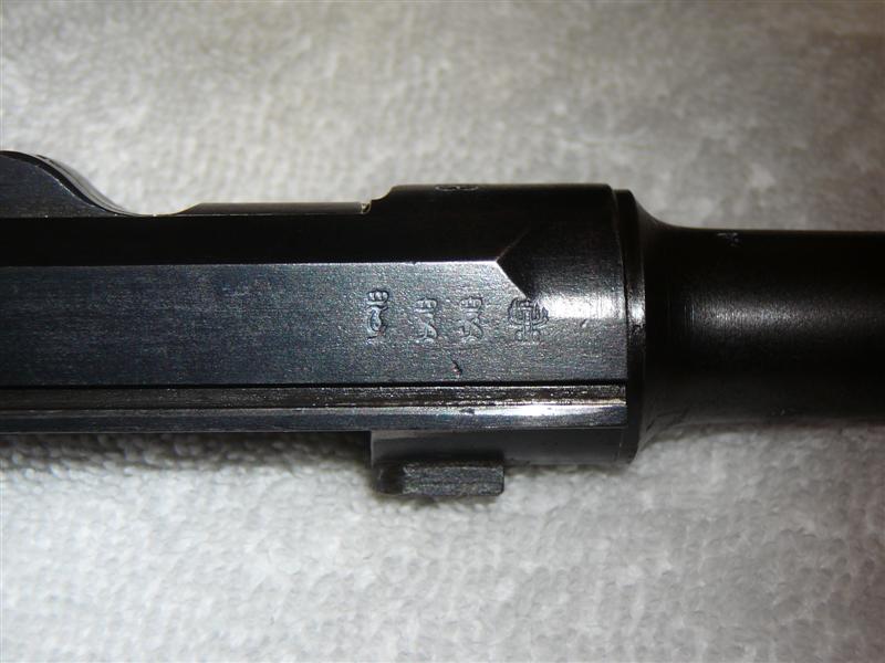

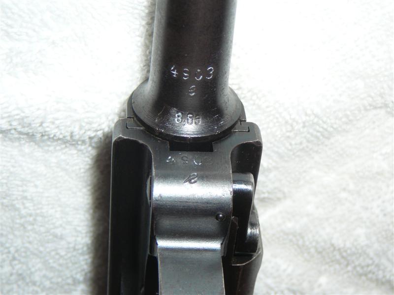

Rylan, they key to determining if Imperial army DWM Lugers are in the original blue are the serial number stampings on the forward toggle and the extractor and the barrel guage and serial number stampings on the barrel. These marks were all stamped after final bluing and should exhibit a distinct halo around those stampings.
