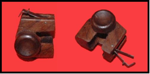

The base is fairly complex and is an exercise in woodworking! The spring latch is fitted into a recess in the base and pinned in place as the next photo shows:
