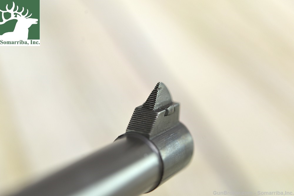

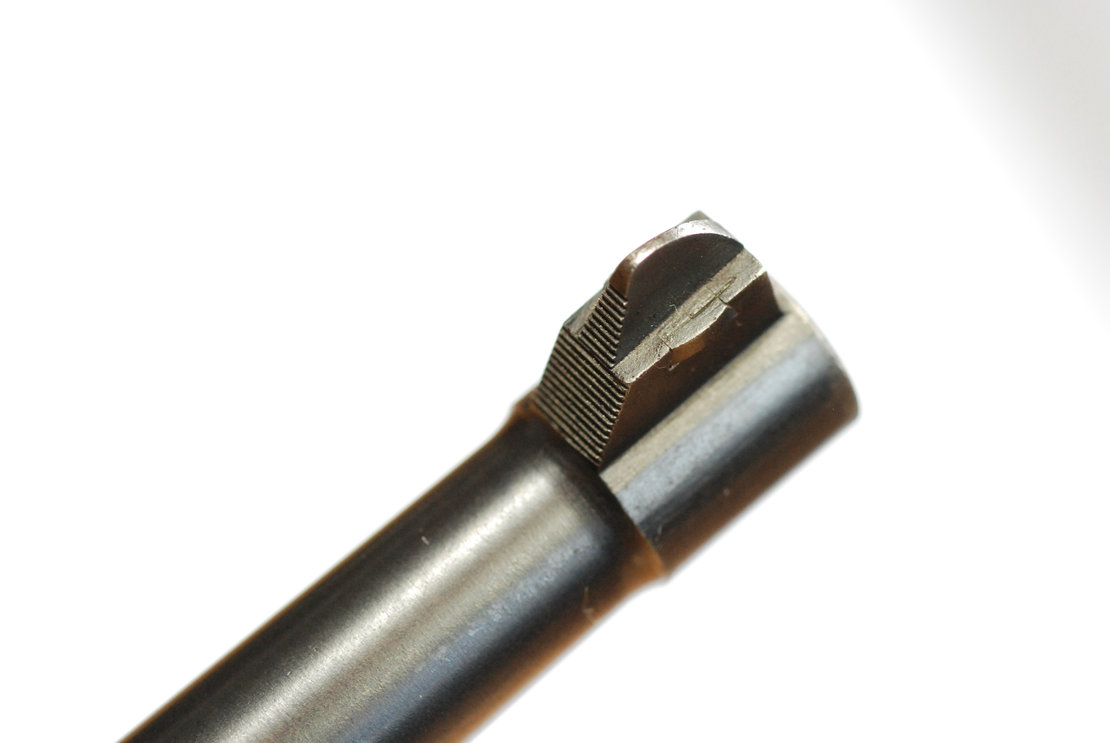

O.K. guys, you did pretty good, not great, but pretty good:
gunbugs, you get a point for the blued toggle retaining pin.
gunnertwo, you get a point for noticing the missing chamber date, but you lose a point for not noticing that the date is missing from the front sight base as well!
Proofed, you get 3 points for noticing that the front sight is serrated all the way to the top not 2/3 of the way up as it should be (see photos). However, I have to deduct a point for not noticing that the base is undated.
How come nobody noticed the commercial C/N proofs? Don't you know that the German for Navy is Marine? Your lucky I'm in a good mood or you chaps would be in negative territory! There is one other red flag but I really didn't expect anyone to get it as it's not in the books yet. The relieved sear bar was introduced in late 1916 and the first 1200 aprox 1916 Navies came without this feature.

Ther is a date on the front sight base left side. hard to see but there.
And to think i was ready to severely reprimand myself and go to bed with no hot toddy
Unread 06-02-2020, 09:12 AM   #11
I believe you are correct, if one stares hard enough at Photo #3 one can just make out the last two digits of 1916, so you and gunner two get your points reinstated. I may be tough, but I'm fair.
Norm

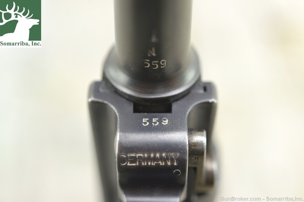

Ok, I know nothing about these, and little about anything.
I looked at that Luger before reading this thread. My impression was that it might be a 1920 Commercial Navy, perhaps tarted up to appear to be a military 1914 model.
The one thing that screamed at me was the "Germany" stamp on front of the frame along with the Crown over N commercial proof on the receiver. I've not seen a military Luger with these marks.
I'm all into points and gold stars. Do I get any?
Curl

Hi Curl,
The "GERMANY" stamp was applied after the war when a lot of military equipment was exported to the US to raise cash. You do get a point for noticing the C/N commercial proof on the receiver but I regret that you forfeit it because you failed to notice the C/N proof on the barrel in the photo you posted.
Norm

Oh well, points are easy come, easy go. But I did see the C/N proof on the barrel. Just didn't mention it. I also saw the military proof stamp on the left side of the barrel.
I still think this gun is a 1920 Navy Commercial.
I'll be the first to say that when the British de-commissioned their military handguns they sent them to the civilian proof house for commercial proof. I haven't seen that practice on de-commissioned German pistols. There are millions of German military Lugers here in the U.S., and I don't recall seeing one with civilian proofs and "Germany" stamped on the frame.
