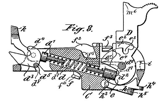

Did you get the lockframe assembly out of the pistol???
Here's a pic of the early lockwork...You can see the rocker coupling is in front of the plunger (unlike the later Mausers, which have the plunger in front of the coupling)...

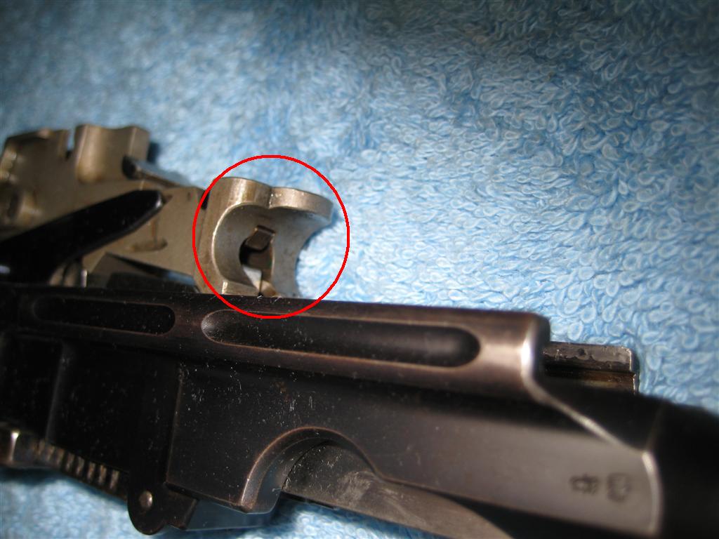

This patent picture is not too far away from CH. There is no plunger, in its place, it's a spring plug. It's extremely hard to disassemble the coupling out even when the lock work is taken out of the frame. My way was pushing the hammer pivot out to release the hammer and main spring, then it's easy to take the coupling out. But obviously that does not work when the lock work is in the frame.
Is it still in the frame?
Unread 08-11-2009, 11:44 PM   #12
JBW's method must be revised on CH -- there is no plunger pretruding out of the lock work in the front, so there is nothing that you can push in from the front, as shown on JBW's article.
It can be put in, then there must be a way to take it out. Somehow you have to hold the main spring back so it does push the coupling..... how about just pushing the plug backwards using a tool.....

Thanks for the diagramme, Postie, and your comments, Alvin.

Postie's diagramme, by the way, is from the original 1896 specs (you can tell by the hammer spur). There, you can see the similarities to the standard Conehammer that hadn't yet changed in the later production pieces.
