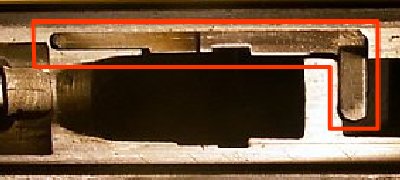

Is there a mechanism that is supposed to lock the action open if the magazine is empty? I don't seem to be able to get the action to stay locked open.

Yes, there is a device to hold the toggle open on an empty magazine (see photo). If the toggle does not lock back it could be due to a missing or worn holdopen device. More likely it is a weak magazine spring that does not allow the magazine follower button to push the holdopen up far enough to activate.
P.S. Thank you for the serial number. It is fairly early as Model 1900 serial numbers run into the 20,000 range.

There is a hold open device, actuated by the side button on the magazine. It's a little spring along the inside of the right slide frame. This came around somewhere about 1908, I think? These were not mandated for military until 1913. It appears that you do not have the stock lug either. Another thing that happened in 1913. You do have the dished toggles, later models had flat toggles.

The hold open device was a feature of Luger from the beginning. It was eliminated for the 1908 army contract, but quickly reinstated in 1913 when it was realized that it was false economy to eliminate it as it served a very useful function. Except for the early Navy Lugers, carbines and some prototype examples, the stock lug also did not appear until 1913 (it was another thing eliminated for the 1908 army contract).

I see. I will have to examine the pistol tonight to see why the hold open isn't actuating. What is the proper method for closing the action if the hold open is working? Remove the empty magazine, then pull the toggles slightly? (I'm working only from a knowledge of how modern semi-automatic pistols function). I assume there is no equivalent to a slide stop lever?

Yes. Take the mag out and pull back slightly. Remember the trigger/de-cocking tip. As for cleaning, I use the same stuff I use on my rifles. Butch's Bore Shine and gun oil. But I think any modern stuff will work. Hoppe's is good. Careful not to get any on the grips. I would avoid some of the VERY aggressive cleaners on the market. I have an M1 barrel that is now a tomato stake from that stuff.
