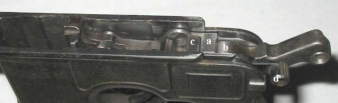

Alvin thanks for the information. I've still got a few weeks away from home, but I'll put obtaining the hammers in motion. Just want to be sure I understand what your saying. I would mount the piece of bar to the right of the "b" in the picture. My main concern was if it would clear the sear. Tahnks again.....Chip

"b" is too close to the normal hammer locking edge. If the new locking edge is added at b, the purpose of half-cocking is lost.
I would think it's much better to add it to the hammer disc under the sear when safety level is on (and hammer down). The hammer head will be locked 3-4m/m away from the firing pin when it's half cocked. Marked by red line in the pix.
Locking/clearence of the newly added locking edge must be manually adjusted by filing.
