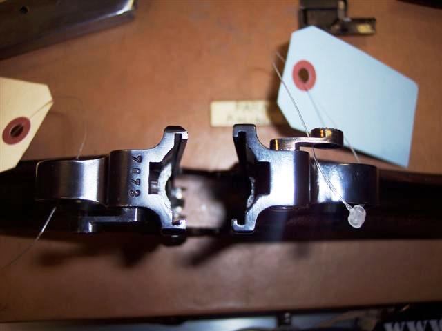

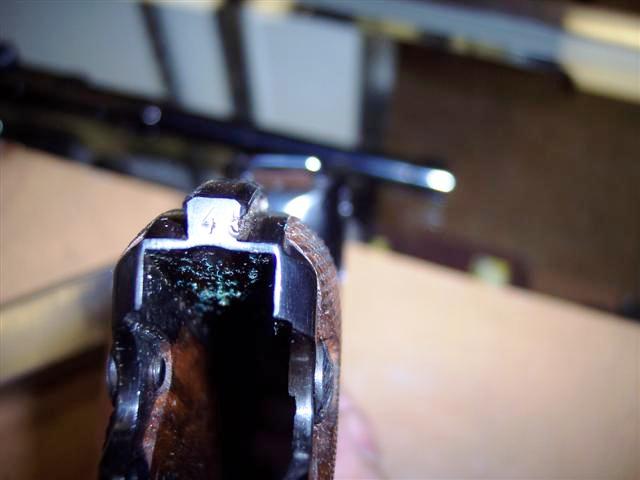

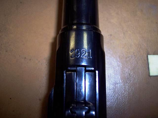

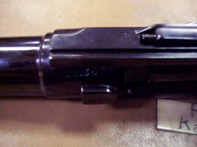

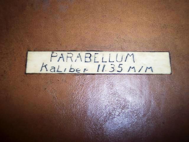

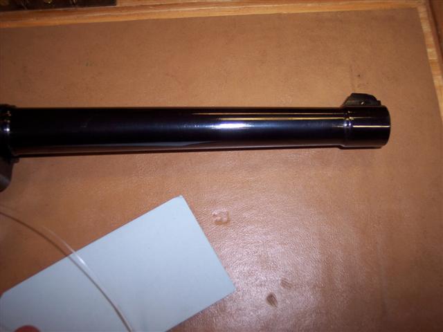

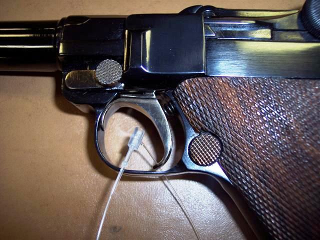

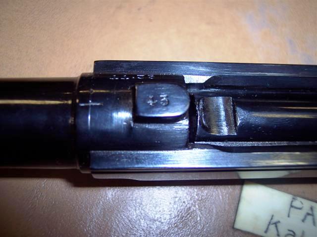

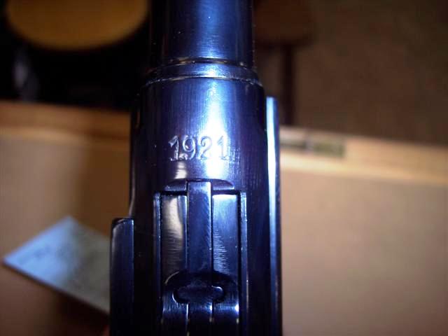

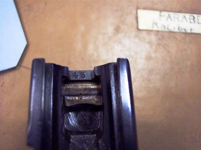

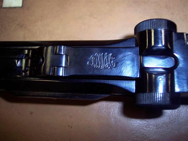

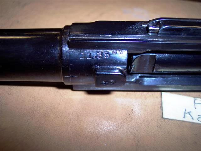

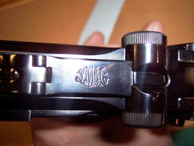

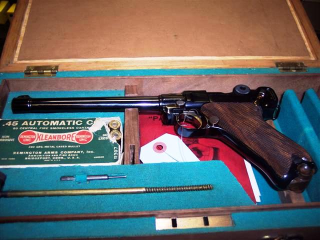

Just bought a 1921 dated DWM Luger in .45 ACP, from a walk in at a local gun show. He told me he thought it was a salesman's sample from the Stoeger days. It is a beautiful high gloss blue with a six inch barrel. It has no grip safety. It has the same trigger guard and trigger profile as the US Army trials Lugers. It has a chamber date of 1921, DWM on the toggle link, 45 on the underside of the takedown lug, 45 on the inside of the frame in front of the takedown lever and 11.35mm underneath the chamber on the inside. There are absolutely no other markings or proofs, ANYWHERE on any of the parts. The frame is NOT widened as is seen on some Martz Lugers. The gun is in a custom leather covered display case with a wood bottomed magazine and vintage cleaning tools as seen with some early Lugers. There is no indication whatever who may have made this gun. The finish is about mint, but the gun is obviously not newly made. Any help would be VERY welcome as to the identity of the maker. Thanks.

Lugers made for the commercial market were not dated. My guess is if this Luger was made for Stoeger or another importer, it wouldn't be dated. The 11.35mm seems American. The European decimal is a comma, which is normally seen on the underside of the barrel for the bore gauge, such as 8,82 and (mm) was never used.

Well maker would be DWM if original (doubtful). Pictures would be nice to see?

Thanks, and please note that bthe barrel is 7" and not 6.

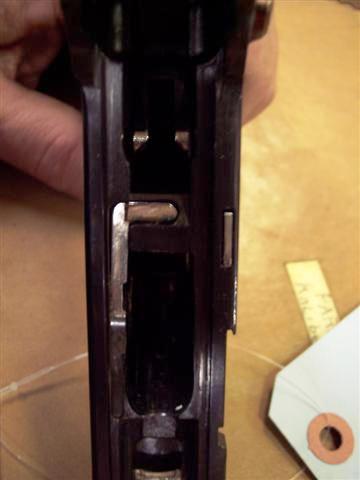

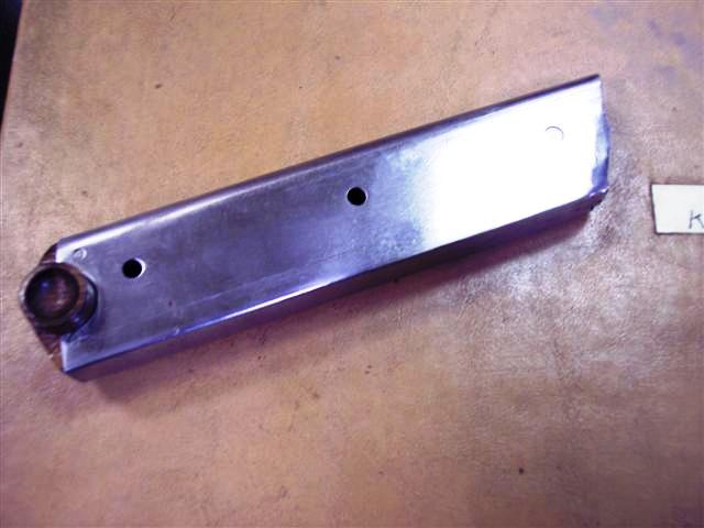

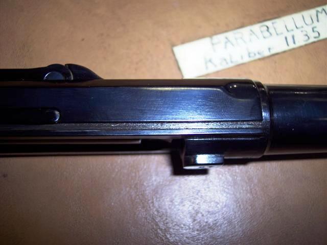

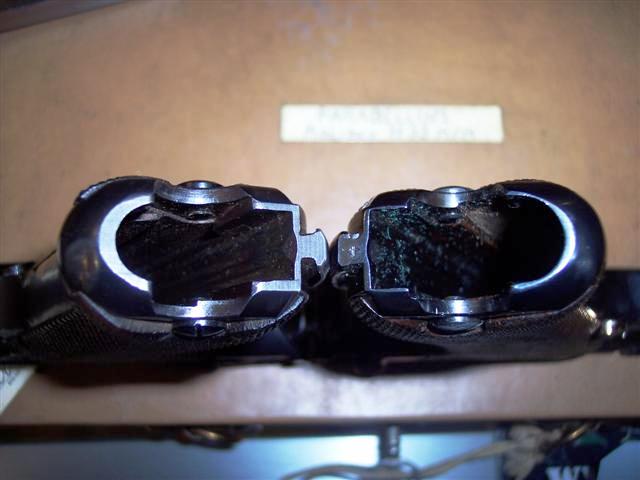

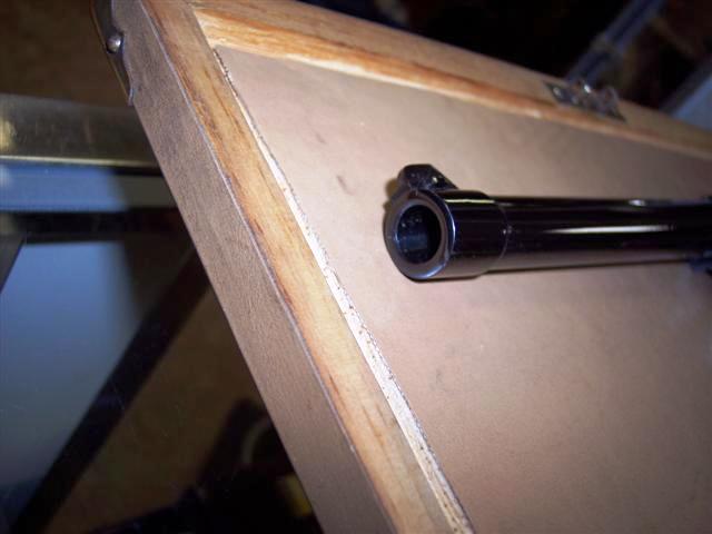

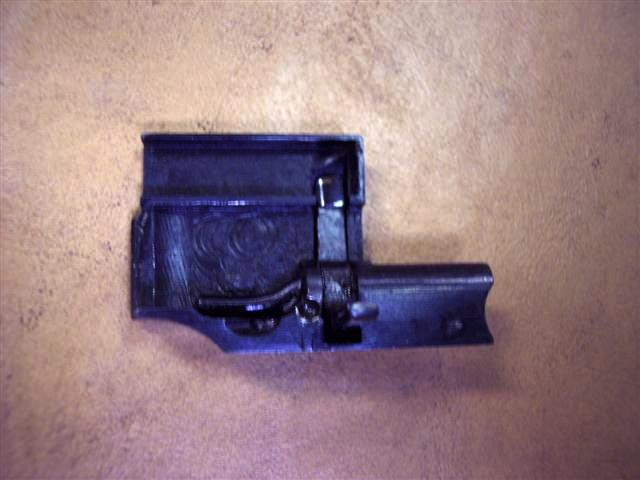

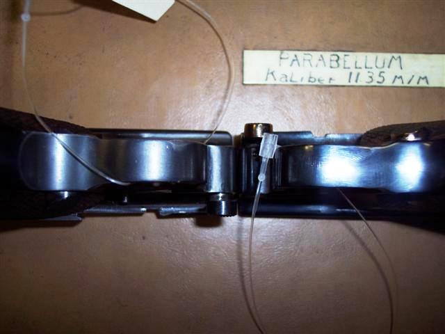

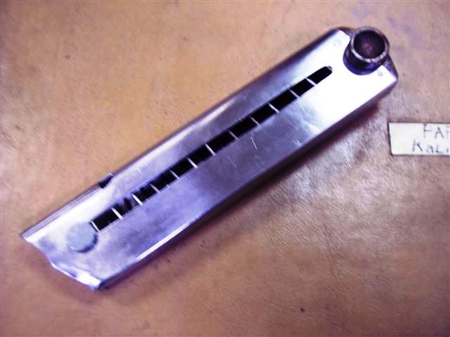

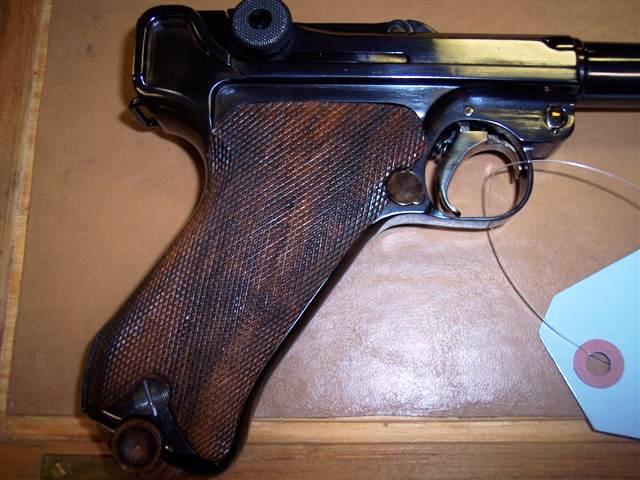

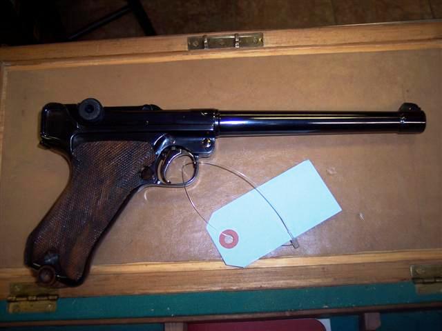

This is a 1921 DWM Luger that has been cleverly modified by a skilled gunsmith to shoot .45 ACP. I can assure you that it did not leave the DWM factory that way.
Some of you may remember that a couple of years ago, Cpt. Monty Mendenhall (I hope I spelled his name correctly), posted photos of a gun similar to this one. That particular conversion was much more crude than this one and I recommended that it NOT be test fired...
A major difference in this gun is that the trigger guard has been stretched and shaped to look like the original .45 test guns of 1906-1907.
The grip frame has the standard P.08 profile and not the profile of the original .45 Lugers or the replica guns made by Mike Krause.
The magazine well has been enlarged by metal removal to accept a .45 caliber sized magazine body.
The magazine appears to have been made by modifying a standard M1911 Colt magazine. All in all, this conversion's quality is much better than the ones previously seen that were not made by Martz... however, because of the amount of metal that had to be removed from the frame and upper receiver in order to get a .45 ACP round to fit and function, I am unsure about the strength of the conversion, and can't say I would recommend test firing this gun in your hand...at least until it had been test fired in a ransom type rest and then examined for potential damage.
I would absolutely NOT recommend the firing of HOT loads in this gun.
I'll bet it would be fun to put a couple boxes through this one!
Thanks to Petesguns for sharing the photos...
I don't know what you paid for this gun, but it is pretty unique even if it is a modification of a standard frame Luger, and not an original. Outside of the Martz conversions, I haven't seen many that looked this good.

I see ware marks on the back of the frame, so it looks to have been fired a few times.
I would inspect the rear of the breachblock for damage both before and after firing a few rounds. Getting everything timed just right might be a challenge.
Have they done anything to the main recoil spring? You would have to remove the left grip to see?
Nice gun

Can you tell if it feeds/chambers a full-length 45 ACP round, or does the bullet have to be seated deeper than the 1.275" OAL recommended???

Looks like German always uses "K" to replace "C" (KaLiber). Most likely there is also a "C" in the language, replacing "K"?
Just kidding. The bolt to hold .45 must be interesting....

Interesting and beautiful. Pity we can't give credit to the talented maker.
Those wood grips are really attractive. I wish I could find a set like that.

This is a beautiful example of a skilled gunsmith gone beserk! It must have taken many hours of buffing, machining, grinding, welding, bluing, etc. to come up with this curiosity. Obviously one of a kind, obviously re-blued and to be valued only by what a buyer would want to pay for it, providing the amount meets the requirements of the seller.
