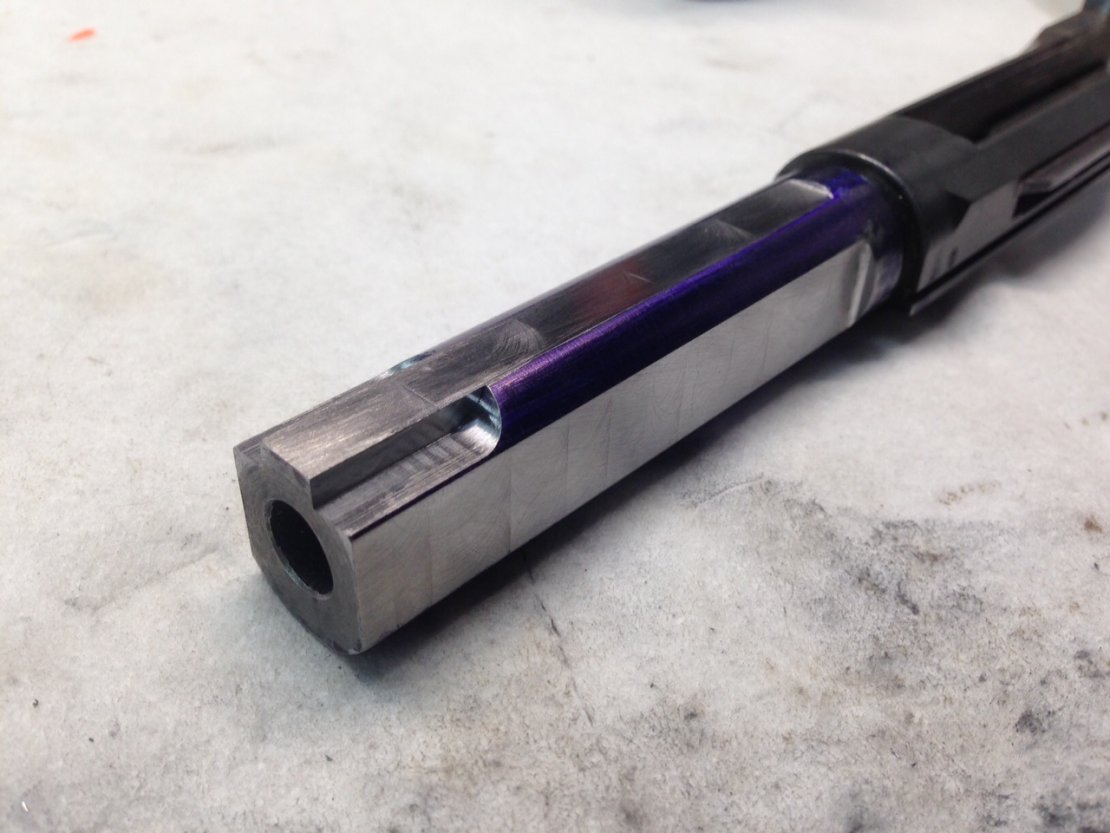

This is a work in progress, but here are pictures of how it looked a week or so back

Since the pic's Ed put up, we have the front sight dovetail cut, and tooling is on the way for the ramp and extractor cuts! Almost there! BTW, right now it's all Olle! ... I thought I was accurate on measurements and such? He makes me look like a cub scout in that regard! ......... A true perfectionist, all he needs is a good Bridgeport!... he'd machine the bottom of the world flat, cure that spinning thing???.... ..... til...lat'r....GT

....and here's a picture of the dovetail with a Luger sight in it. I believe the plan is to use a Mauser K98 sight, and this will look much better. Now I'm waiting for the tooling for the feed ramp and the extractor cut, and once I have that I should be able to wrap it up in an hour or two.

Unread 07-19-2015, 01:17 AM   #14
Would it hurt integrity to round the edges in front of the sight?
No, it wouldn't hurt at all, I was actually thinking about breaking the edges a bit but I'll leave it for the final finish work.
Doing a full roundover would be trickier, as it would require either precise machining or some careful work with a file. A slight bevel on the top front edge would be pretty easy to machine though.

Hi Ed! As this was/is a proto. we are mainly tying to establish what we can and can not do, both with economy of labor, and tools / materials.... Nothing is ruled out, but some secondary operations are as time consuming as the complete job all together? But, my plan is to have the front sight base relief cut radius, start slightly back from the muzzle... That way, I can chamfer the diameter, and recess / counter bore the full dia. of the muzzle, everything else remain the same? Stability for this cut may be an issue that will give us trouble.... We might /will find that out on number two! ..........First, we finish number one!...... best to all, til...lat'r...GT....
