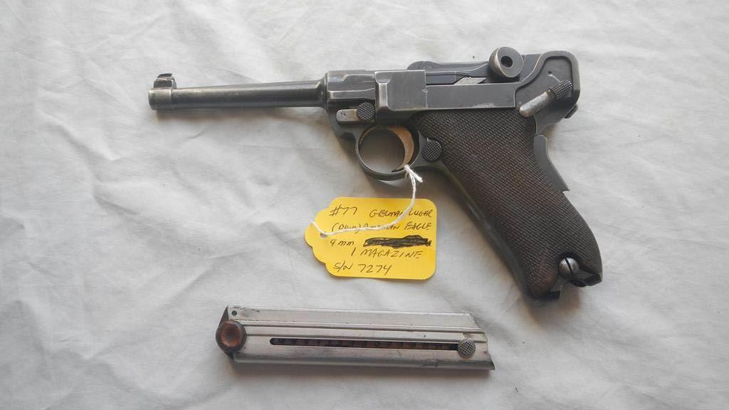

Hello, here are some pictures of my newly acquired 1900AE. I would like to know if anyone has an information about this pistol. These photos are from the auction sight from where I purchased it. I have not taken possession of it yet...what can I say, I live in California. I know the front sight is not original, but it appears it has been on the pistol for a long time. Also, it is missing the extractor.

If it's missing the extractor, Tom Heller should have that.
Tom might have a 1900 front sight too.

Thank you. I found a replacement extractor at the Sarco web site. It doesn't appear to need a spring or pin. It has pin that appears to go into a hole in the front of the toggle and a round protrusion that fits into the top of the bolt. I assume it is held in place by tension and probably was prone to breakage, hence the change to later design, pinned to the bolt with a spring under it at the rear. I'll research the toggle lock issue.

Not an issue, really, but a feature of the model's design. Since the toggle lock keeps the joint from rebounding when the action returns to battery, it makes it impossible to lift the knobs vertically until they have been drawn back enough to allow the latch on the right knob to get out from under the catch on the frame.
Hooking the index and middle finger over the knobs, as is instructed by one of the original early manuals, makes drawing them back pretty easy to do by giving a rearward bias to the forces you'd use.
Nice gun, made right after the Test Lugers...congrats! #7274 is in Dwight's Commercial Database, listed as AE with no other details.
Front sight does not look original...

JVH, I'm pleased to learn that Sarco still has some of my new M1900 extractors available. They usually purchase the unstrawed ones, so you will probably have to straw it to look right. i do also have the new m1900 front sight blades in stock @$25 each, as your luger appears to have an American made bead sight install. TH

Nice to see this one re-surface. The serial number was reported to me by Sam Costanzo years ago.
