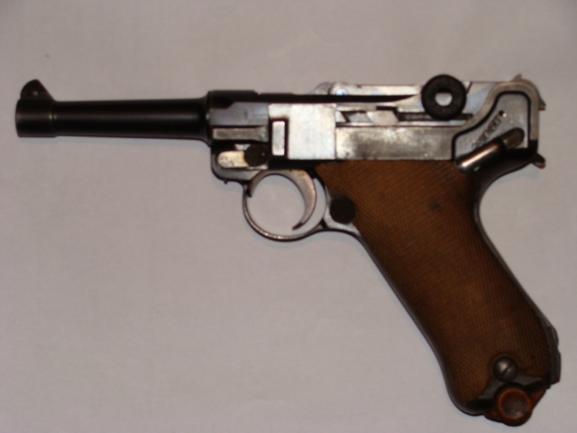

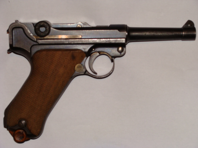

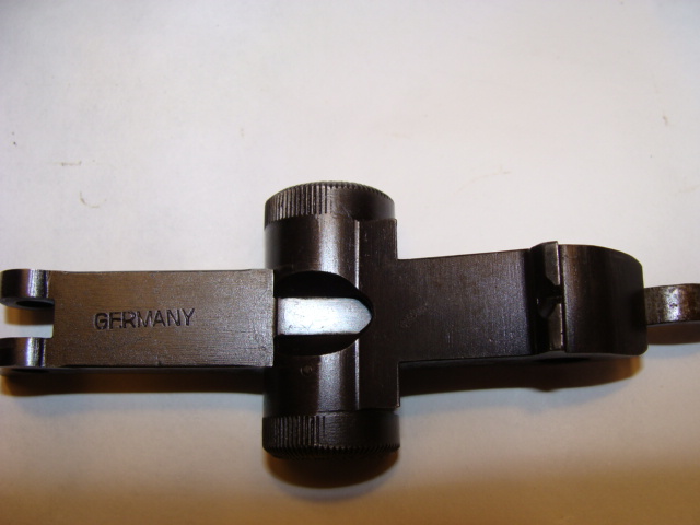

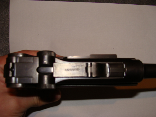

Thanks for the quick replies! Here are the pictures requested. From looking around a bit more I think it is most likely a 7.65mm. It has Germany stamped on it and it was made (I think) in the 1920's. Anything else needed do not hesitate to ask and bear with, I am new at this.
drevil8675 is offline   Reply With Quote
Unread 07-10-2008, 01:42 PM   #4
Posts: 15,976
Thanks: 2,074
Interesting, it is a "replacement" toggle that they stamped 'germany" on, I have not seen that often.
IMHO Condition suggests a $500-$600 gun if in 30 luger and $650-$700 if in 9mm.

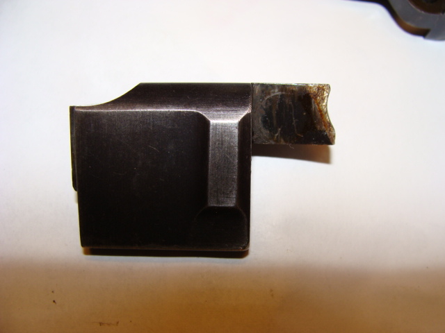

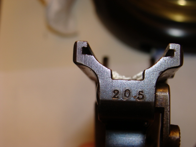

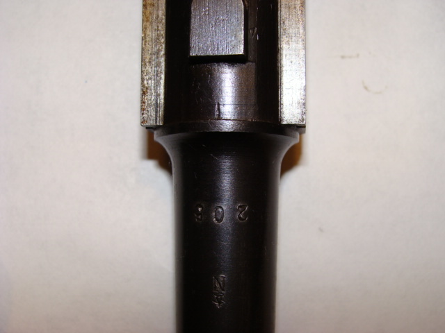

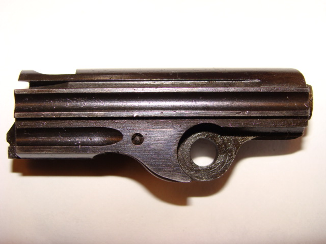

Posts: 6

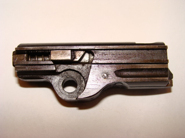

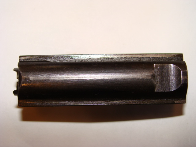

Ok, found the macro on the camera! here are some closeups of major parts, note only the two serials as mentioned before are found
The 5 at the end is a little hard to see, but it is a 5
Hope this helps! Need any other pictures just let me know.

A Commercial "Sneak"/"lunchbox" Commercial??? Cool gun!
Unread 07-10-2008, 07:12 PM   #9
Aaron
Banned
Location: Vista, CA
Posts: 1,008
Thanked 9 Times in 9 Posts
I think this gun has more value than just as a shooter. While the toggle is a replacement, it is a factory replacement, making this an original commercial pistol of what may be considered a heretofore unreported variation. Also, the 9mm caliber enhances its value. I would say this Luger is worth at least $800. And Tac, why would you hope to see a matching mag on a commercial Luger which properly was furnished with an un-numbered magazine?

Your Luger doesn't fit into any particular category. It is unusual, but you will get mixed reviews on whether it is a collectable or not. In all probability it is a "lunchbox special" assembled by a factory worker from various, mostly un-nmbered, parts. Kind of like Johnny Cash's song about building a Cadillac one piece at a time. Somehow it made its way into "official" channels and was reworked for commercial sales. The barrel is numbered to the frame but it is a replacement (note that it does not have a witness mark).
A "variation" is usually considered to be a piece that is the result of authorized production. It may consist of only a few pieces to many thousands, but it has unique features that set it apart from other production "variations". I suspect your Luger is a "one-of-one" produced by who knows? I think you could put a few rounds through it for the fun of it and won't be risking a national treasure.
Good luck and thanks for the photos. To repeat myself, it is a cool gun.

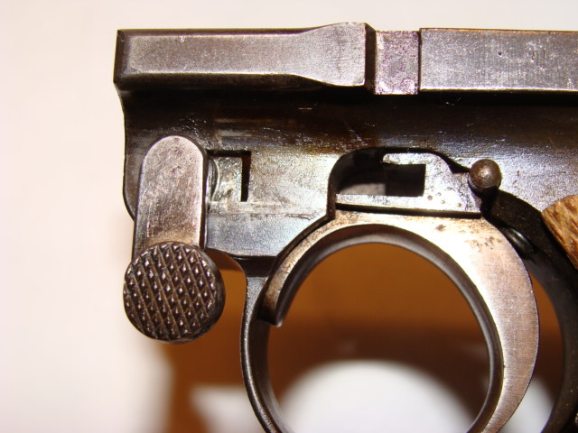

Ron...The barrel is numbered to the frame but it is a replacement (note that it does not have a witness mark).
I have never heard this before...That just because a barrel does not have a witness mark it is a replacement?
Perhaps you could enlighten this poor student and explain further?
I have a 1937 Krieghoff that has no witness mark and I know it is not a replacement barrel.
Took another look at the photo's...Seems it has a half of a witness mark. BUT, this brings up an interesting question. The witness marks were meant to line up..one was placed on the frame and one on the barrel.
It is obvious that a barrel could be installed without the help of a witness mark. In this pistols case it could be the original barrel, just no witness mark?
Thanks!
Unread 07-11-2008, 11:49 AM   #14
Jerry,
It is quite possible that it is an original barrel since a witness mark is not essential for barrel alignment. This would entail a long-winded discussion on the role of witness marks and the evolution of their use from earliest production to the late Mauser and Krieghoff builds.
In the case of this gun, it is of 1920s manufacture/assembly as evidenced by the vertical Crown/N. The low serial number doesn't fit in with anything produced after 1900, except for a few special contract runs...and this isn't one of them. So the gun has either been made up from a blank frame or renumbered. I believe the 1920 era guns still retained the witness mark, so this one should have one. It does appear that there might be "half a witness mark" but I lightened up the photo to check and there isn't one...it is just a photographic artifact. If it is a lunchbox gun as I surmise, it could well have been assembled without a witness mark.

Ron, Thank you! I know this is a complex discussion of a minute detail..But
"It does appear that there might be "half a witness mark" but I lightened up the photo to check and there isn't one...it is just a photographic artifact."
There is clearly an indentation on the reciever...Half a witness mark. Nothing on the barrel I agree.
