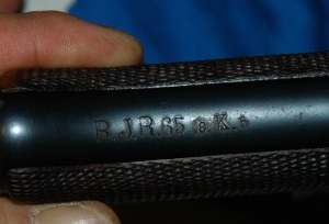

Default DWM unit mark: R.J.R 65 8 k 5
james here is Pic. R.J.R 65 8 k 5
thank you
sam 2111

Unread 09-04-2008, 10:41 PM   #8
supersamn
Join Date: Feb 2008
Location: CA.
Posts: 30
James,
look closer!!! it was 2 over 8 .... R.J.R. 65 2(8). K. 5 ???????
