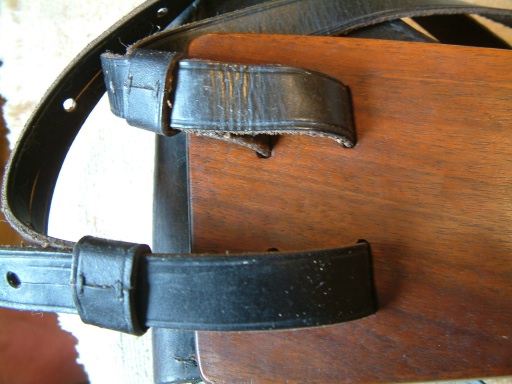

Now the question I have is with the stock/holster harness. Now as far as I undertsand, these were "used" with the holster attached to the stock..I can undertsand that, but for some reason I thinK that the two straps that run into and out of the stock are well, "threaded" wrong, knowing what I do about leather and how it will "wear" over the years.
With the stock positioned with the attching iron down, the straps come out the back side "between the holster and the stock" from the bottom holes.
Now never really being able to closely examine an original piece, it looks to me that you are begging for strap breakage, so the question is...Is this piece properly strapped up or do I unscrew the harness and "rethread" the straps??

Jp, With the stock held in you lap...Holster away..stock in between. Stock iron down. Straps around the back of your neck. Take the right strap, insert it into the top right slot. Stretch out 6 inches or so..insert this end into the right hand top side of the stock block that is attached to the holster. Push the end down into the slot. When it comes out the bottom, pull it thru and insert the end of the strap into the inside bottom slot and this will protrude towards you. Grasp this end and pull it towards you. You will have threaded the strap properly. The left strap is of course done the same way to the left set of 2 slots.
The ends of the straps will come up and lay flat onto itself. These are worn next to the body when the pistol is carried.
The stock block on the pistol with the straps properly affixed will simply disapear into the stock recess when you pull it all snug. Once you determine the proper way this is done..it will seem very simple.
Take a look at the last photo in the 1st photo set. You can see the strap properly threaded.

Jerry,
I was looking for a photo and the one you pointed to of Eric's setup is a pretty good example. Here it is without needing a link:

First, thank you for the answer but methinks I have a porblem on this end. the straps that I have is simply one piece. one strap runs through the stock and holster so I think I could of been sold a bill of goods here. No matter how I run the strapping I cannot get it to lay flat against the holster
Now I have a harness sewing machine that I use for my "real job" when I need to do leather work so making new sraps is not a problem if that is what is needed..... So do these have two straps or one strap that serpentines its was around??
I am sorry if this is a "stupid" question but if you don't know...you don't know and I don't know, never having seen one that up close and personal..

JPH, Your strap should not be a continuous loop. It has NO sewing in it.
It souuld be 72 inches long. Approx, 3/4 inches wide, wide enough to fit the slots in your stock and 1/10th to 1/25th thick. It will have decorative edging and I could go on but I am in a hurry!
Straps this long are hard to come by. Most repro straps are way too thick.
They have steel or brass adjustment studs & two leather keepers.
Hope this helps!
