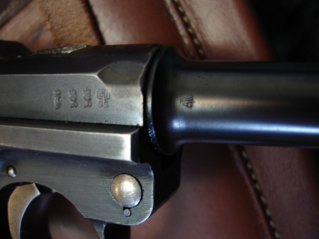

I recently bought a DWM 1918/1920 military luger. It has been reworked, as there is a small s/42 on the toggle, running the length of the toggle. It appears elsewhere (I am at work, and forgot to bring my notes, and somehow I am not sure looking at a luger while at my desk, will help my job!)
What I can not fahtom is just forward of the dates, on top of the frame behind the barrel, is a smll cut out, sort of coin slotted, and appears well done. At Joe Salters web site, there is a police rework luger with the same cut out, (#9230). This leads me to believe that the cut out was done by the German government, but why?

Right you are about the small notch, you are probably refering to the cut for the rear sight of an artillery Luger.

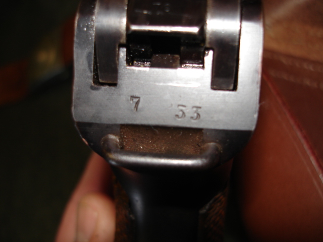

If the S/42 is small, it indicates an armorer's replacement part. S/42 is a Mauser code. The numbers near the lanyard loop are "rack" numbers, if it's a police pistol. A provisional unit mark, if it's a military issue pistol.

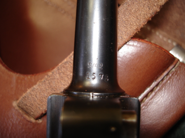

Your Luger would be a WWII military rework done sometime after 1936, when the S/42 Mauser code was adopted. Many Artillery Lugers either had the barrel shortened or, as in your case, replaced.
DWM only put the sight cut on the Artillery model. From 1916 through 1918 all Erfurt Lugers , including 4", were made with the Artillery sight cut.
The 9.33 (provisional unit mark ?) on the back could have been placed there anytime during or after WWI. Probably during the Weimar era 1919 to mid 1920s, and as late as early 1937. It could indicate 9th Regiment weapon #33. Without a clear photo, I can't be certain.

http://forum.lugerforum.com/lfupload/dsc02270.jpg
http://forum.lugerforum.com/lfupload/dsc02266.jpg
Here are a few of the photos I have finally loaded of my 1918/1920, possibly first an artillary luger, then a 4" barrelled luger, with s/42 marked (in small letters, "upside down" on the toggle, and on the barrel.
Is this mark, on the barrel, of an eagle with a capital letter "A"? It is not clear as the mark is incomplet on the barrel. Is this the KU mark?

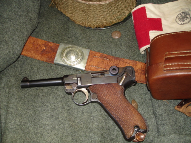

the other photo is a few more repro toys of mine.

http://forum.lugerforum.com/lfupload/dsc02263.jpg
http://forum.lugerforum.com/lfupload/dsc02267_copy3.jpg
This shows the under barrel markings, and the odd numbers onthe rear. Boy, I would be happy to have them be police numbers!
