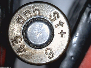

This is a picture of a 9mm Luger cartridge headstamp taken with a digital microscope. The letters are "dnh"; "St+"; "43"; and "6". I assume the "43" is for the year 1943. Does anyone know what these other codes represent?
Thank you.

You are correct that 43 is the date. The "dnh" is the maker code and the others are the lot number and the case metal code. You may find this interesting:

St+ is for steel case.

dnh---Rheinisch-Westfalische Spengstoff AG, Durlac bei Karlsruhe. SAA
The SAA means they produced small arms ammunition and components. Bill.

Produced by RWS, case made of (laquered) steel (St) of the improved design (+), lot number 6 in 1943.
What's the color of the bullet itself?
You can find them in 'sintered iron' (SE) shape, dull grey with a black band around the case rim on the bullet, or in 'mit Eisenkern' (mE) iron core versions with completely blackened bullet.

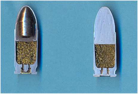

Hi Ron,
That's the SE 'Sintereisen' version, allright.
'mit Eisenkern' on the right, 'Sintereisen' on the left.

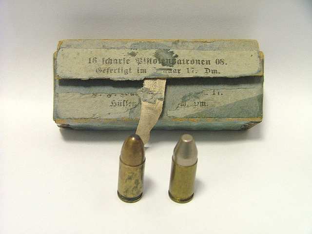

The correct bullets for a 1912 Erfurt would be of the truncated cone design, nickle plated, brass case.
Shown is a 1917 package and two 1917 variations of the P08 9mm round (the switch from truncated cone to ogival was made around 1917). Both rounds shown date from 1917.
Note the canvas pull strap on the box, this is a feature of the earlier packages. In WW2 they switched to cardboard boxes with different lid. The older boxes also have metal reinforcements on the sides.

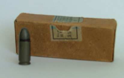

A bit of a lousy photo, this, but it shows the SE bullet with the corresponding box.

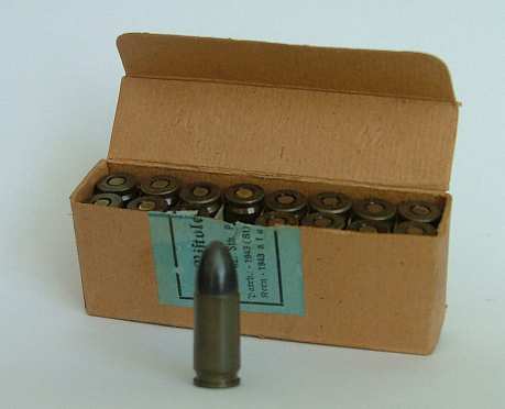

This is a bit better, general lacquered steel case WW2 ammunition with box, with iron core (mE) bullet.
