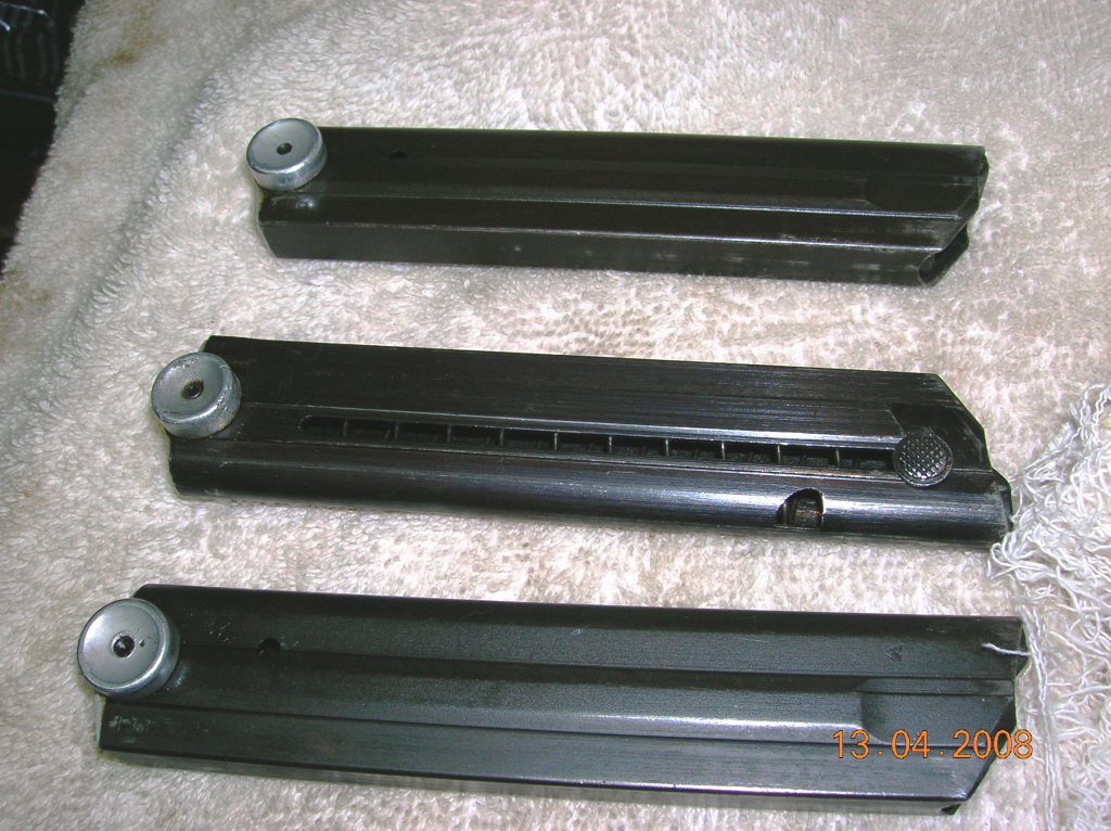

Another data: the 3 magazines are marked "fxo", a small eagle and 37 below.

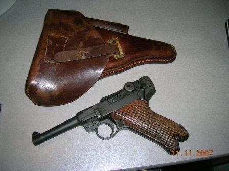

Unread 11-11-2007, 09:11 PM   #6
sepolvora
Join Date: Nov 2007
Location: Costa Rica
Posts: 19
Default here are the pictures (I hope)
http://furum.lugerforum.com/lfupload/lugerholster.jpg
http://furum.lugerforum.com/lfupload/lugertop.jpg
http://furum.lugerforum.com/lfupload/lugermarks.jpg
let's see if you can see them
sepolvora is offline   Reply With Quote
Unread 11-11-2007, 10:36 PM   #7
Juan,

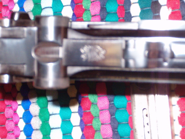

You need to edit your links to say "forum.lugerforum.com" instead of "furum.lugerforum.com", then we will be able to click on the link sand see the photos. I made the change and could see them, but I can't edit your post for you.
The photo of the top of the Luger is out of focus so I can't tell if it is a blurry image of the DWM logo or the forward toggle link from a model 1908 Bulgarian Luger. The holster looks like it might be a 1943 Portuguese contract holster.
Unread 11-12-2007, 12:12 AM   #8

Sorry but the picture you saw it's not the one I loaded, I believe you're right about the DWM logo
I'll reload mine with another filename
Confused Sepolvora

this is the new file:
Sorry for the inconveniences
Thanks for your comprehension
http://forum.lugerforum.com/lfupload/lugertopv2.jpg

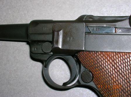

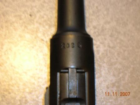

"2036" on the top of the chamber is quite odd.
I only seem to see "M" but not "MP"...

You're absolutely right. The P is not visible. It was in the original resolution, but for the piscure to be admitted Ihad to lower the resolution. Th P is very close to the M.

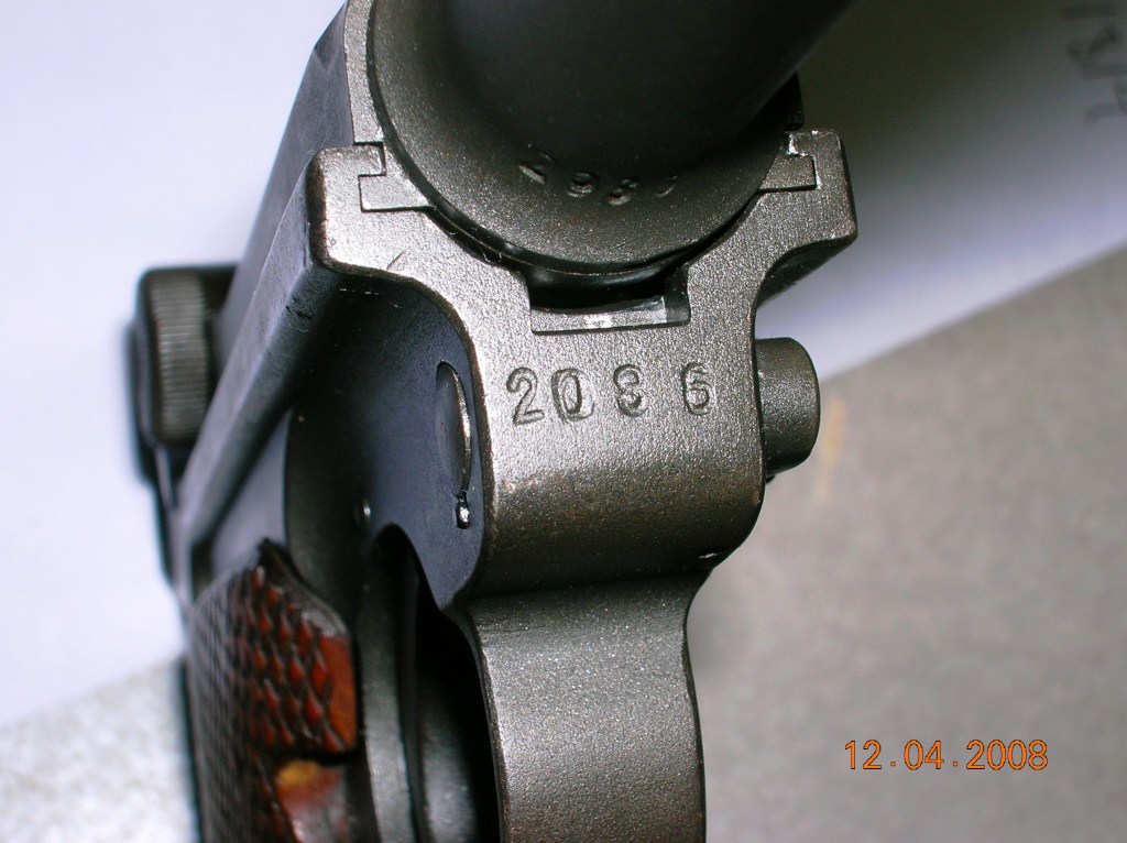

and you're right also on the top number (it's really 8036). To me it looks as it was striken with a punch from a different set every number. It looks odd, just not to use the word "sloppy job".

What is the serial number on the front of the frame of your gun, just above the trigger guard ?

but the serial # is 8036, stamped all over the gun, wholy or just the two last digits.

BtW; can you tell me something about the fxo 37 magazines?

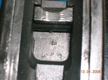

I would be interested in a picture of the left frame without the grip on.
Is there writing in the safety lever area, a picture here would be nice also.
Just trying to understand what we are looking at here, as you said earlier your gun has gone through some changes and it is fun for us to analyze those changes. Its all part of learning more about our collections, please be patient with us.

Reason I asked for the gun's SN was to determine what your gun may have started its life as. The "8026" on the chamber may have been the odd placment of a Portuguese property number placement.
Is "8026" also stamped on the front of the frame, just above the trigger guard ?
Can you tell if you see any evidence that an original RP/Anchor crest marking was removed from the top of the chamber.
The fxo37 magazines are from WWII Mauser Lugers. Mauser made the Portuguese M943 model contract for the Portuguese as well in 1943.

The placement of the 2-digit SN on the side of the trigger plate and left side of the TD lever are not consistent with the RP Portuguese Lugers and their MP stampings...I believe the RP Lugers have the commercial, hidden placement of 2-digit SN's.
So your Luger is some mystery...

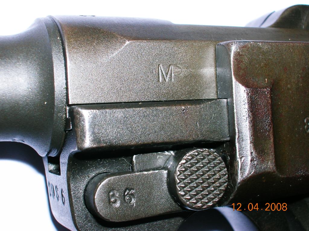

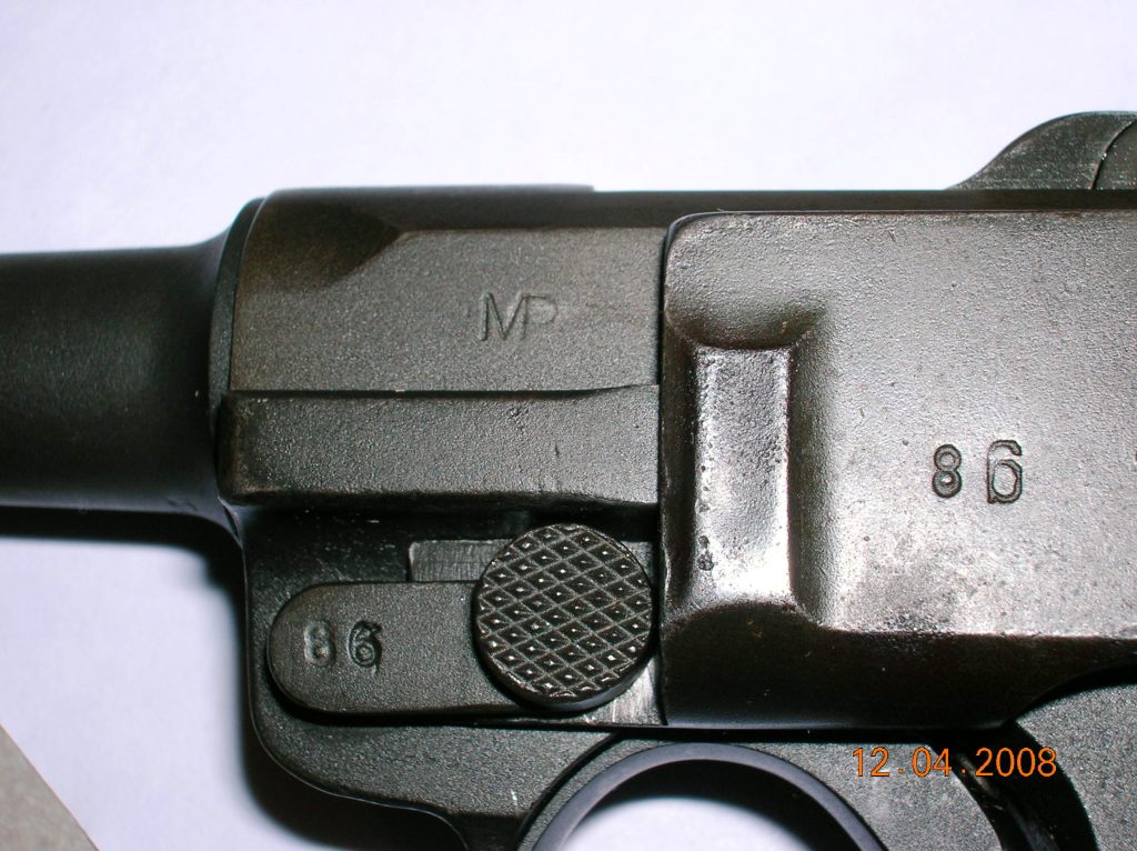

Unread 04-12-2008, 11:30 PM   #18
sepolvora
Join Date: Nov 2007
Posts: 19
many years later...
Sepolvora showed up again, this time with new pictures...
Sorry Again. I hope this time the pictures will be a bit better.
Saludos
Unread 04-13-2008, 08:41 PM   #19
LugerVern
LugerVern's Avatar
Join Date: Apr 2005
Location: Virginia
Posts: 563
Thanked 34 Times in 27 Posts
Hi Juan
Nice to hear from you again.
The â??MPâ? inspector stamp looks authentic to me.
In 1912 the Portuguese Navy ordered 300 Lugers from DWM, these are commonly called RP Crown lugers as they had the Republic of Portugal crest on the receiver. The crest has been removed from your gun. These guns had a serial range of 350 to 650, at about SN 500 the MP stamp stops being used so your guns upper receiver original SN was between 350 and 500. we can determine the original serial number of your gun by looking at the bottom of the upper receiver near the lug, there should be two numbers on the lug and another one off the lug.
The guns lower frame is interesting the RP lugers were originally grip safety models and your gun is not. So it has been converted â??the grip safety removed and a post 1916 relieved sear bar installed. I believe the frame is original to the gun as the worker marks are consistent with the RPâ??s that I own and have documented.
The guns serial number has been modified, the original three digits have been over stamped and a 2 added to the beginning of the number.
I would like to know what the original serial number of the gun was, there are not many Portuguese Navyâ??s and even though yours has been modified it looks to be authentic â??why it has been changed and how many more suffered the same fate may never be know.
By the way, can you describe the magazine/s that came with your gun?
Any markings on the bottom?
Looking forward to your reply!
Vern
Unread 04-14-2008, 12:32 AM   #20
sepolvora
Join Date: Nov 2007
Posts: 19
here are the pictures (second try)
