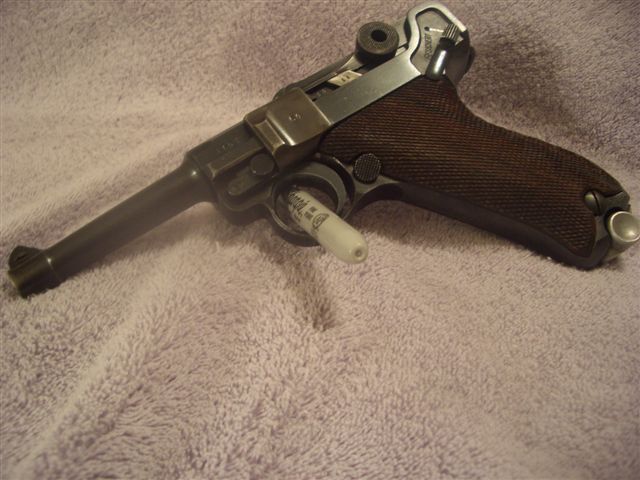

Quick question guys, I have a 1937 mauser serial # 860 with what looks to be a lower case cursive L, my questions are, would un-numbered grips be correct, and is this late enough in the year to be all blued with no straw?

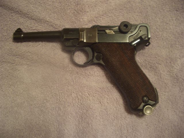

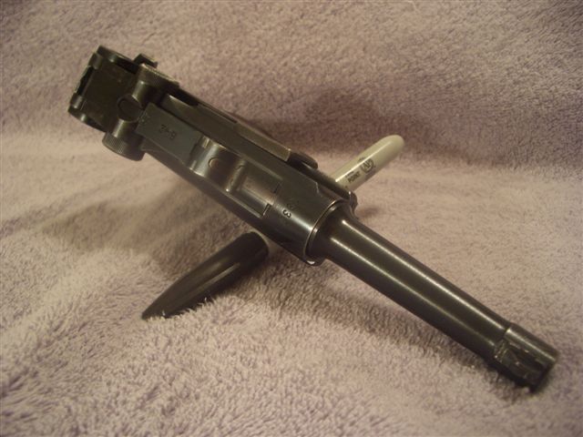

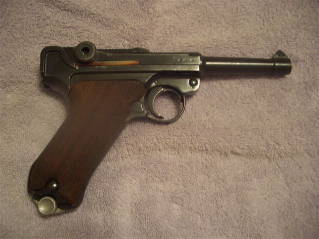

Default Photos of 1937 S/42
First 6 Photos of the pistol in question:
Unread 03-05-2008, 04:42 PM   #8
3 more photos from mauser-
A nice looking '37 S/42 !!!
The suffix letter looks like a "B" to me!

Thank you John, for your kind words, and for posting the pictures for a computer-challenged person such as myself.
So, I believe you are correct about the b, and according to Jan's information, that would make it one of the last 1937's?

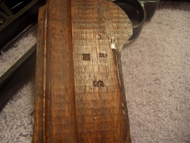

Do you guys think the grips are original, even though they are not numbered?

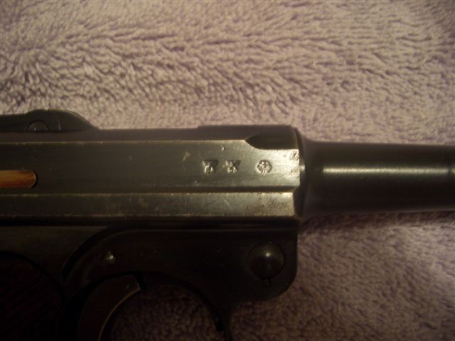

1937 S/42, sn 860b?, SE63 SE63 MTP, parts blue.

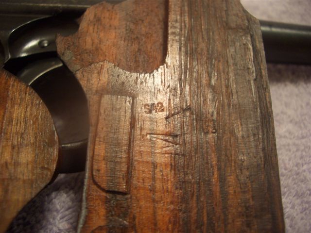

Thanks for the excellent photographs. The grips with a SE63 and S/42 acceptance stamps appear correct. With SE63 the small parts should be blued.

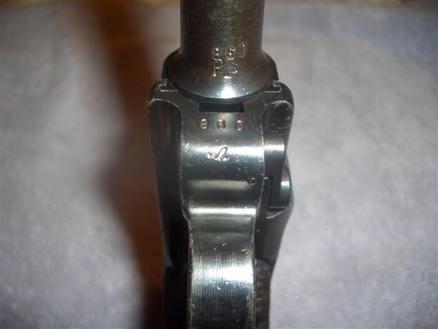

This may be the last 1937 S/42 reported. A few questions.
What are all the letters and numbers on the bottom of the barrel? A "P3" seems to show up in your photograph where the barrel gauge should be: 8,82-8,85.
What is the number on the left receiver?
What are the rest of the parts numbers?
Thanks

The number on the left receiver is 860. All of the parts, extractor, firing pin, toggle, trigger,sideplate, takedown lever etc. are marked 60, even the toggle pin is marked 60. The one exception, that was the topic of a previous post by me is the hold open which is unfortunately is labeled 64. I do not know how to check the ejector, but I hope it is 60.
The takedown lever does almost look over-stamped on the 6, but aside from that all the numbers, and letters are very crisp, along with all of the edges, which is why I bought it.

Unread 03-06-2008, 01:36 PM   #12
Jan, Here is the best magnification I could get (from the photos posted already) of the numbers under the barrel. The first letter is definitely a "P" but the second one could be a "5" or a "3" or even an "8" or "9"... They don't look the same age as the bore diameter (8.81) marking to me... but that could also just be the photo...
Perhaps 'mauser' could rephotograph this area in better light and sharper focus...
