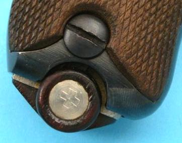

Looks like this one is SN 5249i with an asking price of $ 12,000 USD :
http://www.cabelas.com/cabelas/en/co...swissluger.jsp
Why a 2-line inscription on a 7,65 mm gun...???...
Is the left "arm" of the Swiss cross a bit too long...???...

I think the reason the left arm of the cross is longer on this specimen is that this was done to indicate that the grips were designed to be used by a left handed shooter. These left handed A&F models are the rarest of the rare.
Mauser720 - Ron
