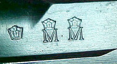

What do you guys think...???...

Absolutely bogus.

Why do you say that, Tom, is it because the Crown and the M are touching?
Unread 08-12-2007, 05:59 PM   #4
Thanks: 1,120
Look at the "shadow line" above and to the left of the crown. The mark was struck at an angle such that the left side of the impression is deeper than the right. In so doing, the fabricator revealed the flaw in a repro stamp. On a real stamp, the marking surface flows smoothly from the taper of the shank. On a repro stamp, there is a ridge around the characters of the stamp, so if you stamp it too deep or cockeyed the ridge shows up. I am sure this flaw will soon be fixed, but it is too late for this tool.

Thanks for the reply Ron. The fact that the Crown sits on the M doesn't bother you a bit also?

No, that part is OK...in fact, it should sit on the M.

I see a dye impression at the upper left hand corner of the "M". Is this a flag that this tool is "repro" stamped as well?

Knowing the seller, I do not believe that he would intentionally sell a repo as original.

Herb, That appears to be part of the tooling marks evident on the face to me rather than a die impression. That and the Anchor M looks just as it should on a Weimar tool. This is a very nice authentic tool in my opinion...Jerry Burney

The die impression of a repro marking will closely follow the contours of the mark. The blemish on this tool is just incidental. A repro impression is much more obvious.

The crown M stamp looks to be slightly double struck not a fake die stamp with border ridge. I hope you guys are wrong because Im the sucker who bought it.
