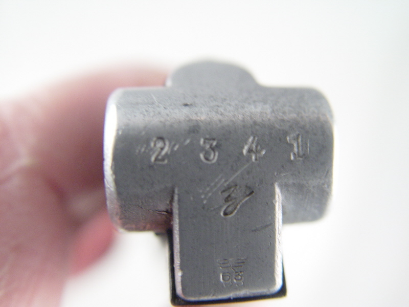

I've received some additional pictures and the pistol looks very nice. No evience of reblue. Since a considerable amount of the value of the pistol is tied up in the magazine I'd like to get opinions on it as well. Two areas on this mag caught my eye. The area around the serial number seems "cleaner" than the rest of the mag bottom. Also E63 seems to have two marks under it.
Any thoughts on this? (click on pic for larger image)
Any input appreciated. Thanks!

it is best to post pictures directly here on the forum, that way folks don't have to go to a strange site (no offense).
Take a picture from the side, but I don't like how it looks either, nor the 'ghost" of the eagle 63 down below?

Ok didnt know I could attach a picture directly. Same shot but should be bigger. There is patina around the 341 but seems to be absent around the 2. Could be the flash but there does seem to be a "ghost" 63 under the eagle. I'll have to request some additional pictures from different angles on Monday.
Here goes:

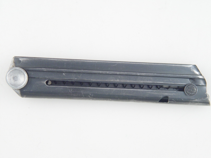

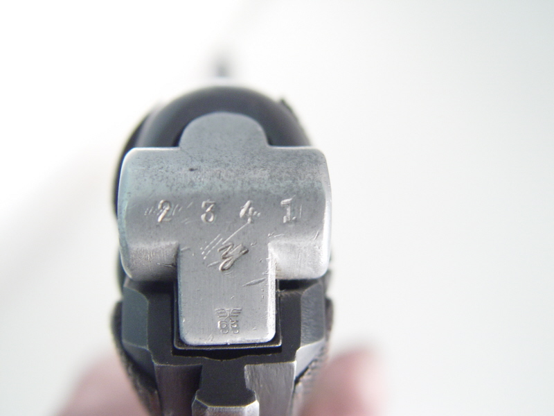

Ok exchanged emails with seller and it looks like there is a small 6 and 3 stamped directly under the E63.
Seller thinks this might possibly be a stamp rebound. Is that possible? Common or uncommon to run across? How would this effect the value?
I've attached some additional pictures. Picture of bottom but slightly angled and darker.

And from sides

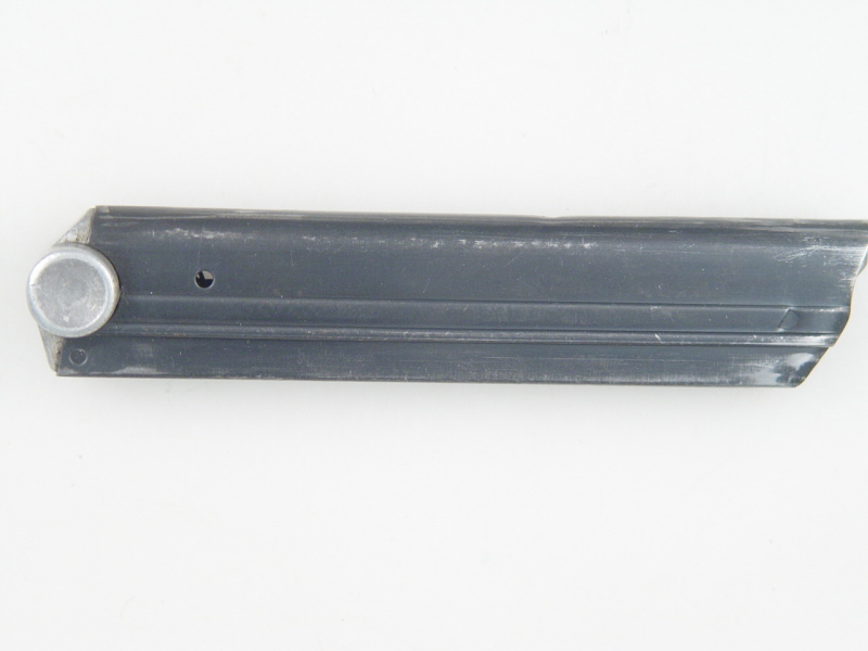

From other side

Greg, how much value are they increasing it for being 'all matching"?
I have seen the double tap / rebound before, i prefer not to have magazines like it (I have had several and might still)
You realize that a non matching magazine on a luger is the norm?? That it is much more common to find a luger without a matching magazine than with one.

Ed,
List is $2850. It's a 97% condition so if I start with a rough baseline of $2000 for excellent condition for the gun alone you figure they're asking another roughly $800 for the match mag (give or take 50 or so either way). About a 40% premium.
I'm assuming the rebound assessment is a tough call. That ghost stamp is pretty hard to read. Sometimes it looks like a large 63 and other times it looks like an 8 under the 6 which would change the whole dynamic altogether.

I would make the call that the mag is correct. I have seen mags with the base ground and renumbered and to get all traces of the old number out requires a pretty deep grind, which this one does not appear to have. It does look a tad "flat" where the number is, but the number fonts appear identical (to me) to the numbers on the pistol. The suffix and E/63 look very correct and die bonce is common on almost any hand marking, especially small marks like this. I have, in the past, seen the bases be a bit flatter where the numbers are. I am thinking that may be a manufacturing process. But I don't get around as much Third Reich stuff either.

Thatâ??s a very nice gun youâ??re looking at, please compare to others and look closely at the overall finish, I donâ??t think their too far off on price. There is minimum holster ware for example as compared to others you encounter.
If the double strike on the mag really bothers you, you should pass, itâ??s your money, get what you want and feel good about it.

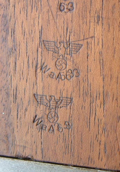

That mag looked right as rain to my (less than experts) eyes... Here's a perfect G.33/40 with cartouche bounce...
