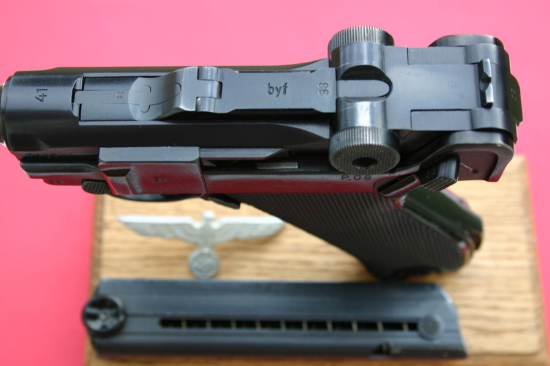

Hello Gang,
Anyone have tips on how to take good gun photos...i get about 1 per 20 that come out rite...what do you think of this pic??

Steven, welcome to the forum... your number of bad to good is "normal". I take about 10 for every 1 that I like, although another 10 don't turn out as well either .
Is this pistol for sale (you have it in the for sale section)
See this http://forum.lugerforum.com/forumdis...s=&forumid=133
White is not the best background to use, as the appature opens too much. Also, I find that a flat background is best, at least for me.

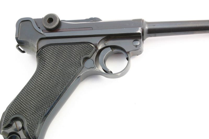

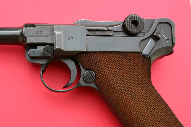

After many attempts and plenty of trial and error, I think I'm starting to get the hang of luger photography. I took the following photos yesterday using one of those white nylon photo tents you can buy on Ebay. Similar to Ebay item #170158314972. I took the tent outside in full sunlight which allowed for a faster shutter speed (1/250) to steady my shaky hands. The background is just paper (white or red) sitting on a small plastic stool. The camera is a Canon EOS with a 18-55mm zoom set on "P" setting.
Picture one is with a white background with the sun opposite the camera. Not bad but the colors are kind of washed out. Pictures 2&3 are with the red background paper with the sun hitting the right side of the tent.
It still took several tries to get thing right.

wow......incredible vivid photos tharpo....nice looking byf 41 also.

Great pictures and excellent tips. While I haven't gotten off of my butt yet to post pictures, I have studied other pictures to see what looked best. I would like to add that a medium grey back ground on WW2 Lugers looks great, but a pink such as Tharpo shows in his pictures brings out the browns on holsters and the strawing and wood grips on WW1 Lugers better while not disturbing the bluing. Indirect lighting from different directions or outdoors is a must to reduce shadows.
Big Norm

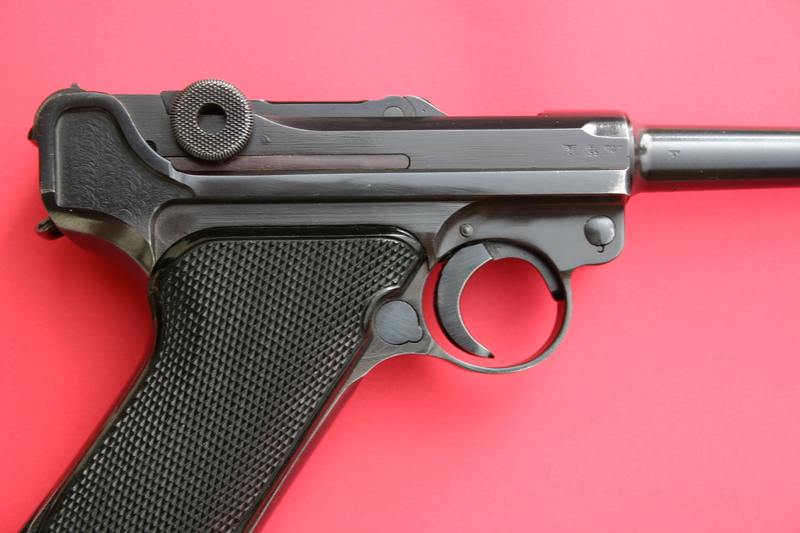

Indirect and/or diffused light really helps in cutting down reflections and shadows. Using natural sunlight is also beneficial in eliminating white balance
issues you can get from artificial lighting.
Here is a photo of a 1940-42 placed on red piece of paper taken outside on a cloudy day.
Tom
