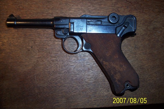

Hi, I'm a new member here & wanted to find out a little more about my Luger. It is a DWM 1917 model with matched numbers except clip & extractor.
The forum is great. I've learned more about my gun this morning than I have since I bought it. Trying a pic here...

Harry,
Congrats on your Luger and welcome to the forum! I am still a newbie to Lugers but I've learned a lot from the friendly and knowledgeable gurus on here.
In order for you to obtain more information on your Luger it would be helpful with some closeup pictures of markings, finish and such. I assume it does not have a regimental marking on the front grip strap.

Balder, Thank you for the reply. I have found no markings on the front or rear grip strap. I am having a real problem getting decent pics with my camera, but will try a few more of the lousy ones I have taken.
This gun has I believe been reblued. It is a very accurate shooter. Clip is a WWII type with small eagle & faint letter C.

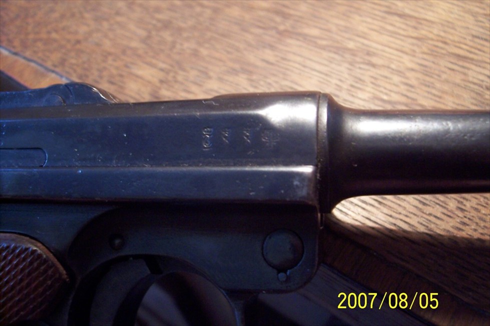

Pic of proof marks. Serial# is 215. No suffix.
Harry

Whoops, suffix is either a g or a q

Harry,
Welcome to the forum. It looks like you have a nice shooter. You are correct - it has been refinished. This is clear from the pitted areas that are blued over. Also on your Luger the trigger, take down lever, ejector, magazine release and safety lever should have a strawed finish (yellow/gold) not blued. The various springs and pins, like the toggle pin in the detail, should be fire blued (peacock blue). Same for the grip screws (one seems to be missing). Finally, on the front of the receiver, where the shape changes from a squared contour to a round contour matching the barrel, the edges are slightly rounded, not sharp. This indicates the gun has been buffed as part of a refinish. In the close up photo the barrel appears to be a different color, could it be a replacement?

Karl,
Thank you for the reply. The previous owner mentioned the buffing of which you speak. Also some treatment to the grips which left the mottled appearance, although they are unchipped.
The barrel he stated had never been off & I believe it. The machine marks aligns perfectly. One on barrel one on frame.

It'll never happen again. Old joke , but I guess a bit too parochial for open forums. Thanks again for your input. Very precise post. All points valid ,except the barrel, I think. Picture does make it look like a replacement though. I believe it's more my photography skills than the actual match however.

Walker, if your camera has a macro function (usually a flower), you could use that one. Turn off the flash and place the Luger in a well enlightened area (perhaps close to a window). You could use a tripod, books or something like that to stabilize the camera.
Looks like the Luger is a quite common 1917 military, but you could look for signs of military rework (grip markings/receiver) and perhaps Spandau proofs (rear toggle, ejector and other bits and pieces).

These all appear to have the last 2 digits so far. The grip that is loose has
a couple of faint marks inside. I see none on the atached grip. I've never taken the gun apart, just swabbed out the barrel & through the reciever
& clip area. From the outside all marks & numbers look like DWM factory except the extractor.

Point taken as to calling my magazine a clip. The extractor has a number. It is 80. It also has the word "geladen" on the side of the extractor. You have to open the toggle & lift extractor to see it. It was replaced by a gunsmith for the previous owner.
